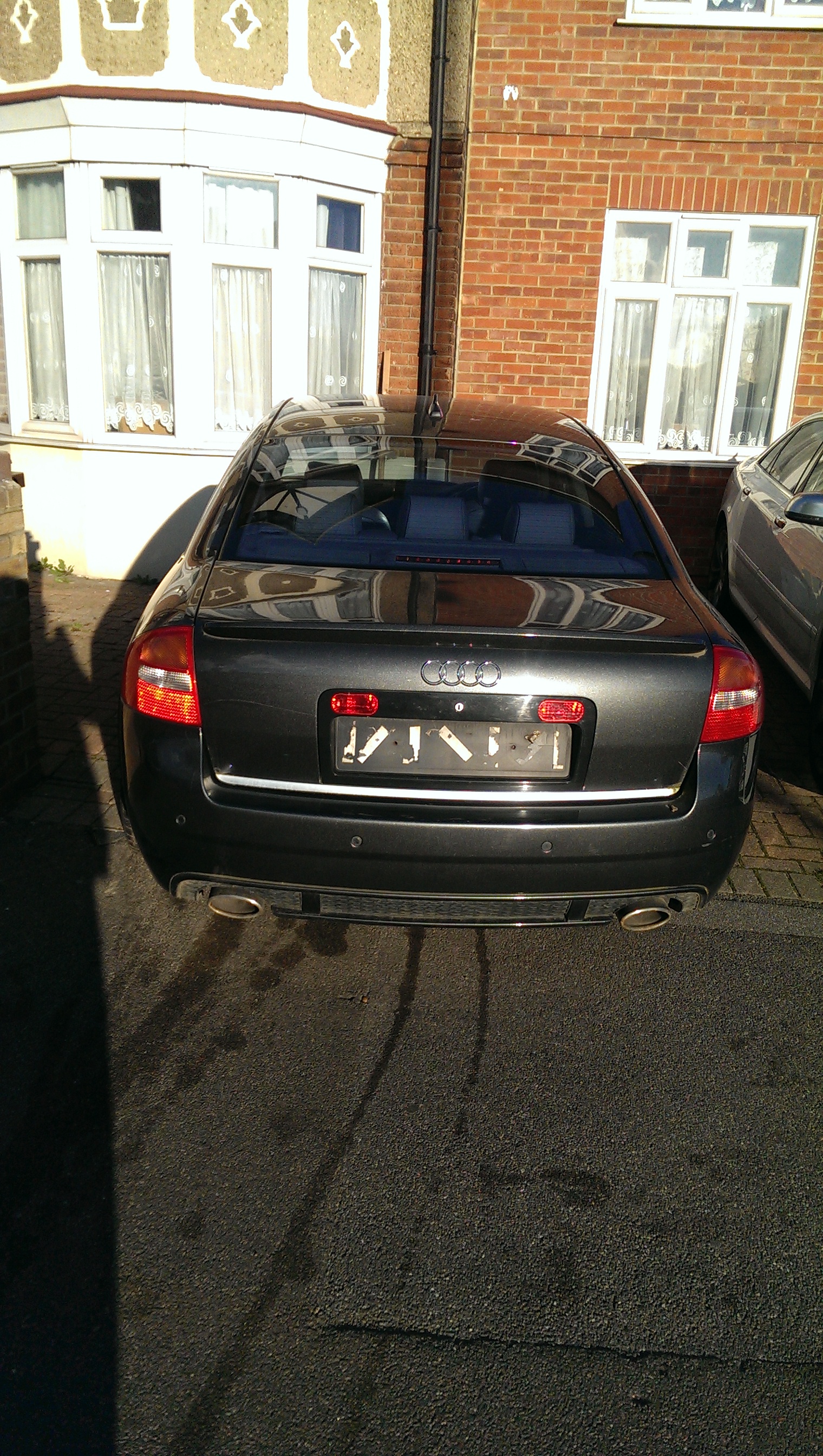

Yeah that's the plan eventually, once i get it back on the road with its MOT passed, etc, I just want to get the cooler fixed and the fluids changed for now.
I've got a few pictures of the damage now as well as of the car (you can still see the fluid on the drive from the leak).

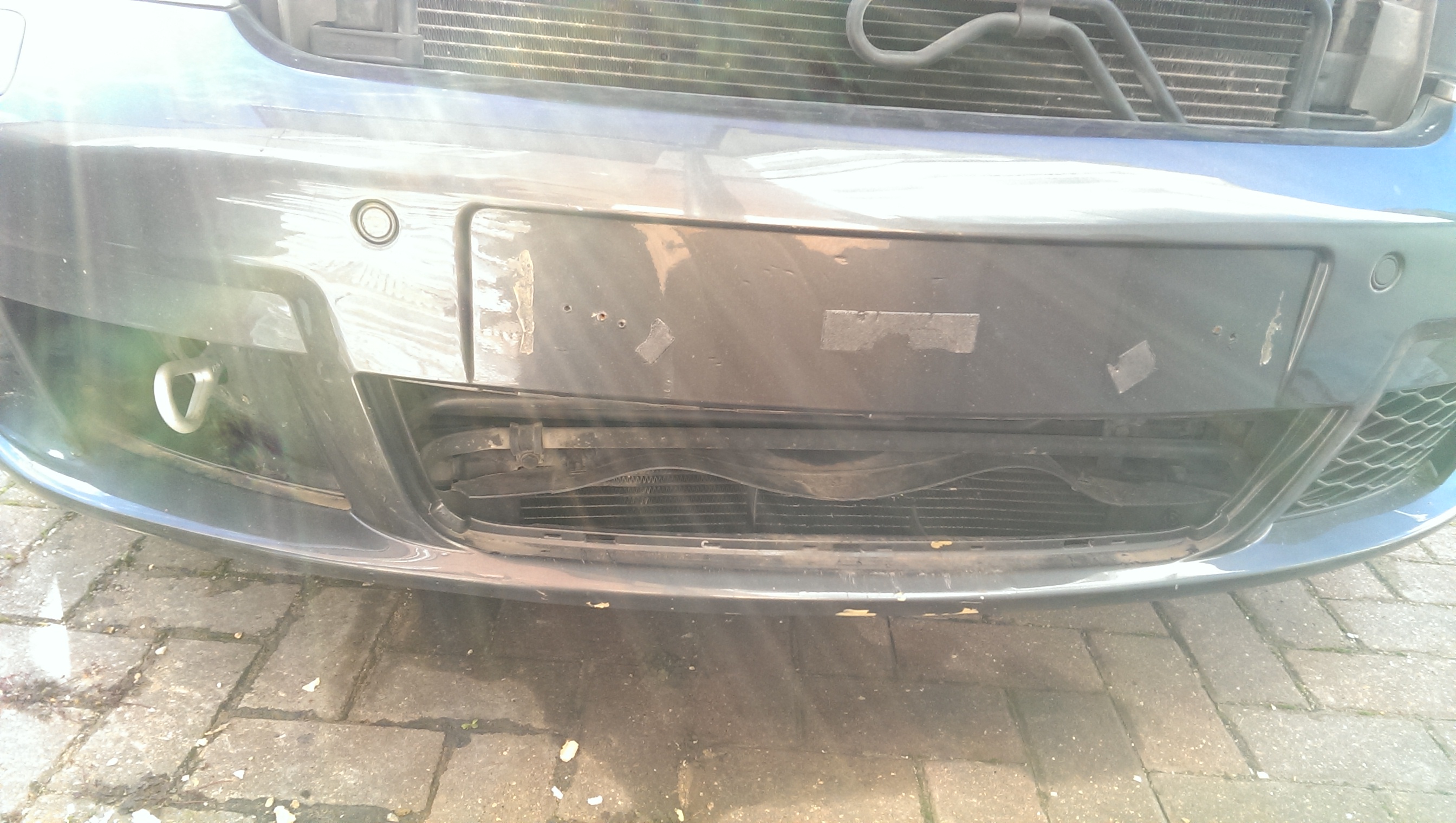

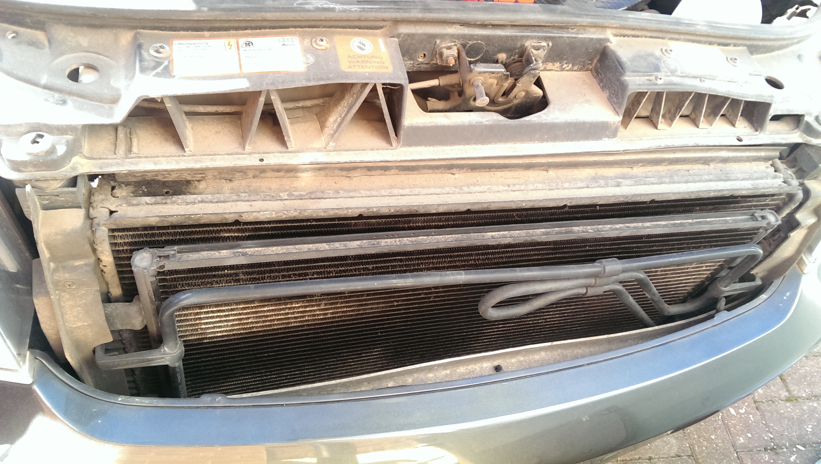

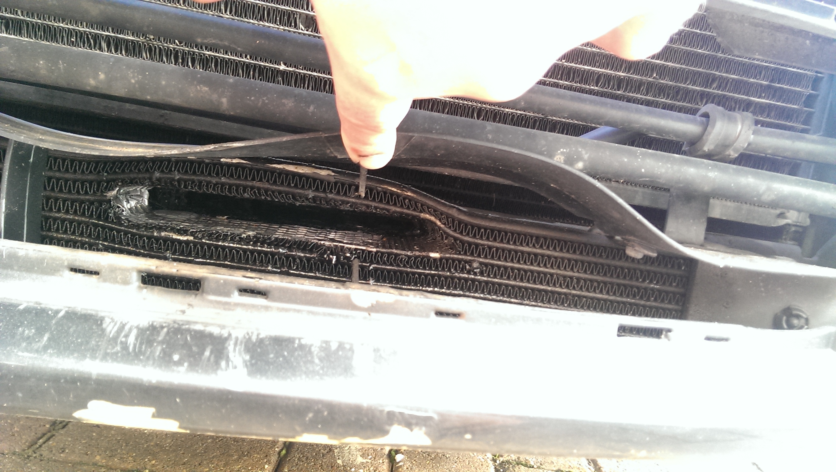

Post by PoP-PoP-BANG » Sun Oct 12, 2014 5:11 pm
Thanks SuperSi.
The paint is in really good condition considering it's not had a wash in a few years, you can really see the flakes in the paint work.
Based on the picture, do you guys think it is the oil cooler thats damaged? Looks like something left its stamp on it.
