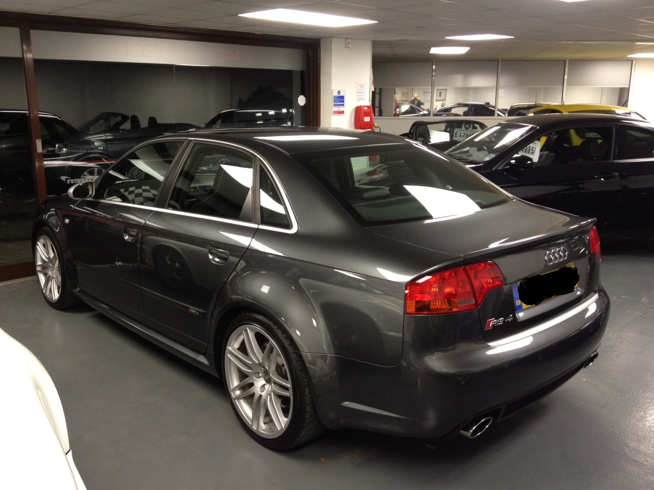

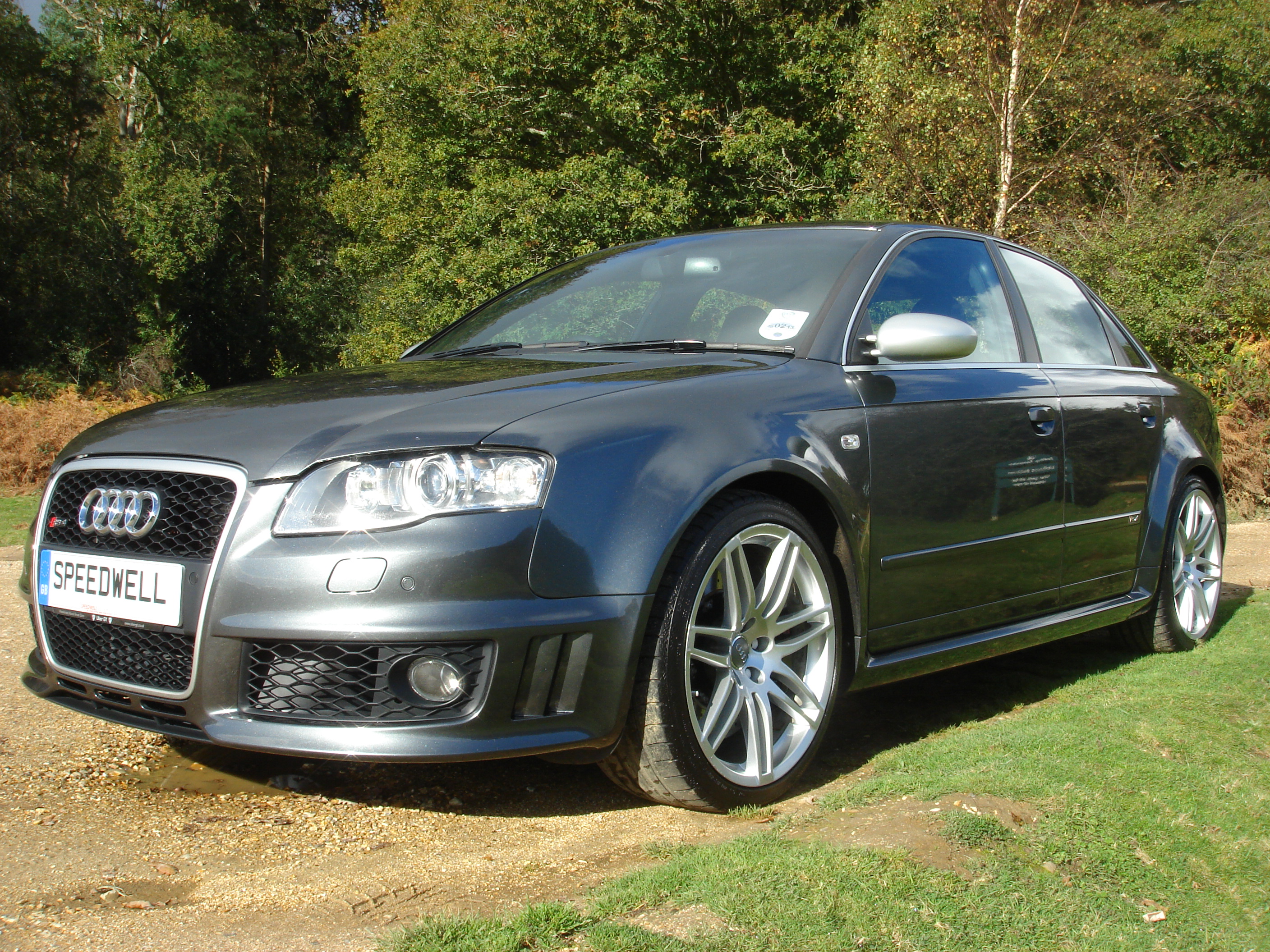

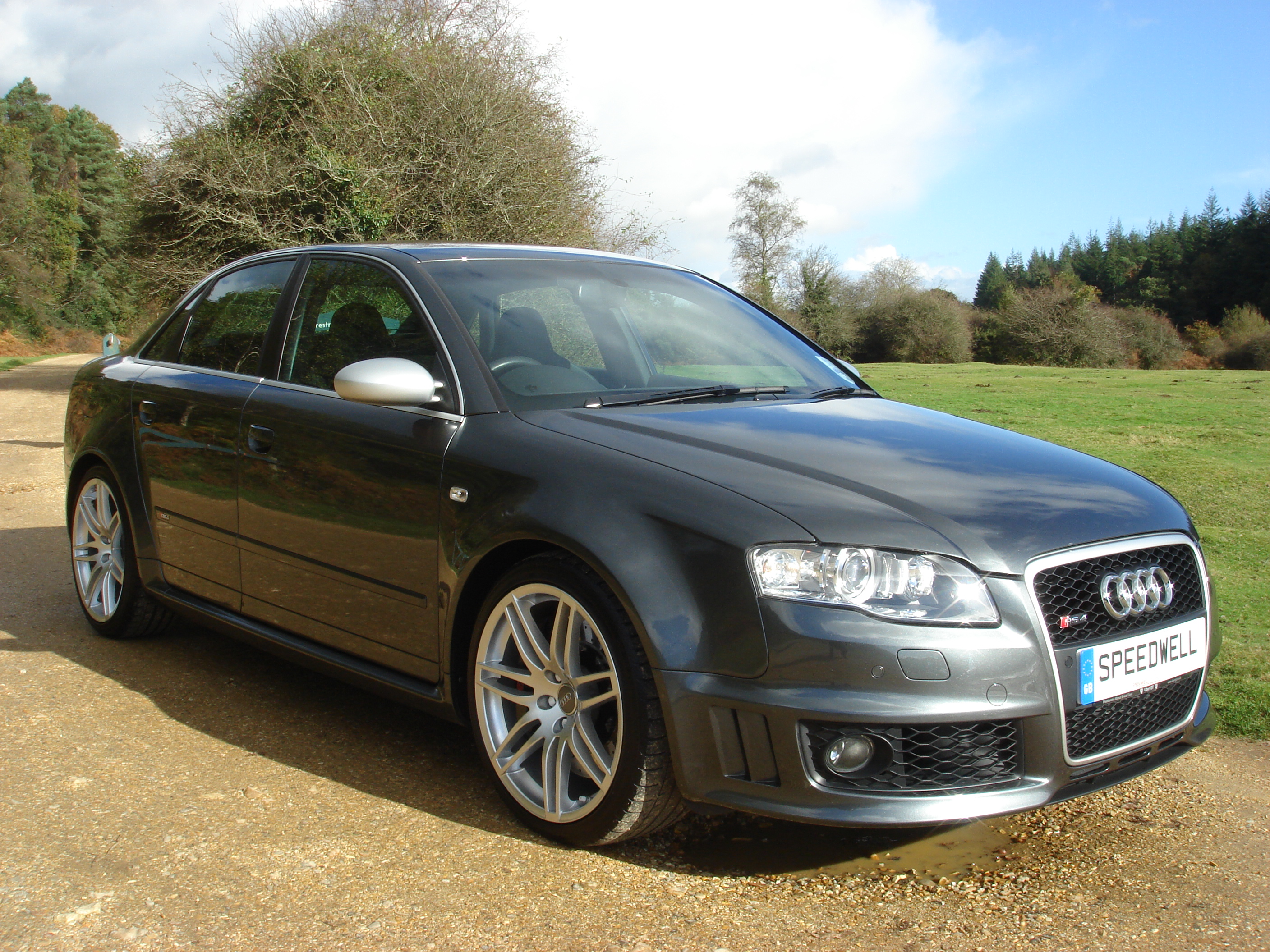

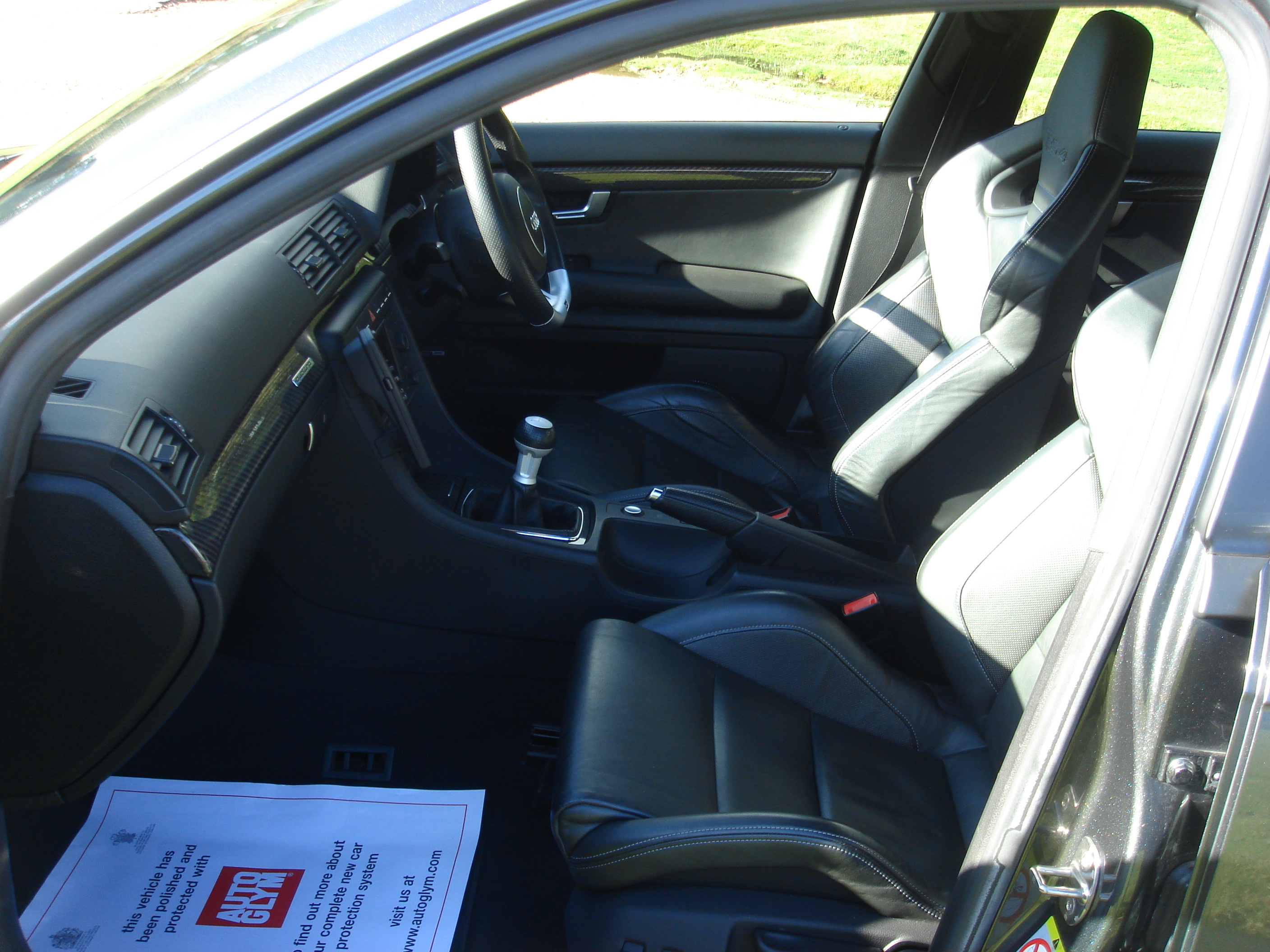

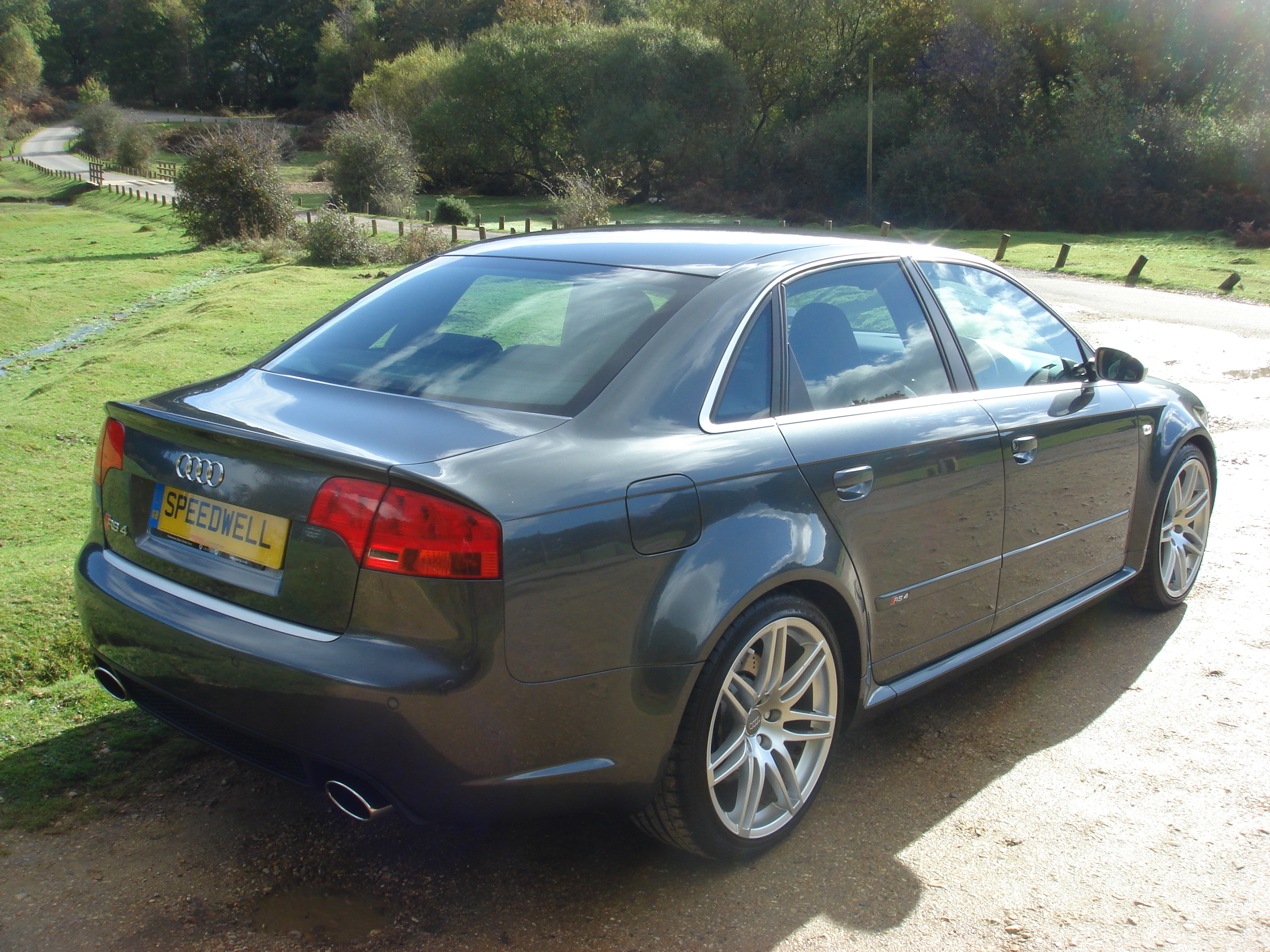

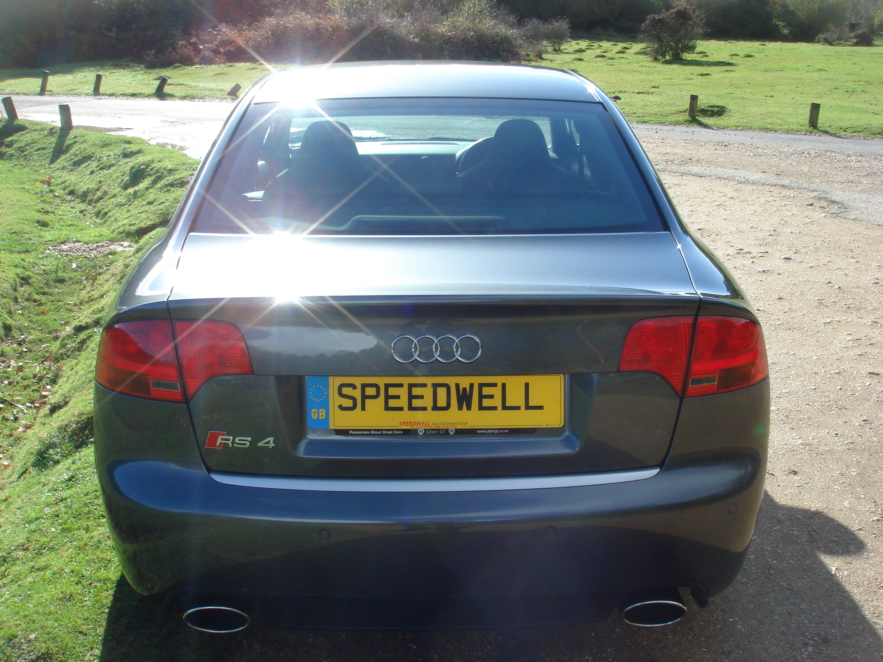

Picked it up with 49k on the clock and in immaculate condition, inside and out. Came from a MKIV Golf R32 so quite a big change to say the least!
First thing on the list was a non res miltek, what a glorious noise that is! Thats all i have got round to doing atm but ive got a few more bits id like to do. Spacers is top of the list right now!
OK, rule number 1, heres some pics!

Top/first shot makes me a little firmer than normal...
Stunning - I like it a lot.

Ha! That was the night before i picked it up. Matey wouldnt let me take it until it had been detailed! Well i wasnt gonna so no was I! Made me go from firm to hard!
