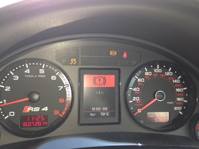

Hi guys I'm back again looking for advice on further problems with my RS4! Never had so many problems with a nice car and just wondered if anybody out there can help me out.
The current problem is occasionally when I go to start the vehicle which usually only when warm or sat in the sun it starts and shows the brake warning light, ABS and traction control light until I turn off the engine and re start it which clears it. (see pic attached)
The 2nd problem which I'm not sure if they are linked and usually when warm or sat in the sun the vehicle just turns over and doesn't fire, Sometimes if I try again it will fire up instantly or more frequently now its taking up to 6 attempts hitting the start button before it will fire and also occasionally only fires on half the cylinders and sounds dog ruff.
The fault codes showing are as follows:
Engine component control relay
Fuel pump relay
Throttle body actuator
Does this point to any particular component ie a relay or is there numerous problems with this car.
Any advice would be gratefully appreciated

My advice when seeing what looks like multiple random electronic failures is to check the condition of the battery and the alternator.
might be worth borrowing one or running the current battery through a conditioner. Any garage should be able to run a health check on the battery quickly and cheaply enough (what you are looking for is the amps pre, during and post engine start... voltage is a small part of the story).
Do you have VCDS?
Do you have VCDS?

I had the same issue last year in Dec. Both scenarios were experienced. I started recognizing when the car won't start by the looking at the lights that won't go out when you turn on the ignition. Can't remember which though ( I think ABS and EPC). I would just sit and cycle the ignition until the lights went out and then it would start. Spoke to the local dealer's guru and he said it sounds like Throttle body! Took the car to him and he said it is the ECM relay for ECU2 (Engine II in VCDS) located in the main fuse box under the main ECU. He replaced the relay and all was sorted... for two weeks and it started again. By that time I invested in a cable and VCDS (best decision ever!) I connected up and got the same kind of errors, but this time it was for ECU1 (Engine in VCDS). Audi replaced the relay located next to the one previously replaced and all was sorted to date.
Your problem sounds like the ECM relay to me. Replace both at the same time and check if this resolves the issue. Not an overly expensive part compared to a throttle body.
The DTCs (errors) I got for the second ECM relay going bust were:

Revision: --H13--- Serial number: XXXXXXXXXXXXXX
Coding: 010C0003180F0160
Shop #: WSC 00259 210 86008
VCID: E3C5F40A22431906665-80B6
7 Faults Found:
001169 - Secondary Air Injection System: Bank 1
P0491 - 002 - Insufficient Flow - Intermittent
Freeze Frame:
Fault Status: 00100010
Fault Priority: 0
Fault Frequency: 1
Reset counter: 255
Mileage: 75809 km
Time Indication: 0
Freeze Frame:
RPM: 1459 /min
Load: 54.1 %
Speed: 28.0 km/h
Temperature: 18.0°C
Temperature: 11.0°C
Absolute Pres.: 1000.0 mbar
Voltage: 13.208 V
005634 - Power Supply Terminal 30
P1602 - 002 - Voltage too Low - Intermittent
Freeze Frame:
Fault Priority: 0
Fault Frequency: 1
Reset counter: 255
Mileage: 0 km
Time Indication: 0
Freeze Frame:
RPM: 0 /min
Load: 0.0 %
Speed: 0.0 km/h
Temperature: -40.0°C
Absolute Pres.: 0.0 mbar
Voltage: 0.000 V
001672 - ECM Power Relay Load Circuit: (J271)
P0688 - 004 - Open Circuit
Freeze Frame:
Fault Status: 01100100
Fault Priority: 0
Fault Frequency: 3
Reset counter: 255
Mileage: 77502 km
Time Indication: 0
Freeze Frame:
RPM: 0 /min
Load: 0.0 %
Speed: 0.0 km/h
Temperature: 17.0°C
Temperature: 25.0°C
Voltage: 0.000 V
000258 - Mass Air Flow Sensor (G70)
P0102 - 002 - Signal too Low
Freeze Frame:
Fault Status: 01100010
Fault Priority: 0
Fault Frequency: 3
Reset counter: 255
Mileage: 77502 km
Time Indication: 0
Freeze Frame:
RPM: 198 /min
Load: 94.5 %
Speed: 0.0 km/h
Temperature: 17.0°C
Temperature: 25.0°C
Voltage: 0.000 V
005923 - Starter Interlock Signal
P1723 - 002 - Open Circuit
Freeze Frame:
Fault Priority: 0
Fault Frequency: 1
Reset counter: 255
Mileage: 79141 km
Time Indication: 0
Freeze Frame:
RPM: 0 /min
Load: 0.0 %
Speed: 0.0 km/h
Temperature: 17.0°C
Temperature: 26.0°C
Voltage: 0.000 V
005445 - Throttle Valve Controller
P1545 - 008 - Malfunction
Freeze Frame:
Fault Status: 01101000
Fault Priority: 0
Fault Frequency: 1
Reset counter: 255
Mileage: 79141 km
Time Indication: 0
Freeze Frame:
RPM: 0 /min
Load: 0.0 %
Speed: 0.0 km/h
Temperature: 18.0°C
Temperature: 26.0°C
Voltage: 12.065 V
008454 - Throttle Valve Actuator Module (J338)
P2106 - 008 - Power Limited due to Malfunction
Freeze Frame:
Fault Priority: 0
Fault Frequency: 1
Reset counter: 255
Mileage: 79141 km
Time Indication: 0
Freeze Frame:
RPM: 0 /min
Load: 0.0 %
Speed: 0.0 km/h
Temperature: 18.0°C
Temperature: 26.0°C
Voltage: 12.065 V
Readiness: 0000 0000
Address 03: ABS Brakes Labels: 8E0-910-517.clb
Part No SW: 8E0 910 517 G HW: 8E0 614 517 BD
Component: ESP8 quattro H06 0150
Revision: 00000000 Serial number: 00000000000000
Coding: 0004533
Shop #: WSC 06335 000 00000
VCID: 2B55DC2A8A1311461E5-807E
2 Faults Found:
01314 - Engine Control Module
004 - No Signal/Communication
Freeze Frame:
Fault Priority: 1
Fault Frequency: 1
Reset counter: 40
Time Indication: 0
Freeze Frame:
Hex Value: 0x0080
Hex Value: 0x0722
Hex Value: 0x0013
Hex Value: 0x8594
Hex Value: 0x0001
18265 - Load Signal
P1857 - 000 - Error Message from ECU
Freeze Frame:
Fault Status: 01100000
Fault Priority: 2
Fault Frequency: 3
Reset counter: 40
Time Indication: 0
Freeze Frame:
Hex Value: 0x0000
Hex Value: 0x0722
Hex Value: 0x0028
Hex Value: 0x0190
Hex Value: 0x0001
Address 11: Engine II Labels: 079-910-560-BNS2.lbl
Part No SW: 8E1 910 560 HW: 8E1 907 560
Component: 4.2L V8/4V FSI ª0080
2 Faults Found:
Freeze Frame:
Fault Priority: 0
Fault Frequency: 1
Reset counter: 255
Mileage: 0 km
Time Indication: 0
Freeze Frame:
RPM: 0 /min
Load: 0.0 %
Speed: 0.0 km/h
Voltage: 0.000 V
Freeze Frame:
Fault Priority: 0
Fault Frequency: 3
Reset counter: 255
Mileage: 77502 km
Time Indication: 0
Freeze Frame:
RPM: 0 /min
Load: 0.0 %
Speed: 0.0 km/h
Temperature: 17.0°C
Temperature: 25.0°C
Voltage: 0.000 V
Address 17: Instruments Labels: 8E0-920-9xx-8EC.lbl
Part No SW: 8E0 920 981 R HW: 8E0 920 981 R
Component: KOMBI+WFS 4 H14 0040
Revision: 0040 Serial number: 00000000000000
Coding: 0023411
Shop #: WSC 45344 000 1048576
VCID: 3C77EF767C7D86FE87F-5124
1 Fault Found:
004 - No Signal/Communication - Intermittent
Address 25: Immobilizer Labels: 8E0-920-9xx-8EC.lbl
Coding: 0023411
1 Fault Found:
