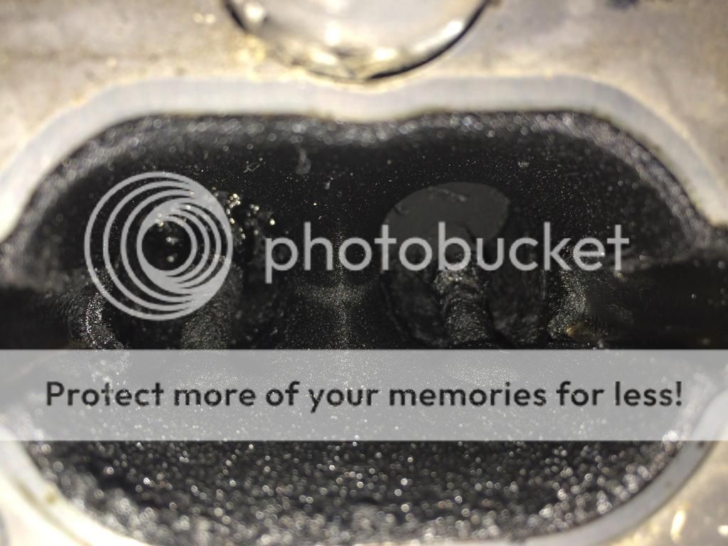

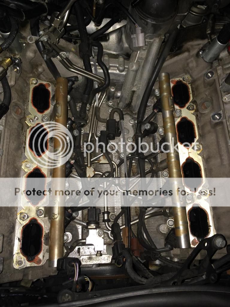

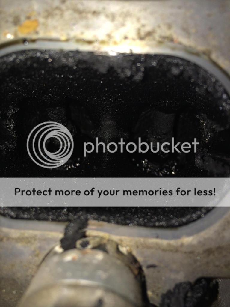

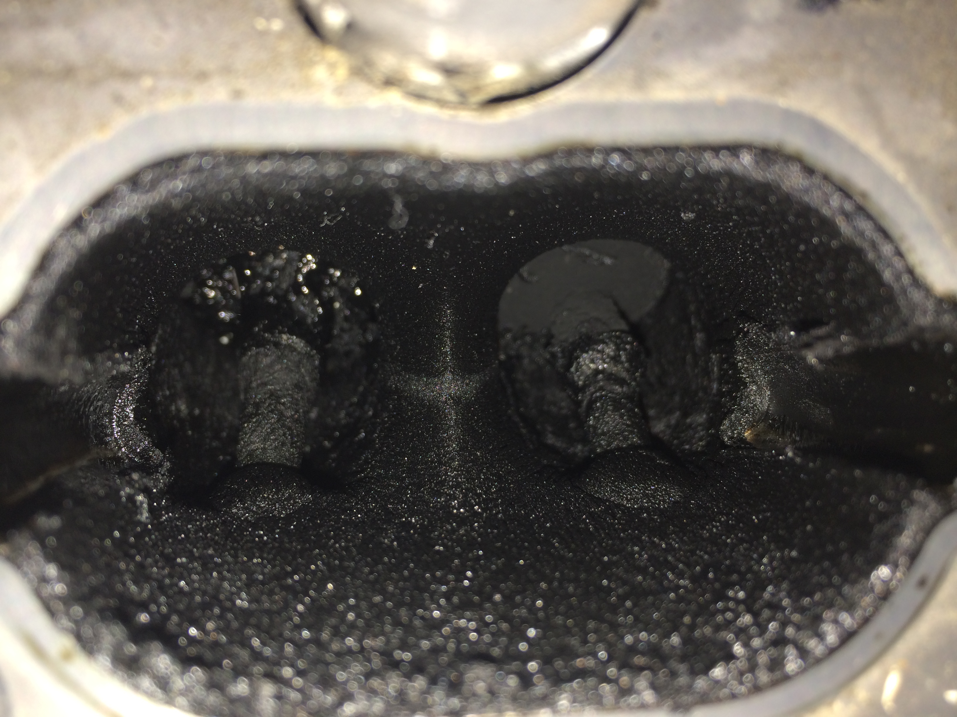

Got the manifold off last night, what a pain, whoever got it of in 1 and a half hours, fair play, probably took me double that... disconnecting those pesky vacuum lines and electrical connectors under the manifold whilst trying to hold it up on your own are a right potch :roll:
Please see pics below:
Not the worst carbon build up ive seen on here but I still had the kick and it always ran well/has a shoeing so I wasn't expecting it to be too bad, still needs a good clean though.
Now just the wait for my blaster gun and walnut shell media to arrive (hopefully today)e

Post by TonyHayers » Fri Jul 04, 2014 9:58 am
Great before pics. Looking forward to seeing gleaming valve stems.
Just to think Audi spent tonnes of time and money on research and development to get the intake valves looking like this.
