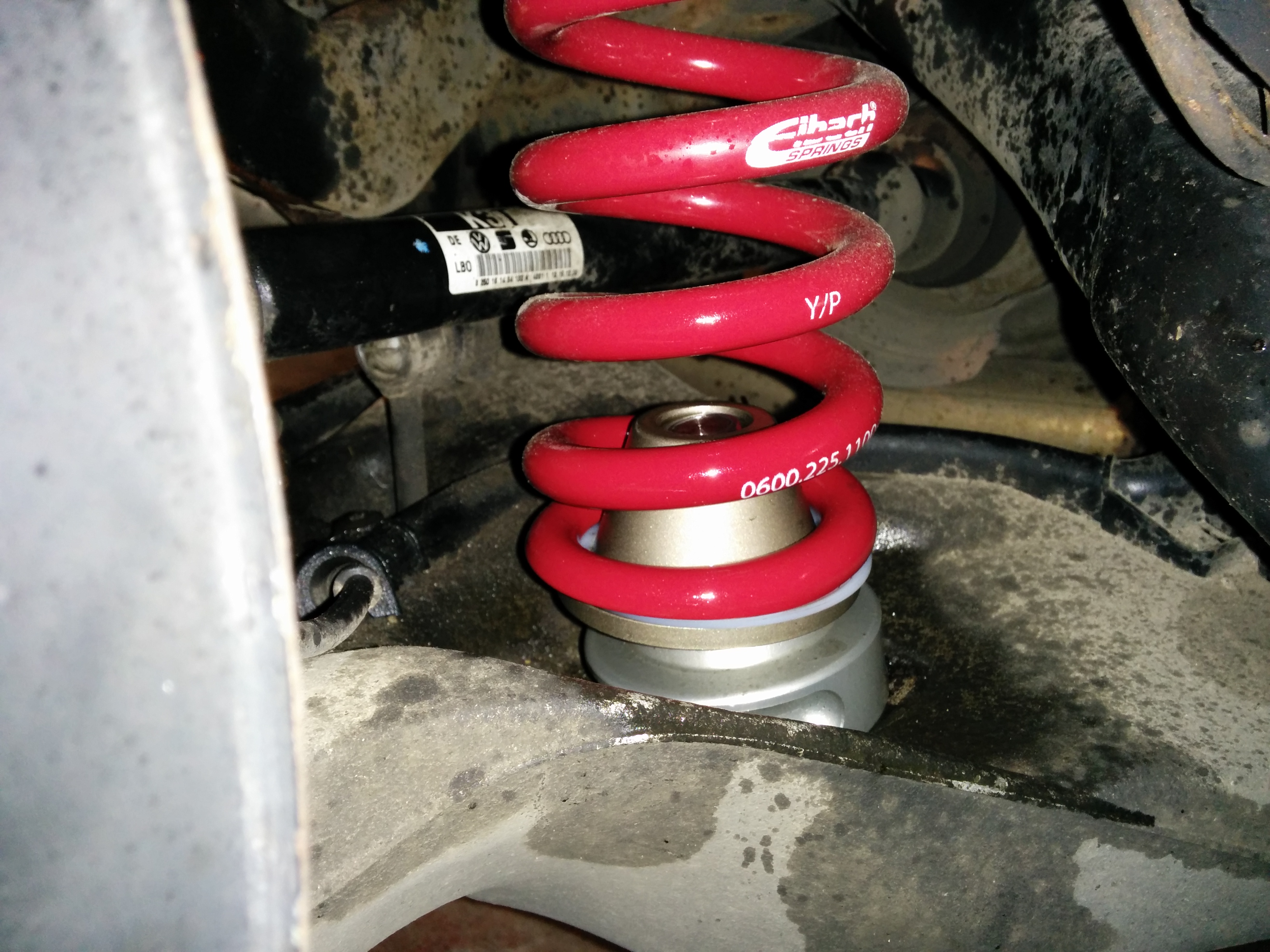

stas_magic wrote:So rear springs are fitted on coilovers, not separately as for stock/KW v3 setup?
Or this one are used? http://performanceshock.com/index.php?m ... ts_id=1283

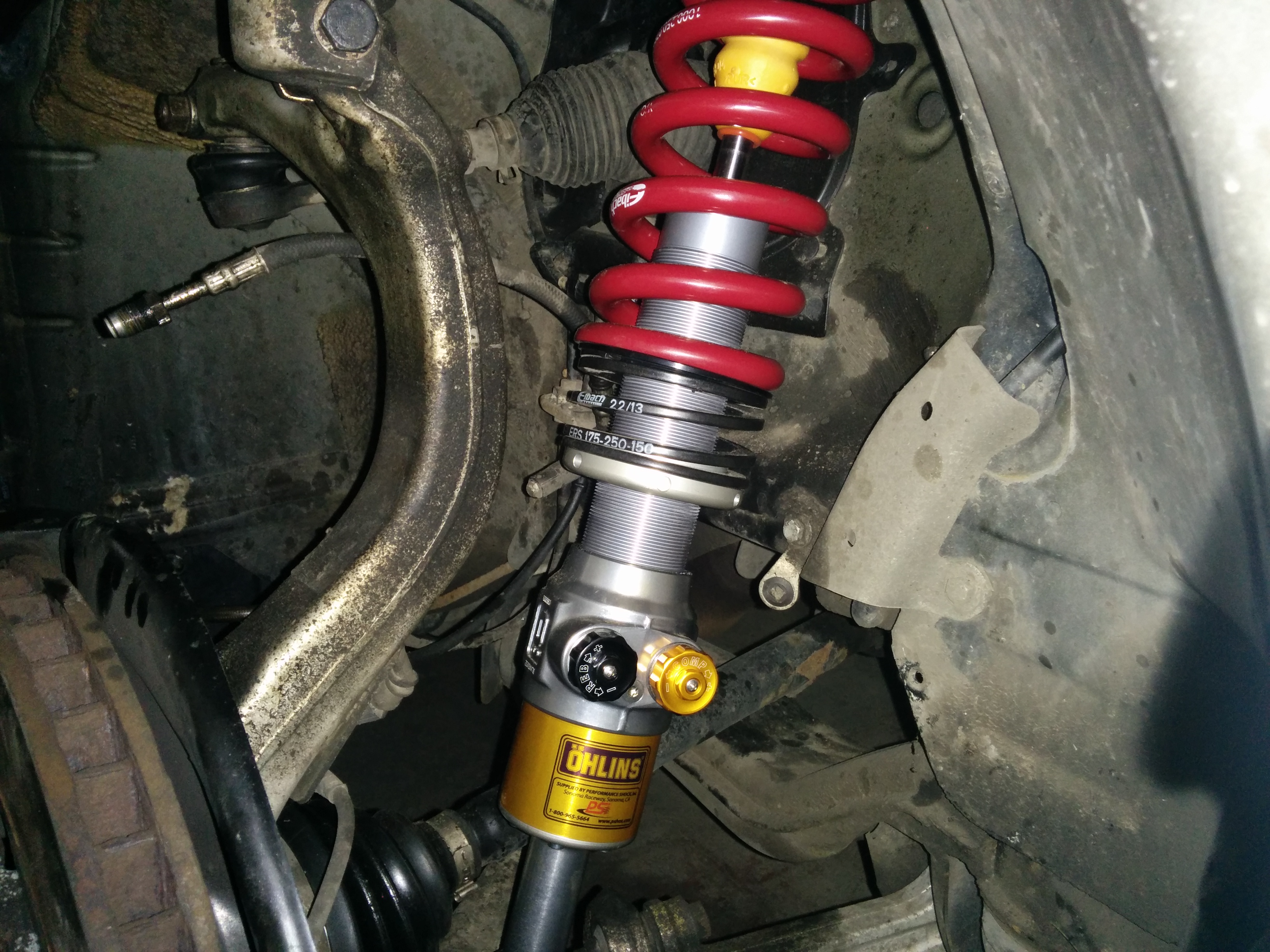

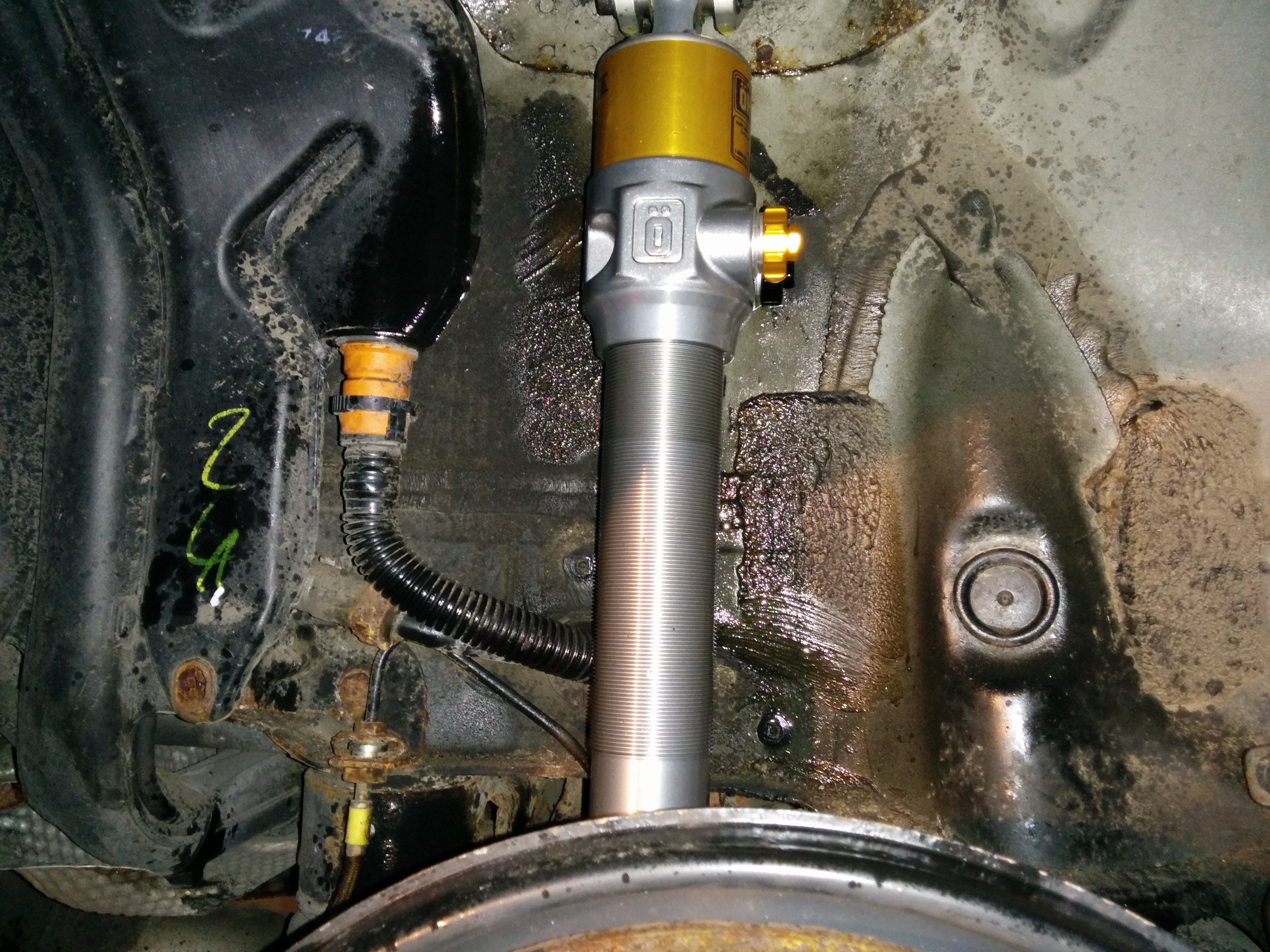

no the rear springs are separate like stock, its the same set up in the link.
heres a pic, they are a piece of cake to adjust ride hight.

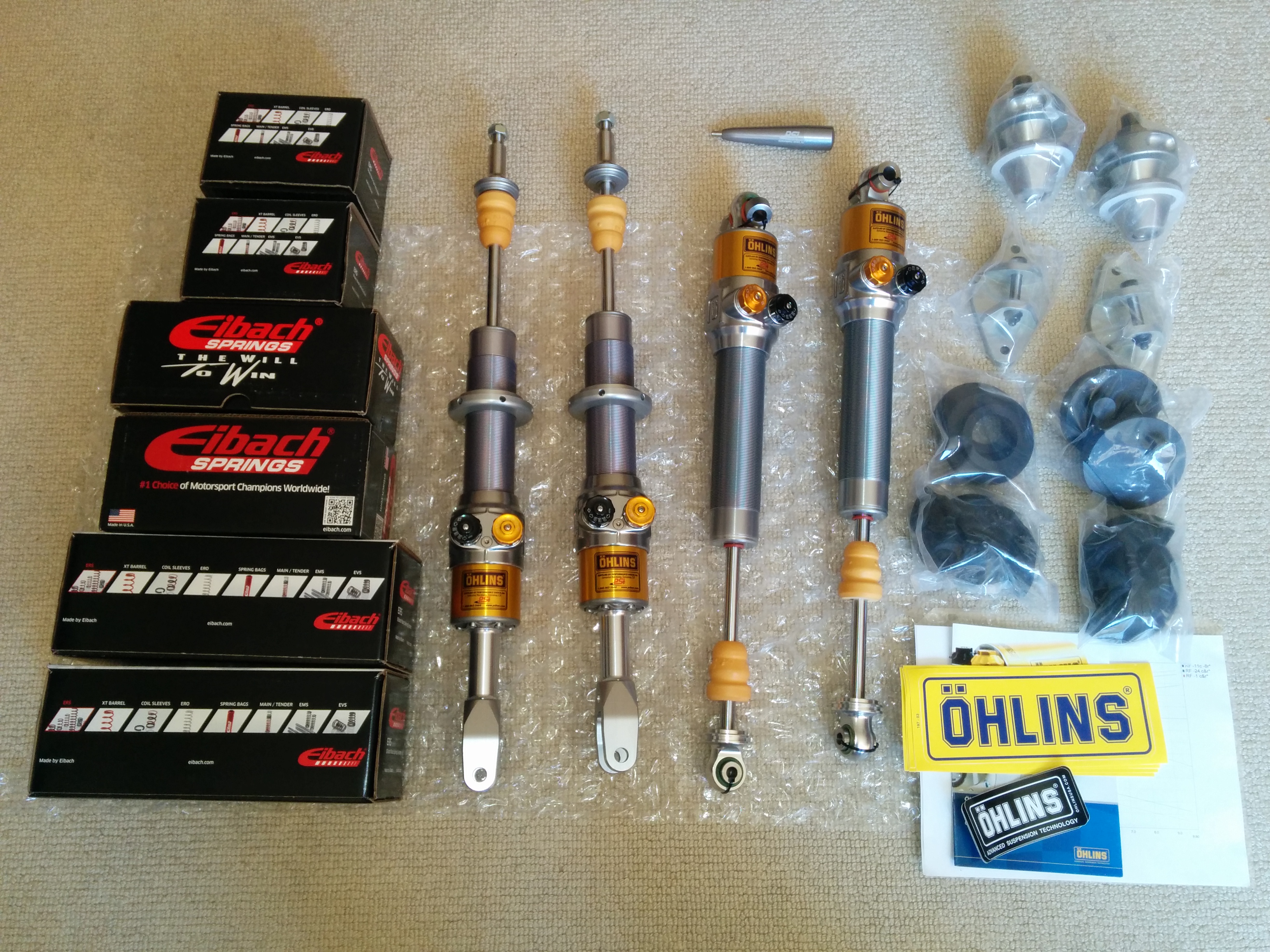

that link is for the 3-way adjustable kit, mine are just the 2-way. i can have them upgraded here in the uk to 3-way for £150 a shock or 4-way for £300 a shock.
but yes everything needed for install is included in the kit.

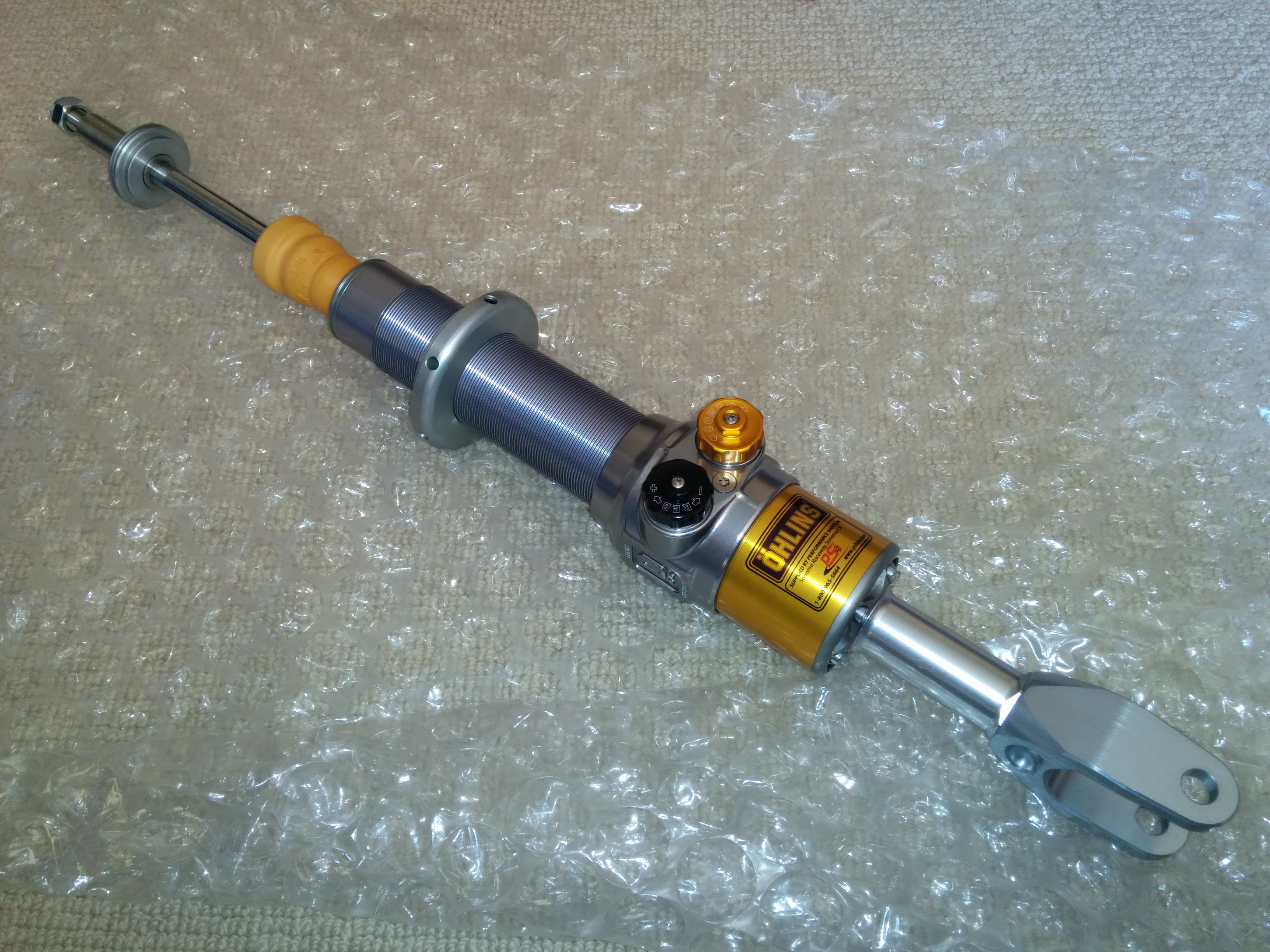

the only extra i bought was new 034motorsport density line strut top mount rubbers.
the wet on the pics is where i have sprayed them with a good coating of boeshield t-9, the boeshild seemed popular with people in the states for protecting the shocks against general road nasty.

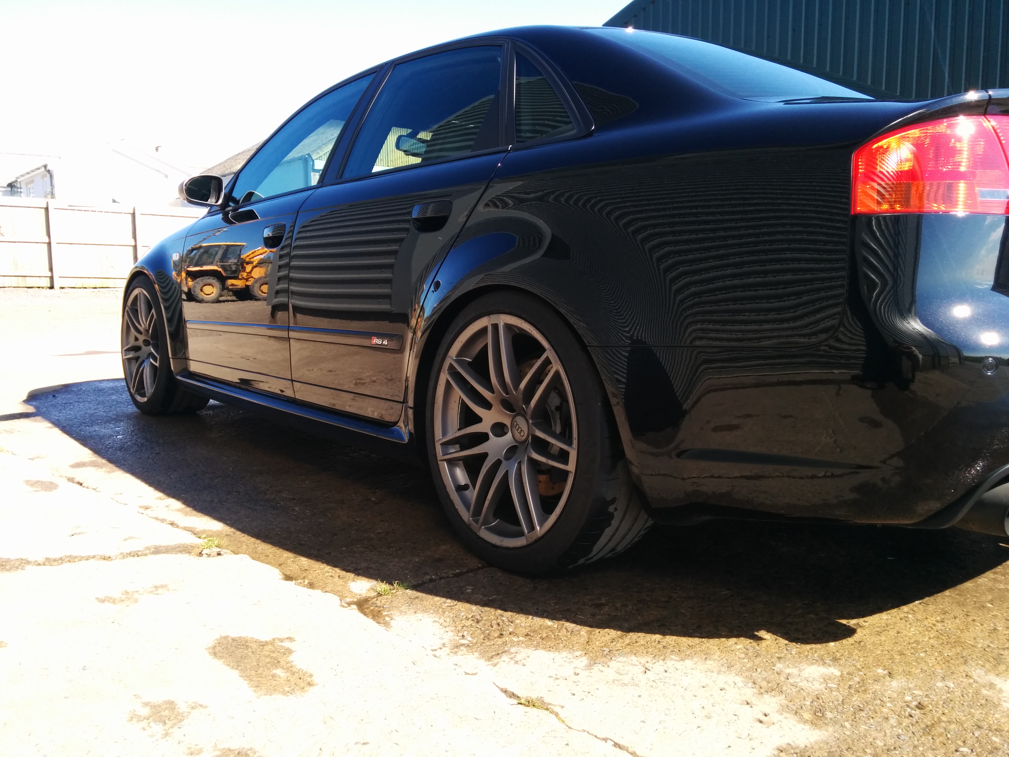

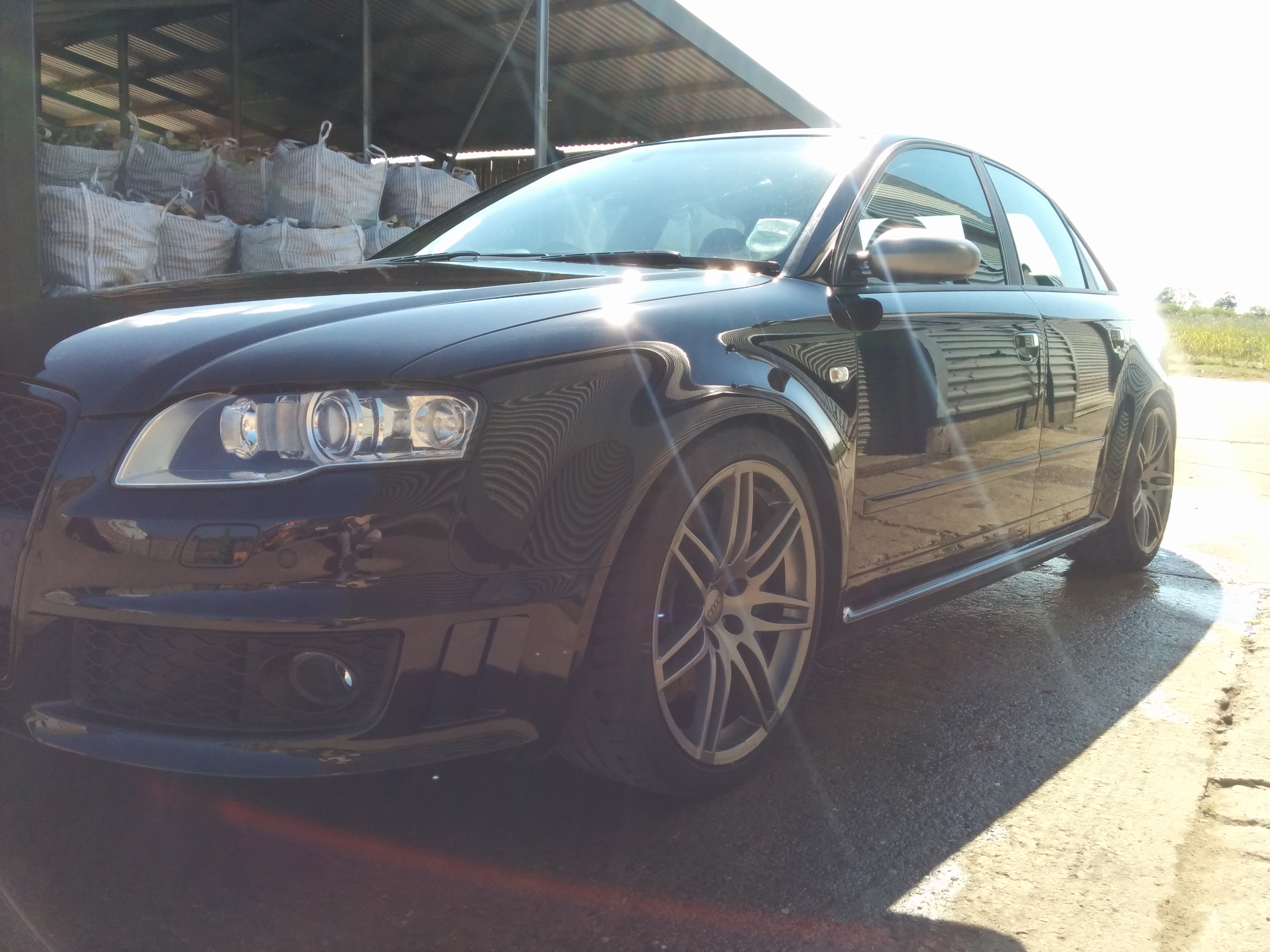

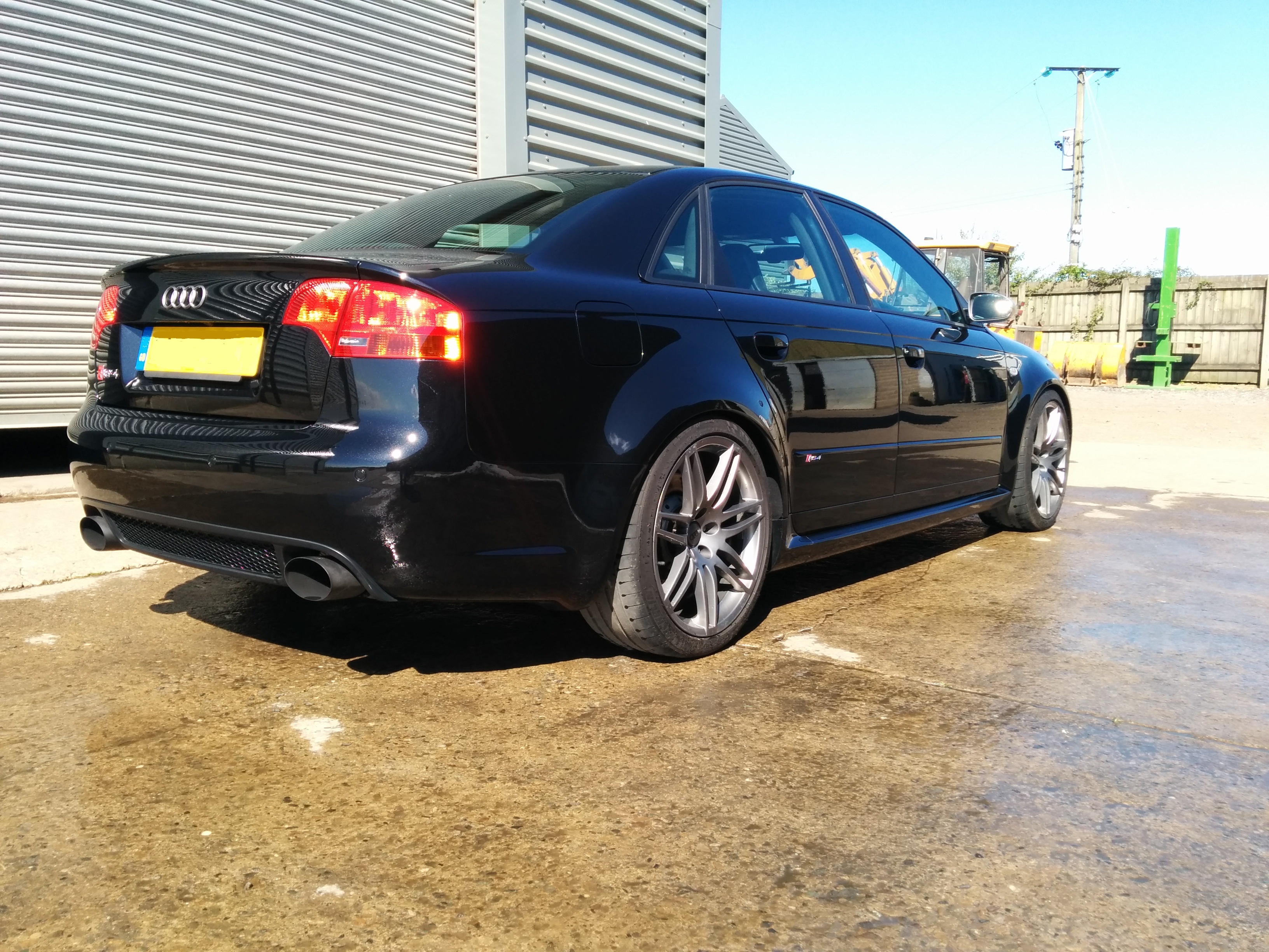

took a couple of quick pics yesterday, this is at 25.5 inch floor to arch center all round.
what heights are people at?.

Post by adsgreen » Wed Jul 02, 2014 11:25 am
Worth checking the floor to ground measurement too - I always find it best to have a small amount of front rake
(best to put some ballast in the front seats too when checking).
It (mighty) looks fine from the pictures though.
