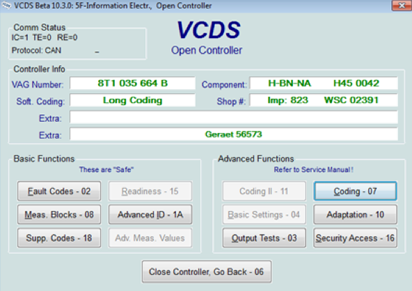

Video in motion sorted......
VIM (Video In Motion)
The first step is to retrieve the serial number of the Navigation Unit.
For MMI 3G go to:
[5F - Information Electr.]
You will find the serial number by clicking on the Advanced ID - 1A on the controller screen in VCDS. Generic screen shot shown below for reference.

1. Select control module 5F in VAG-COM/VCDS
2. Select "Advanced ID - 1A"
3. Decode the value from the "Serial number" field. If there is more than one serial number field, use the first one! (Use the VIM decoder)
4. Select "Security Access - 16"
5. Enter the login-code decoded from Serial Number. (Enter code 1 obtained from the VIM generator)
6. Press "Do It!". If you receive a "code not valid" message try the alternate code. If neither code works it's likely that your control module doesn't support VIM adaptation.
7. Select "Adaptation - 10"
8. Select channel 48
9. Press read
10. Set the value to 255
11. Press test
12. Press save
13. Press "Done, Go Back", close the controller and quit the software
14. Now reset the MMI.
This is done by pushing down the Menu – Scroll Wheel and top right menu buttons at the same time. Press all three at the same time then release. The MMI will reboot and you should have video in motion !!!!
For MMI 3G go to:
