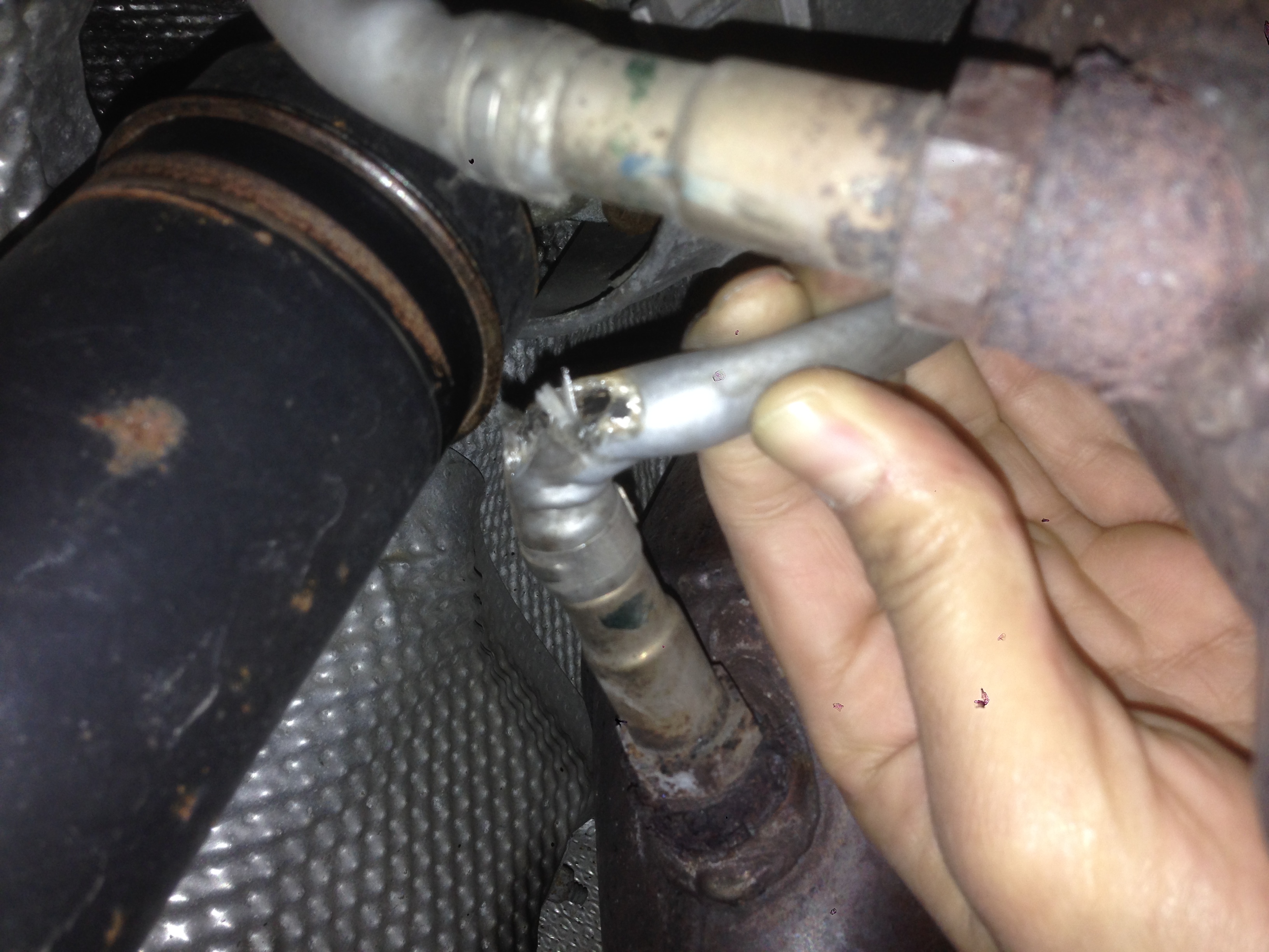

So i had the car up on the ramp for an inspection and found the o2 sensor bank 2 s2 ( which i believe is post cat - passenger side). The loom has been catching on the prop causing the heat shrink to come away and affecting one of the white wires, this wire which had strands of copper touching the prop also. I have repaired the wire and loom and cleared the faults.

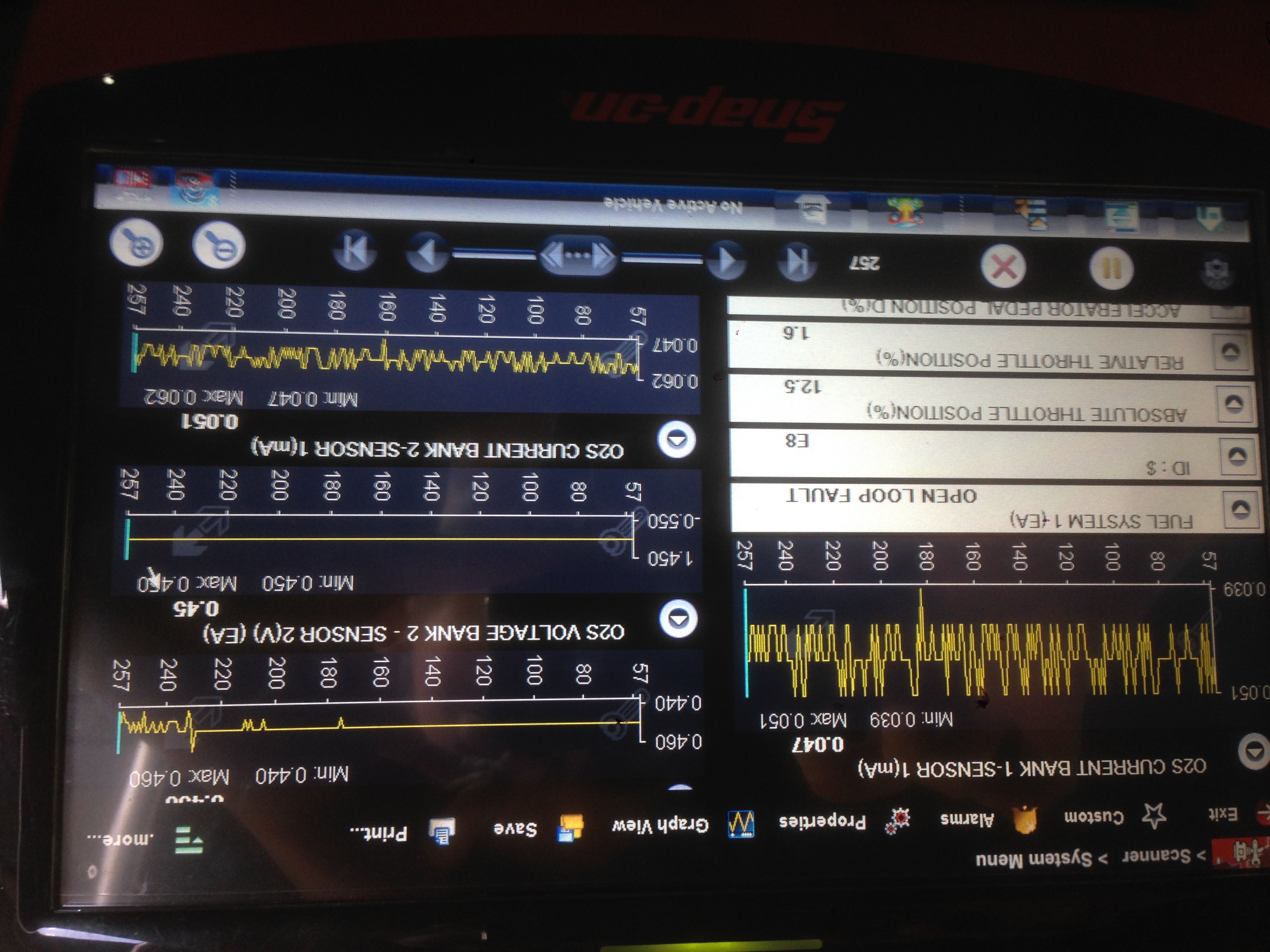

So i again ran the following checks:
1- Checked all four o2 sensors heating element. Pins 1 & 2 read below 10 ohms and are closed circuit. This only tells me that the heating element is ok. Did these check with the sensors unplugged from the loom.
2 - checked current draw on all 4 sensors. images attached -

Snap On Diag Live Current Draw Data
B2 S2 Post Cat

For future reference all 4 lambda sensors are wired through a 15amp fuse which is located underneath the ECU.
All sorted now!!
