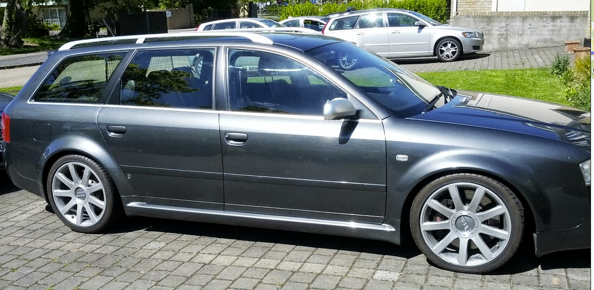

so as I've been driving around in the c6 s6 for a while now, I've gotten used to the MUCH better ride quality than my rs6 with the PSS9s. I have the rs quite low though, and while it looks pretty excellent, i was wondering what height folks have theirs at.
here's mine, but would be interested in seeing where other folks have theirs...

Yours doesn't look that low, though. TO raise the height of the car, you compress the springs more (I know, counter-intuitive) so you've actually got less available travel before coils of the spring touch and suddenly become incompressible. This results in an unpleasant bang that makes my sphincter twitch. Is this what you're experiencing? Unpleasant banging making your sphincter twitch?

Yeah - I'm on 18's though so there will be some more space in the arches.
so are you saying that you have it all the way up?

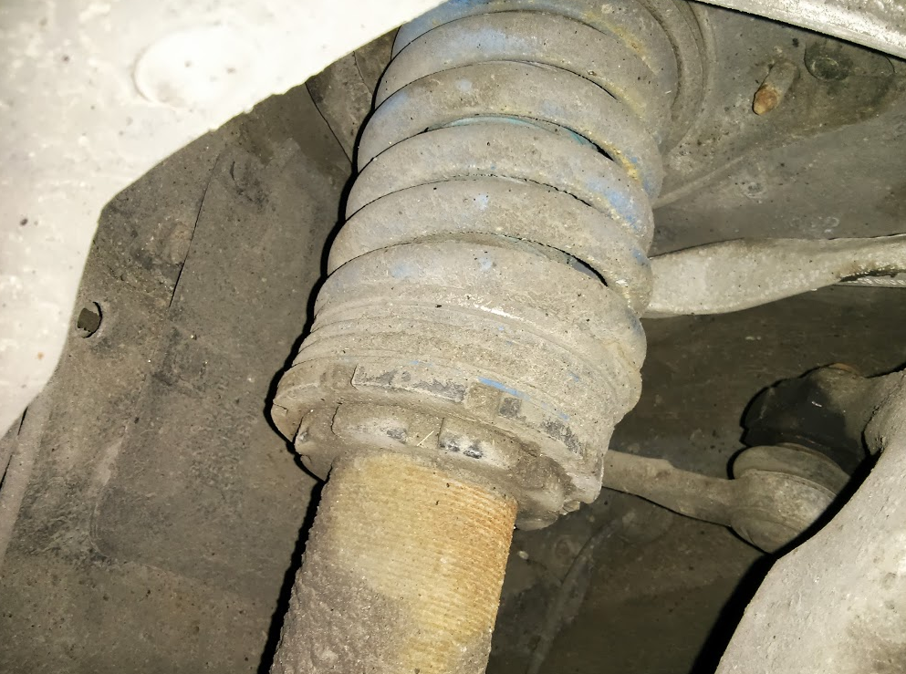

so took a quick photo of the right hand front coilover with the wheel turned out - looks like there is some room to raise up the car all right.

Wow, that's filthy. That spring already looks pretty compressed. How much thread is left? You're going to stuggle to adjust anything there without lots of cleaning.

yeah - power washer to the rescue I think.
