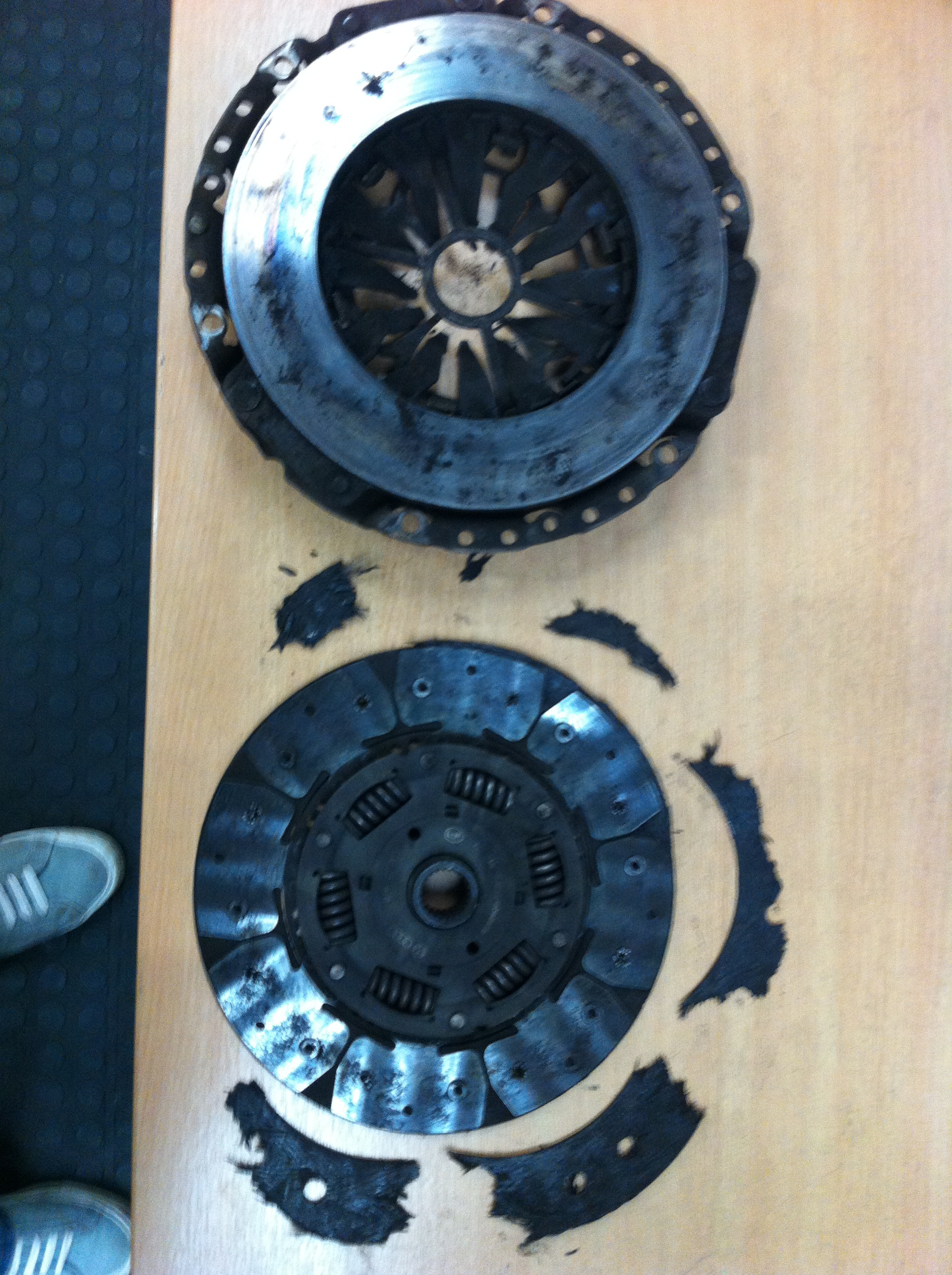

Re: Clutch failure!
Mine went on lap 25 braking into the hairpin at donnington. No warning, no noises, pedal went to the floor and wouldn't come back up. Full replacement £2k!
Re: Clutch failure!
Damn thats a right mess.
Re: Clutch failure!
Hahaha that clutch looks the same as what my Sachs one ended up like
