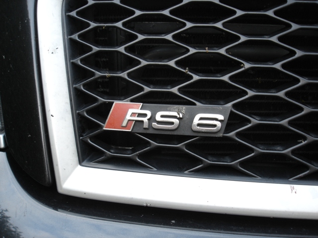

Ok front badge (measurements to bottom left corner of badge) is 23mm from the inside of the silver trim to the left of grill and also 23mm from the top of the horizontal silver grill trim.

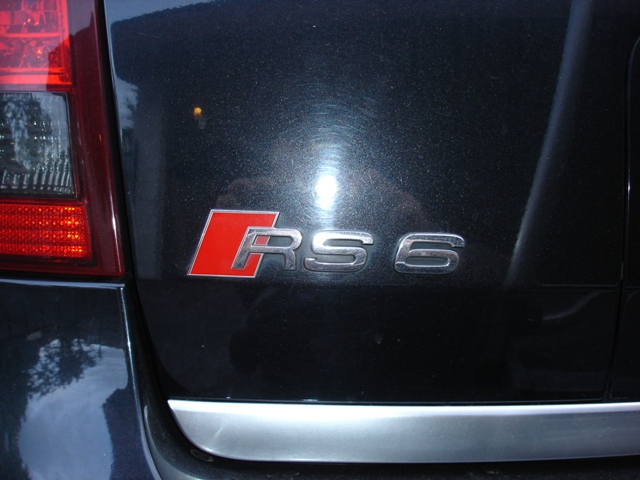

Again measurements to bottom left of badge, 30mm from tailgate left edge and 75mm from top of silver trim strip. There is a horizontal crease in the tailgate the red part of the badge sits approx 1-2mm above this.
Hope that helps.

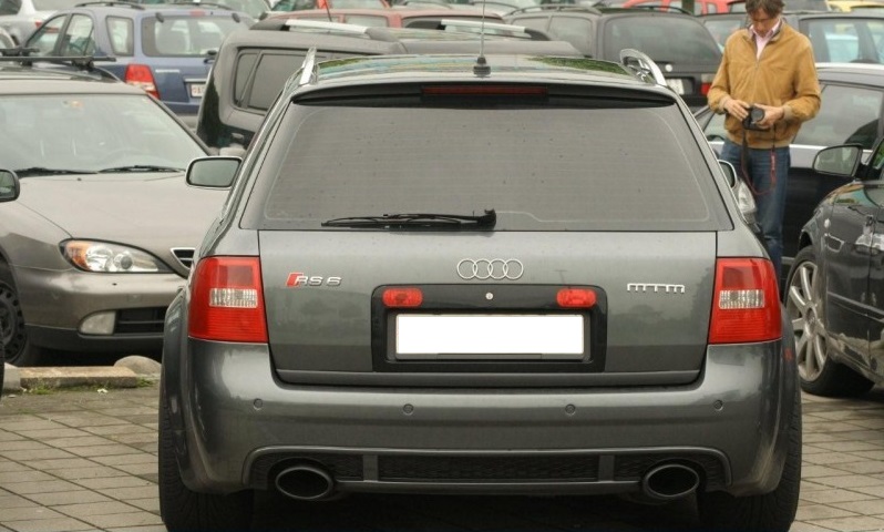

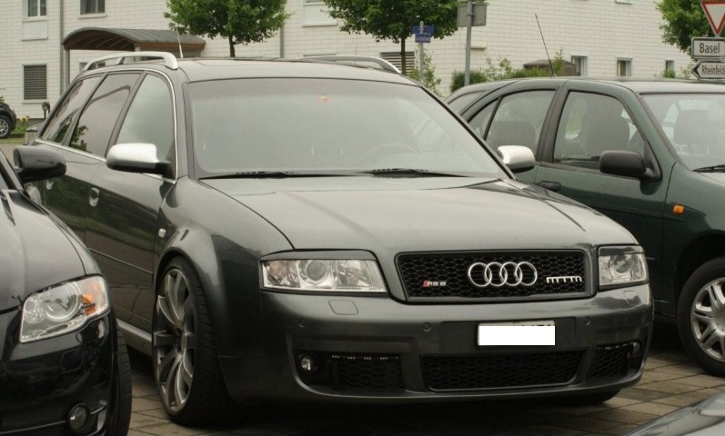

The amount if cars that have their badges in the wrong place is ridiculous!
Gets on my nerves!

oh really...

That's just what I needed. Thank yougingertoss wrote: Ok front badge (measurements to bottom left corner of badge) is 23mm from the inside of the silver trim to the left of grill and also 23mm from the top of the horizontal silver grill trim.
Hope that helps.
