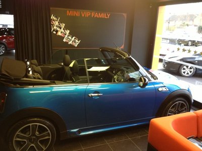

Post by ROY » Mon Feb 04, 2013 6:00 pm
Here's a pic of the little rascal
