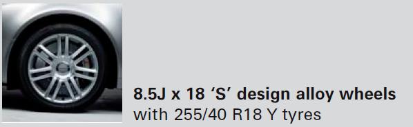

According to the 2006 A6 range brochure you could have the 8.5jx18 'S' design alloys fitted with 255/40/18 tyres as a no charge option on the S6.
Re: Wheel and tyre combination for S6
Thanks. Any idea what the offset of those rims would be?
No idea, they will rarer than hens teeth. When going for a winter set, I tracked down some alloys first and *then* ordered the tyres. As above, you could have any 18 x 8.5 or 18 x 8, tyres 255/40 or 235/40 R18
