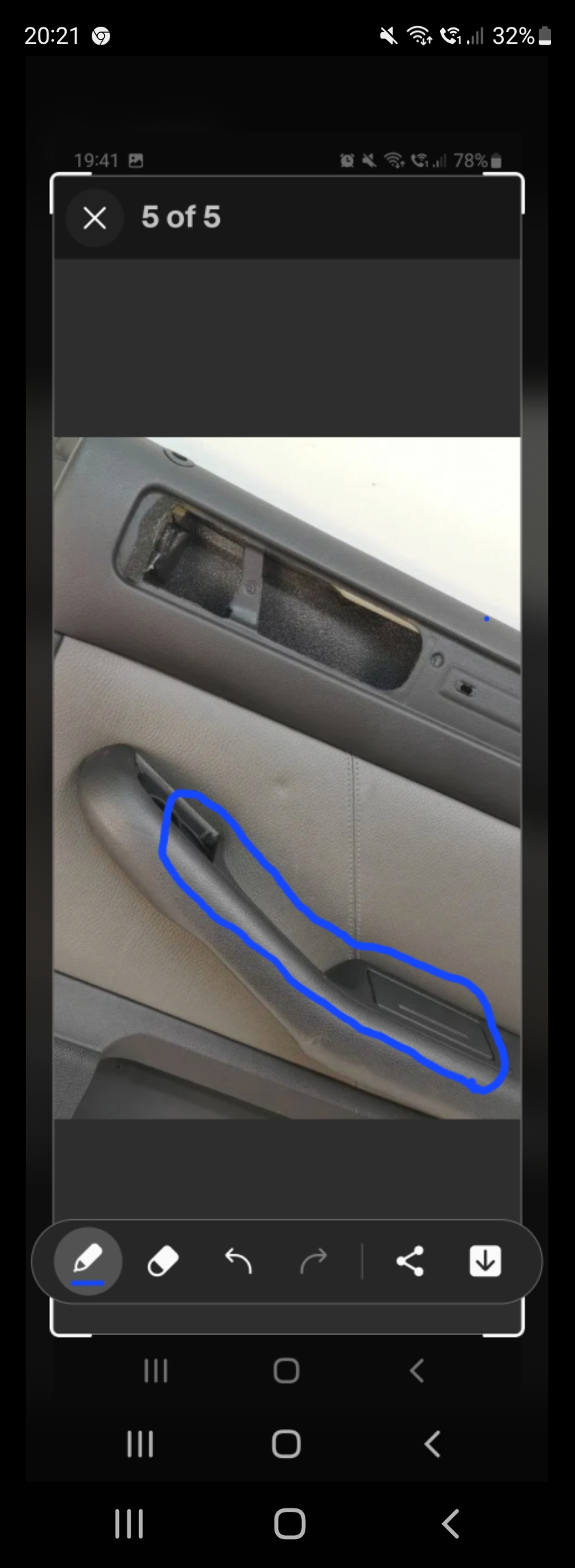

Hi Ben. It’s the black plastic trim on top of the door arm rest I am after.
All scratched. Last resort will be to get them dipped.
Re: Easiest way to order genuine parts
It's this bit I need on all 4 doors:
May have a look at getting them dipped myself - tried a few breaker cars but they're all the same.
Yup. It's part of the door card. You can't get them individually. Plastidip or rub the rubber lining off to expose the smooth plastic underneath, which is quite presentable.

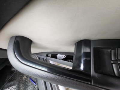

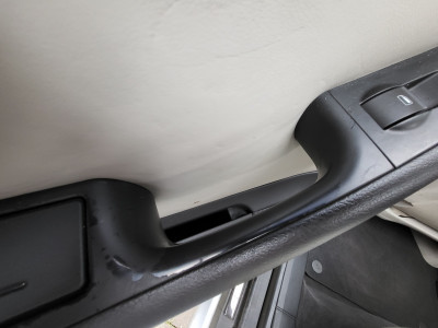

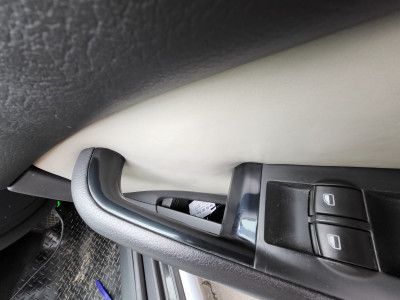

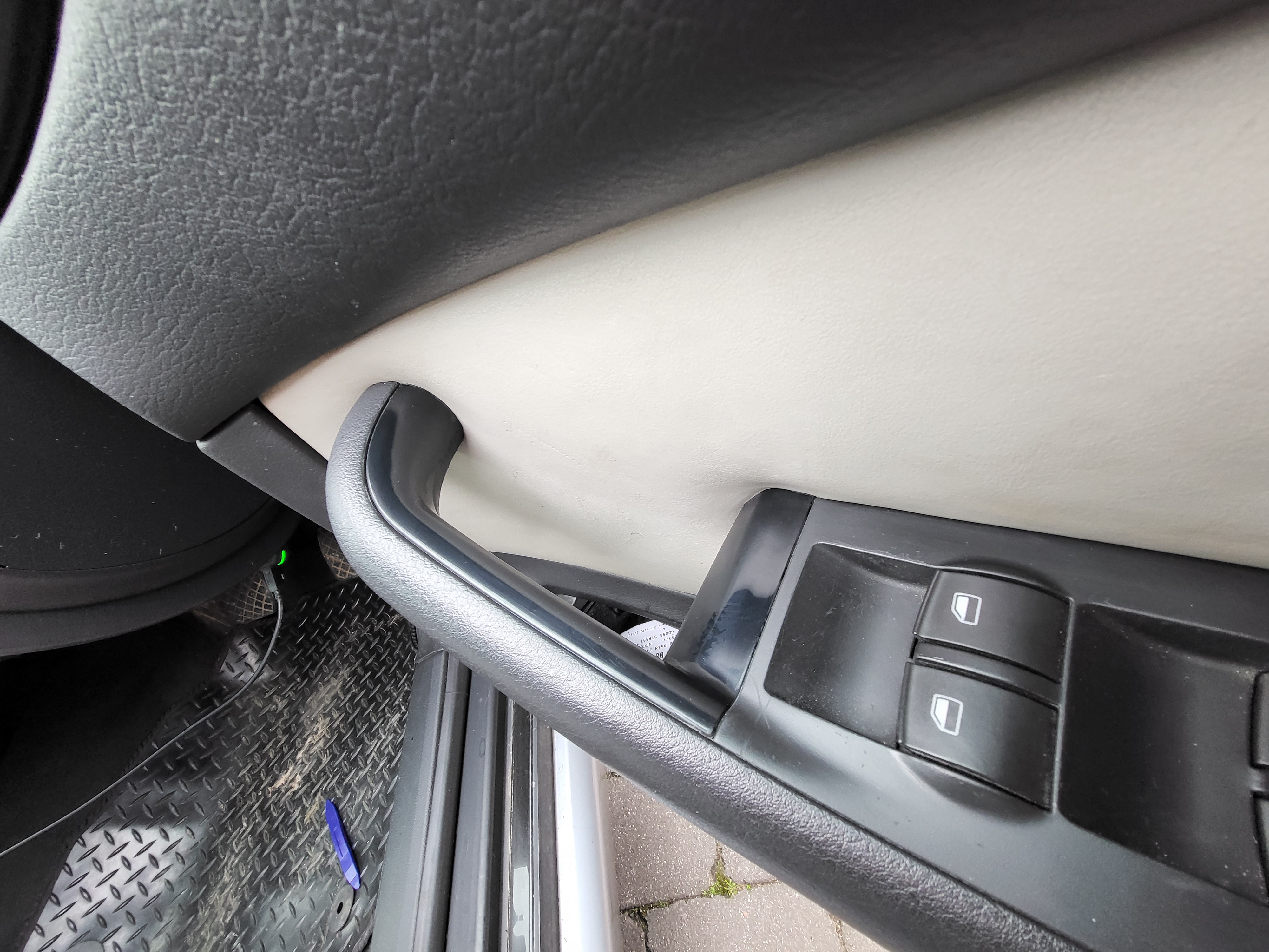

Scraped a bit off, looks a lot better.
Before (this is the rear forgot to take a before)
After with a plastic polish
Anyway don't need to source this part anymore as I'll be happy once I've done them all.
Only thing is I may want to do the window switches panel too which will be a lot of scraping!
Yeah, that looks fine.
