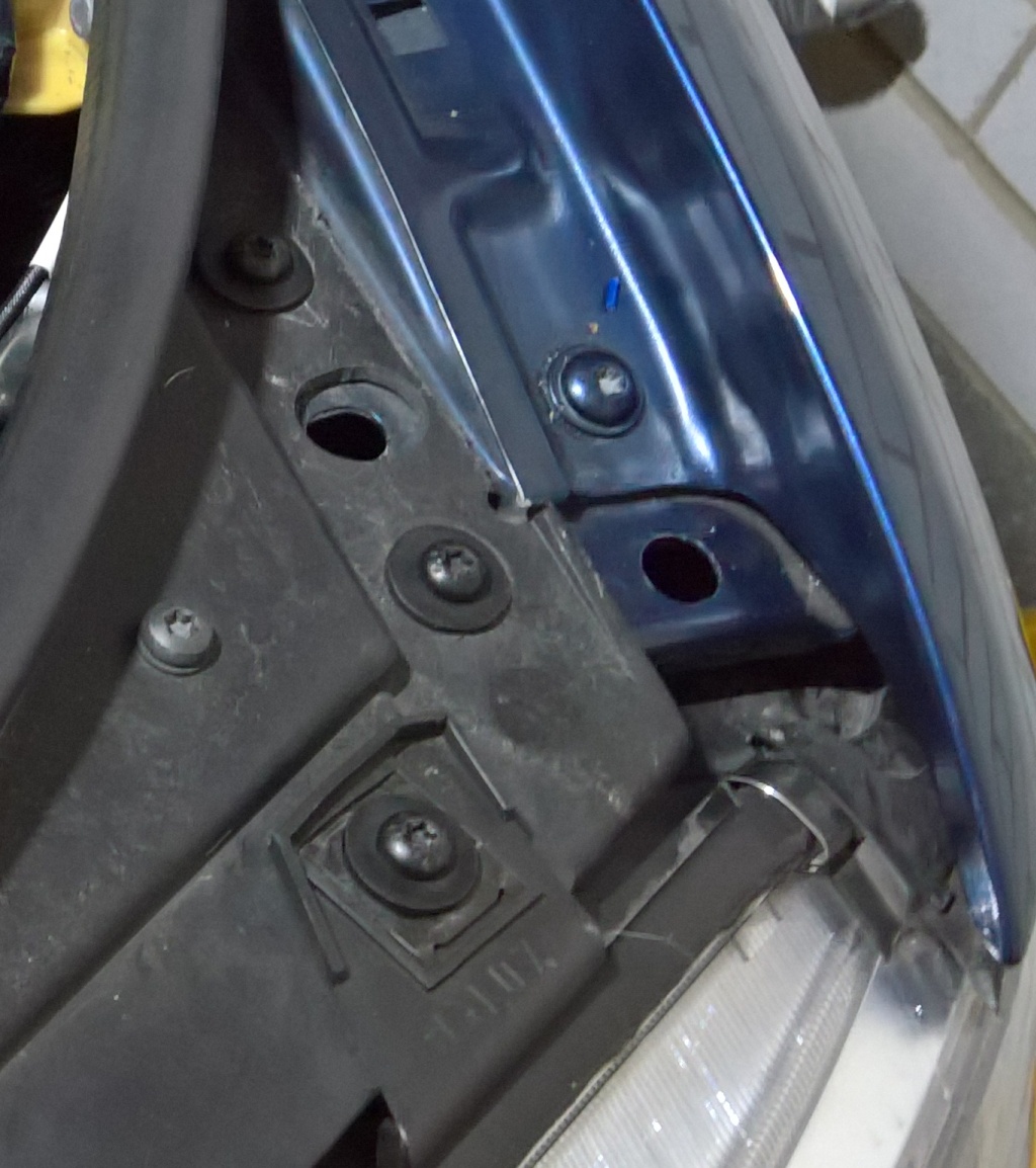

Re: Coolant leak
Just done this again and modded the lights. Drilled out the bolt hole in the sheet metal above the lower outer securing bolt to 18mm. Reduced the round peg and square locating tab length by half. The light can now easily be removed using a spatula to bend back the white plastic mount shown in your post,(It's very flexible) and sliding the light to the outer side before swinging the inner edge forward and out. The reduced length locating peg makes no difference as still engages fully. Only a few minutes now with nothing else needing removing.simonpoulton wrote: ↑Thu May 14, 2020 6:46 pmAlso judging by my lights, quite a big risk off snapping off the lower mounting points doing it without the bumper coming off. I have just made some replacement mounts which seem to have done the trick:

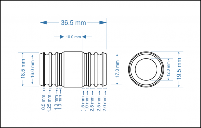

Re: Coolant leak
That might be the one I bought a while back.
Somewhere I have a drawing with the dimensions on, I'll dig it out and post it.
I suggest someone with a sample pipe to hand and suitable measurement tools verifies that, I can't!
Steve2003rs6
- Posts: 2970
Re: Coolant leak
HPsauce. Just ordered one from the info classik provided before I saw your reply. £21:67 including delivery from Poland. Many thanks for the diagram. If I need to I can now manufacture one from the dimensions provided.
