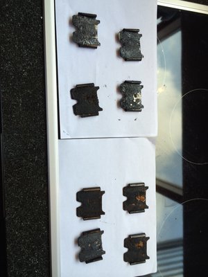

They look like wood. Guess they're phenolic ? Also you'll have two new sets of gaskets right?
Love the car. Wish I could have had an avus avant.
hlbeckley
Posts: 596
Re: Avus Avant 2008 sloooow build
Post by hlbeckley » Tue Jul 29, 2014 8:20 am
They are Phenolic, but i alos saw the packet and thought....oh boy.
Tried to capture the material in the close up pic...they took a month to get the CNC-ing right and precise but all sorted now.
So they coem with just one set of gaskets, the other set the carbon cleaning company provide, so there is a gasket on either side on the spacer.

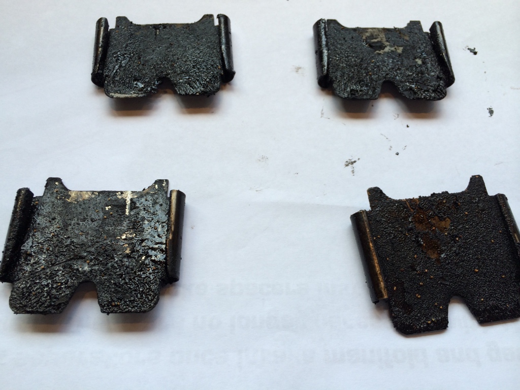

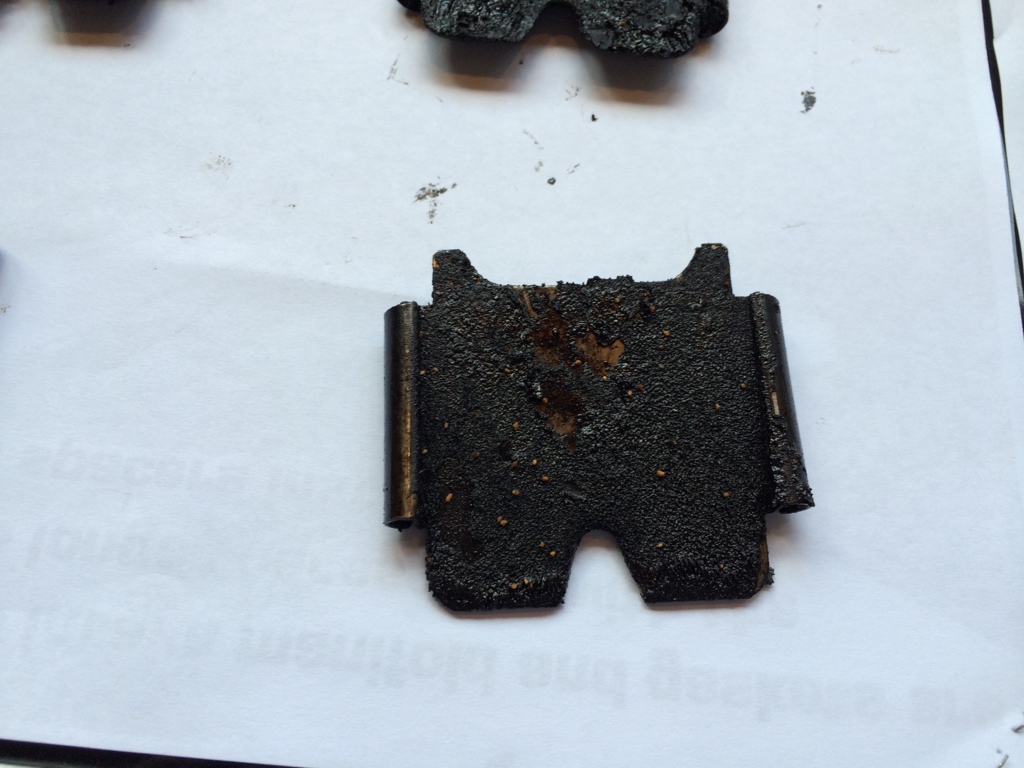

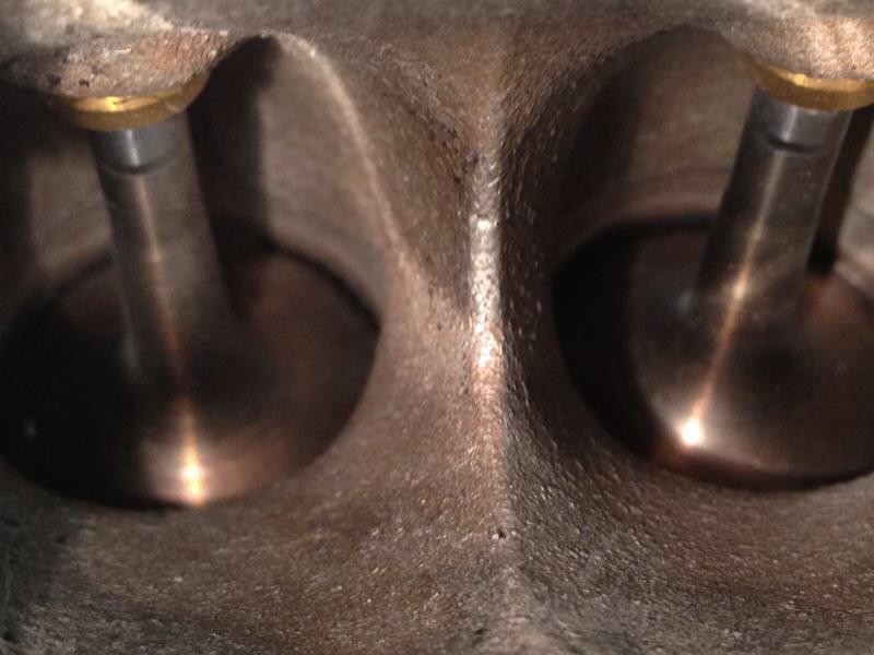

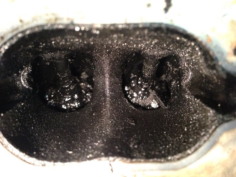

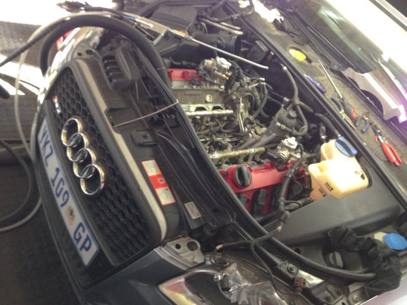

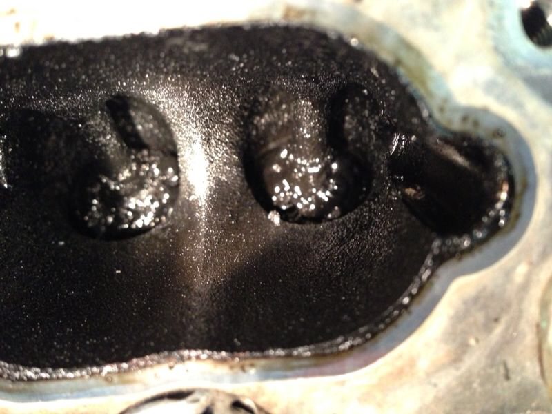

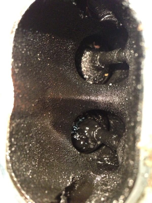

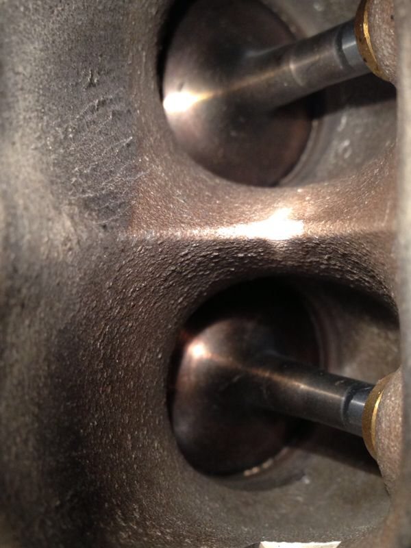

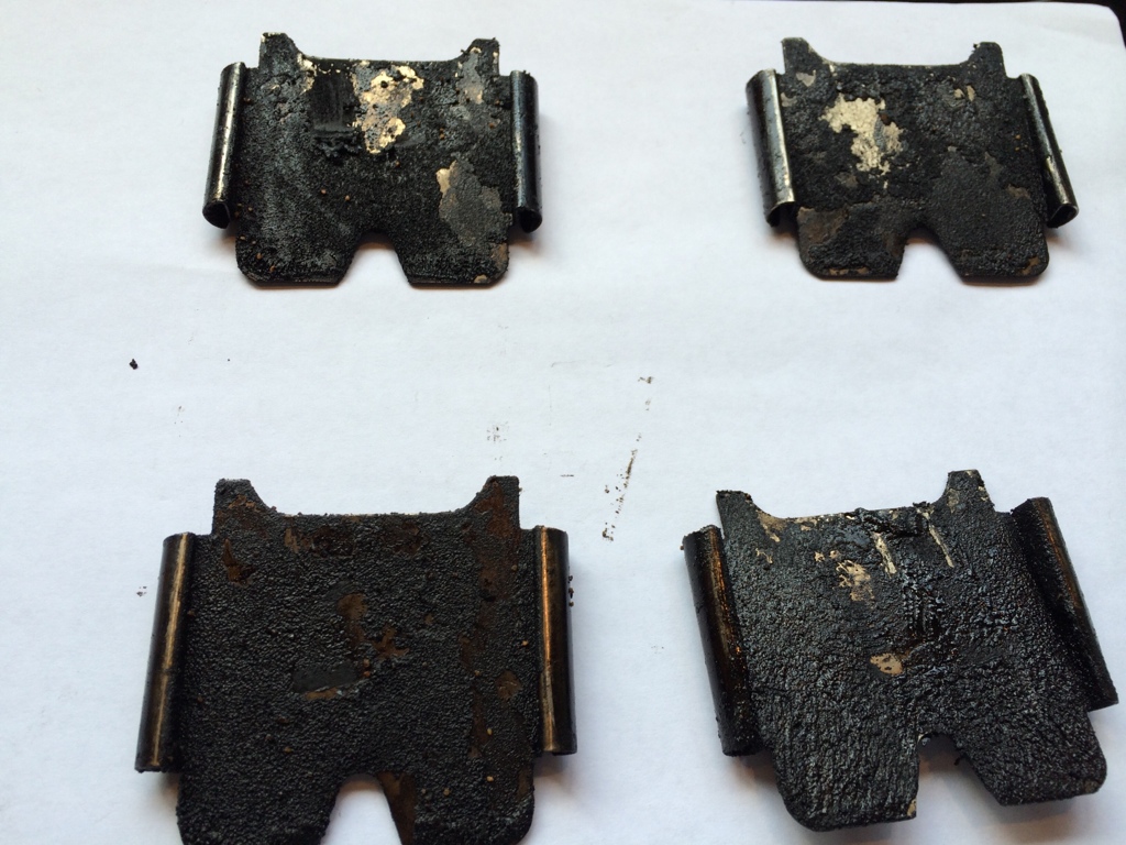

Best "mod"; so far.....is a carbon clean
More pics to come but 63kms on the clock and it was a wet sticky goo mess!
I pulled the port spacers out for good and can feel the low end torque difference already, little mini kick at 2.5k revs and 4.5k now!
She pulls hard right through the range now and my fuel consumption has dropped considerably in just 4 days of driving and I have been pushing it! The whole character of the car is different! If I had known this a while back, it would have been first on my list
More pics to come when carbon doctor pops them over to me
