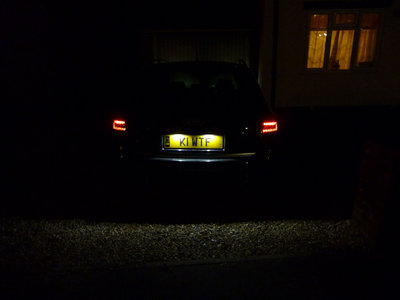

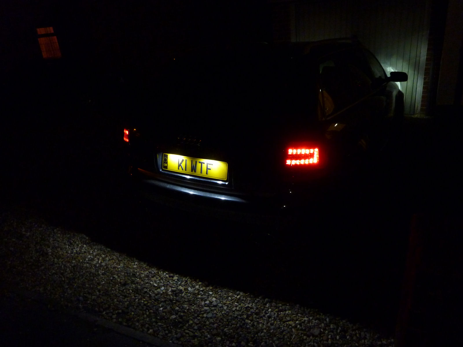

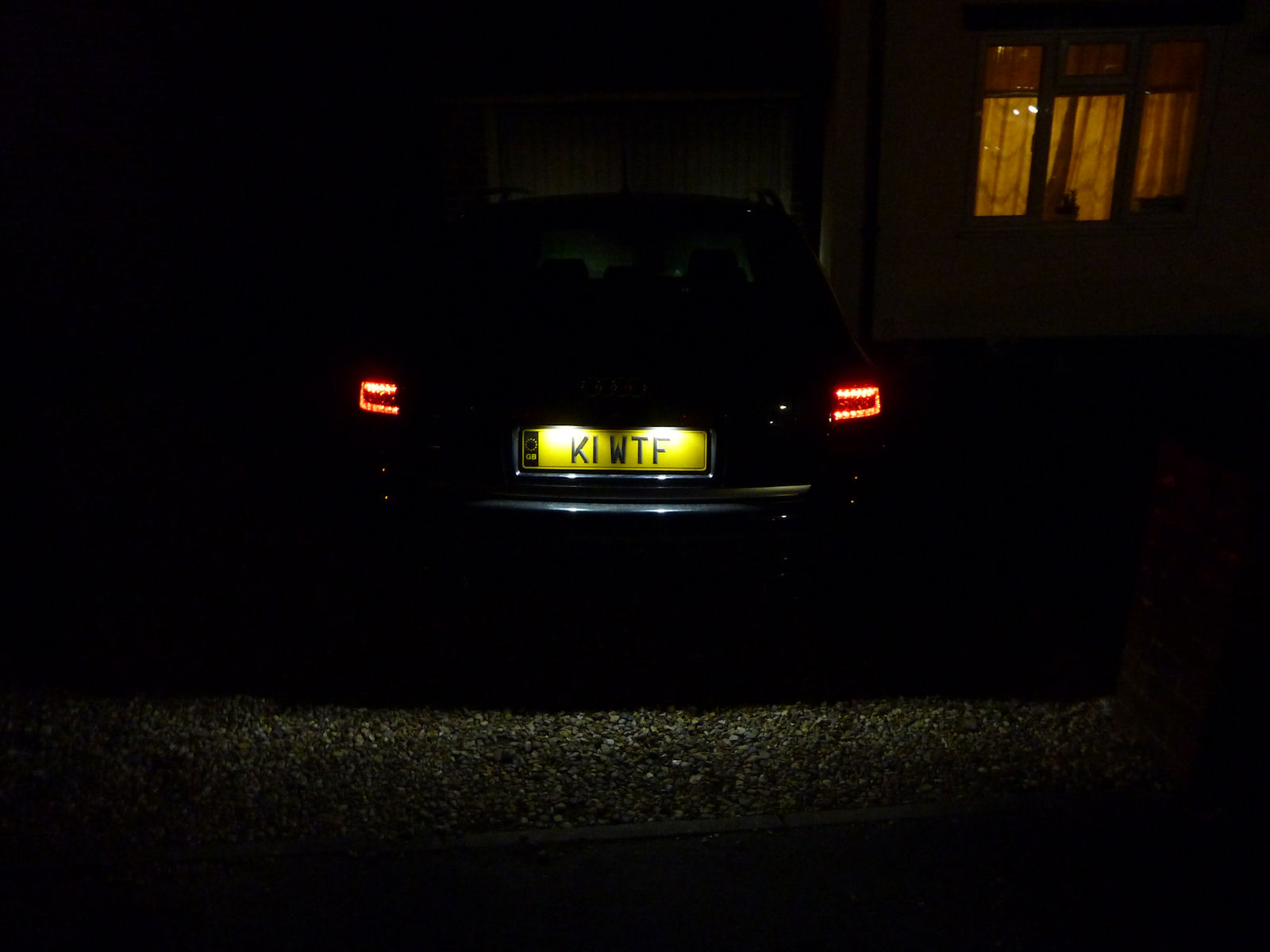

Post by chunky79 » Thu Mar 15, 2012 9:27 pm
Hope these are some help to you young man :thumbs:
Sorry for the crap quality, must sort out settings on my phone :bash:

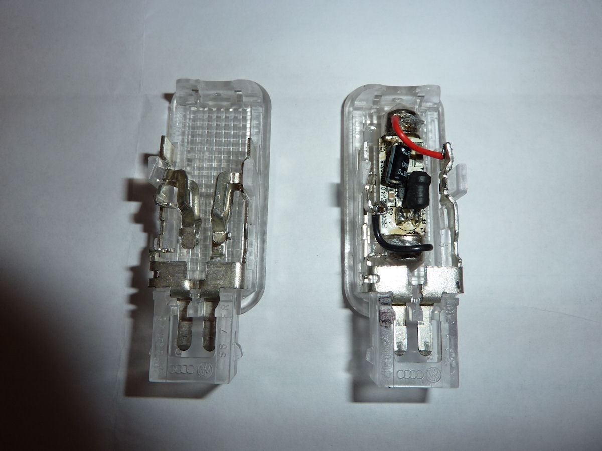

Post by Mr Footlong » Fri Mar 16, 2012 2:51 pm
Thanks :)
Twitching resolved:
Left - The standard one found in the glovebox, passenger footwell, 4 in the bottoms of the doors and 4 red ones in the doors.
Right - same light but with the guts dremeled out and LED soldered in.
Not my finest work and I don't think I can be bothered to do another 8 but I may well do the 4 bottom door ones.

Ok, I had so many bulbs left over that I got mum around and decked her A6 Avant out with new bulb all round instead of returning them. I took the 42mm front double ones out of mine to give her as much light as poss so now need to order some new ones. Thinking I will try some even brighter ones for a chuckle - http://www.autobulbsdirect.co.uk/264-9L ... DSHB9.html - should be the brightest, having 9 LEDs on them or then I could just try these - http://www.ultraleds.co.uk/42mm-festoon ... -2190.html
I both hate and love being so bloody anal about what must seem like the most insignificant thing to change!
I have swapped the numberplate ones to 3LED ones now too.

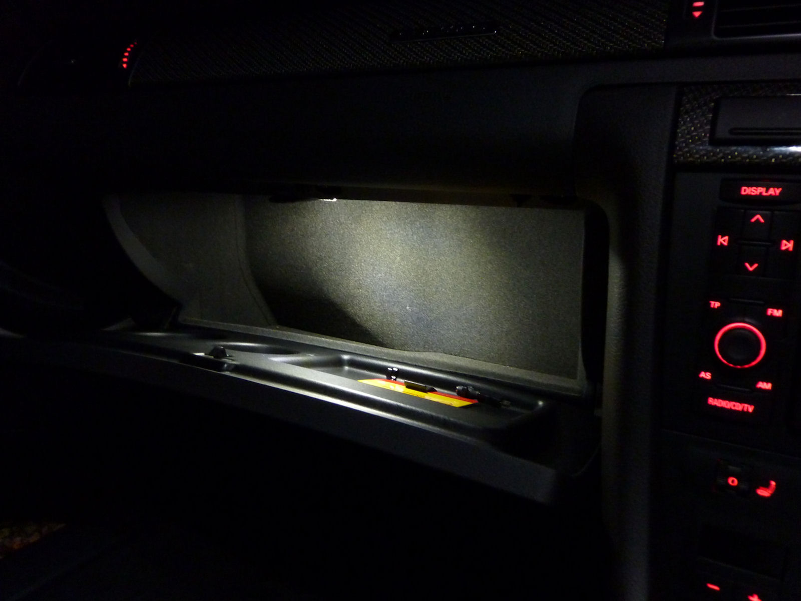

Post by Mr Footlong » Fri Mar 16, 2012 8:53 pm
Another 'fascinating' post, cough.
Glovebox using the light I butchered above
To give a fair comparison in case some want the 6LED ones and want to see the difference, here are the same style photos, but with the 3LED ones in like the other guys
Only doing this to help build a reference thread for this sort of thing. Feel free to tell me to stop and I will keep these silly little mods to myself.
