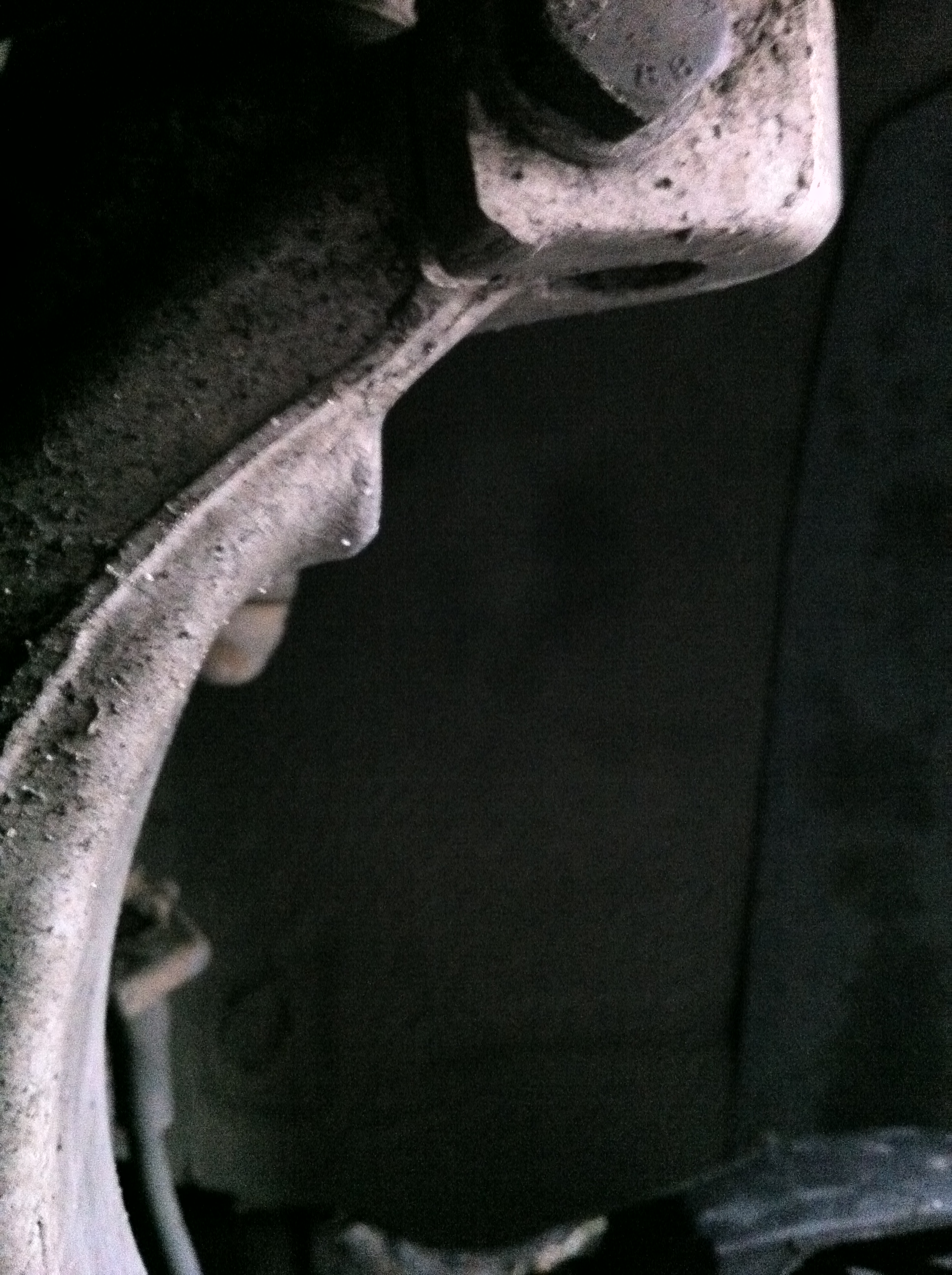

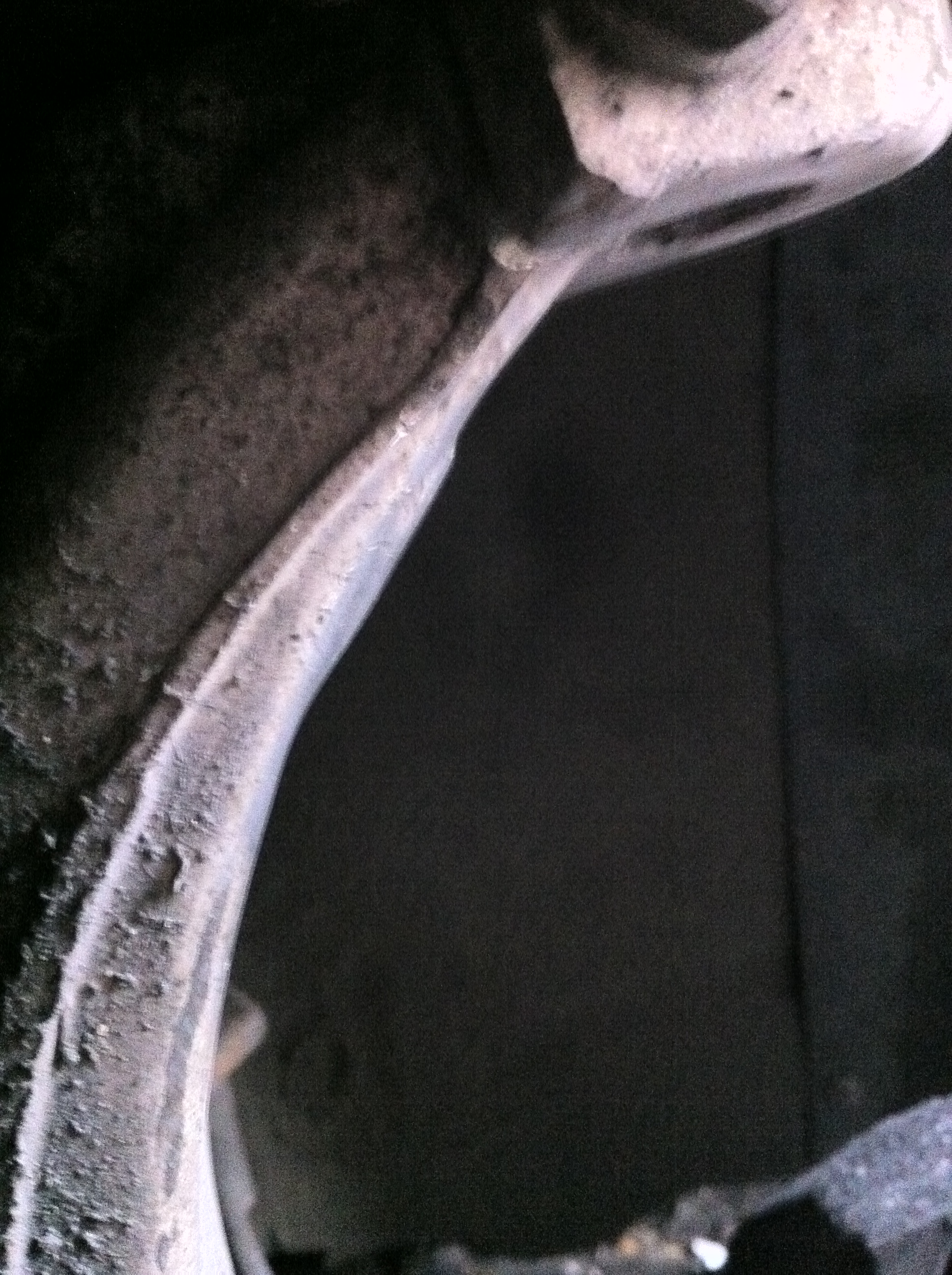

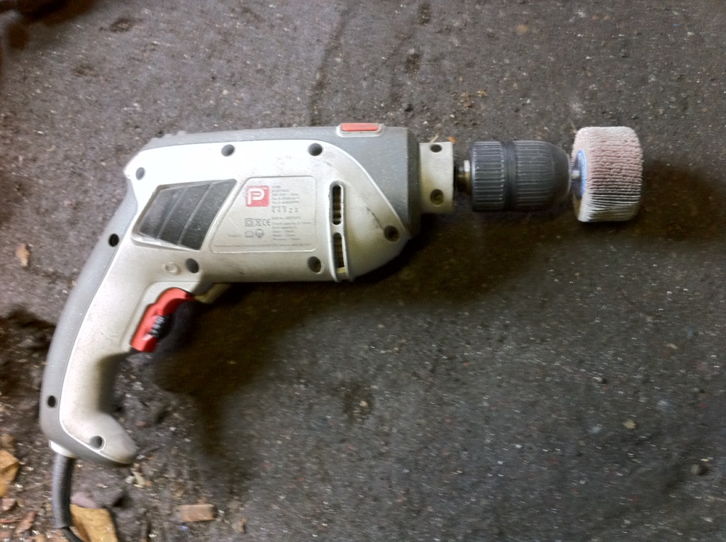

Well the time has come to buy some new tyres and after reading all the advice on tyre fitment on this site, I've decided to remove the knobbly bit on my car to give me some more options. Namely i'm wanting to give the michelin pilot super sports a go after hearing nothing but good things about them.
Anyway here are the result. (excuse the pictures, they were taken with my phone in my very badly lit garage)
Before grinding After grinding The grinder I used. (Well not so much a grinder but you know what I mean) The reason I used this type of flap wheel on a drill rather than an angle grider, is to try and keep any sharp edges down to a minimum to try and prevent any sress fractures appearing.
I'll report back on the tryes once they have been fitted, and I've given them a good run in.
