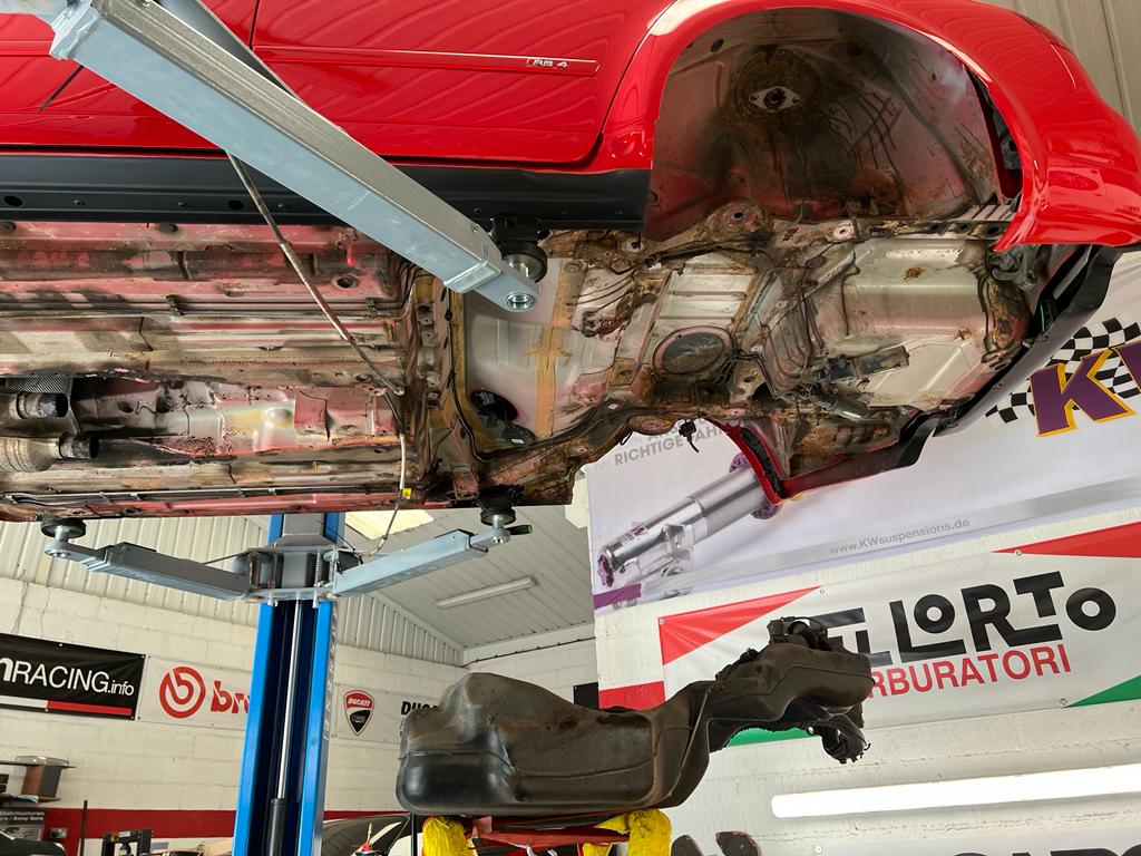

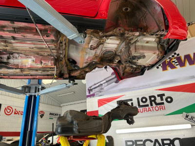

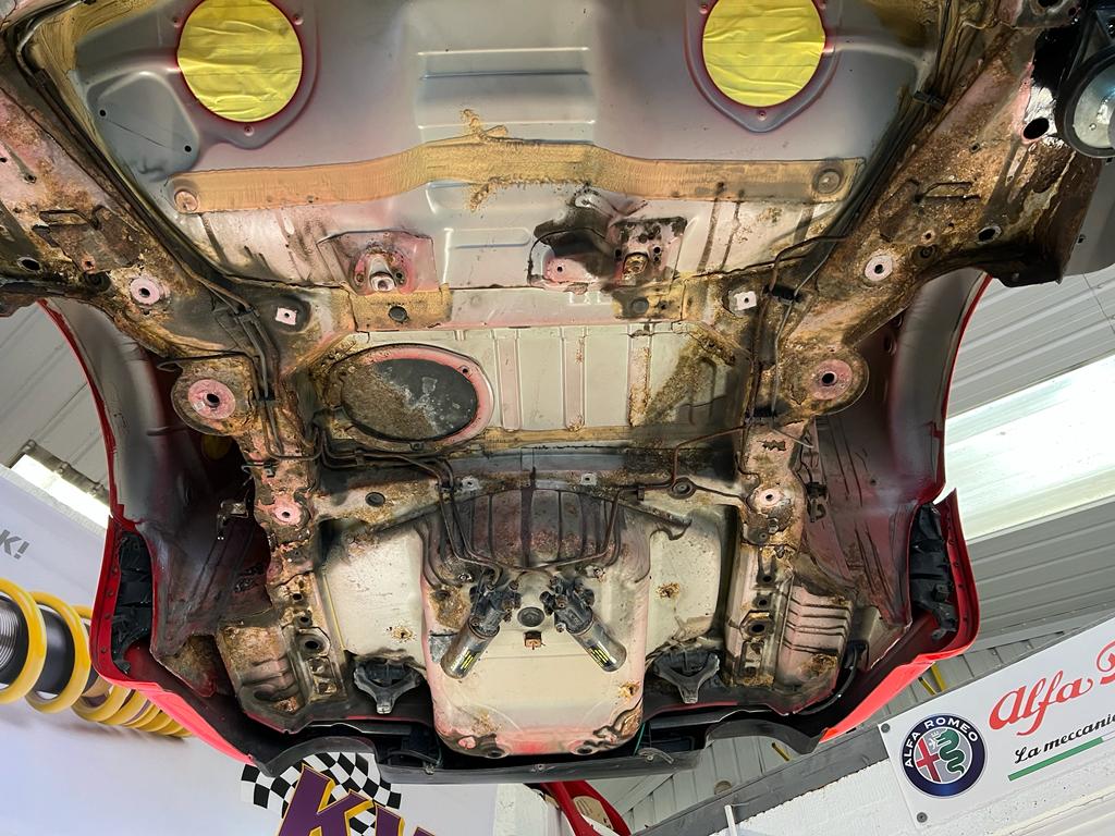

Post by coffey555 » Wed Nov 02, 2022 9:36 am

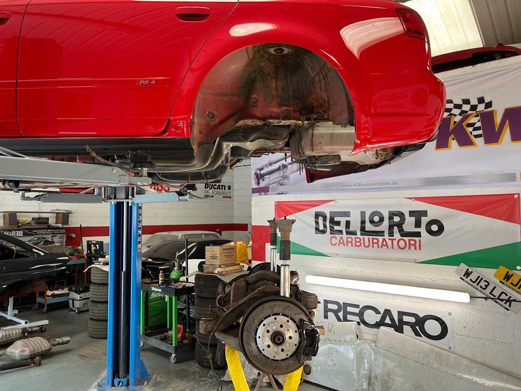

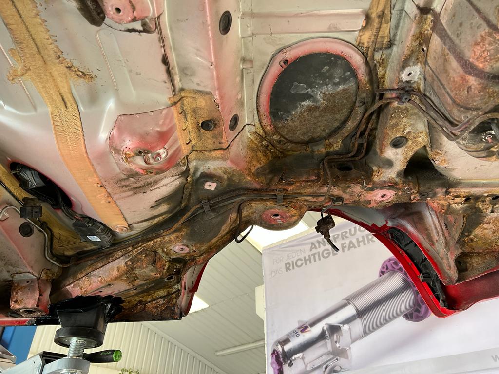

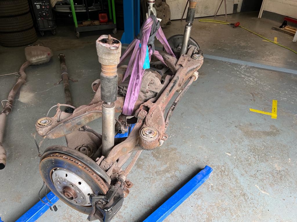

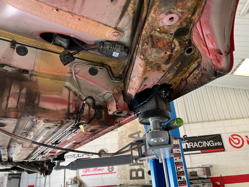

So with the sills and the jacking points fixed (the jack blocks are now sealed to stop them filling up with water again) it was time to get it up onto the ramp to see what else was lurking underneath. Turns out....... more rust! And lots of it :roll:
The plan is to refurbish the existing parts where possible and replace if not.
This is what happens when you use the car all year round in the UK without a garage. With hindsight, under-sealing the car when I got it back in 2011 would have been a good idea. Having said that, I don't regret using it.

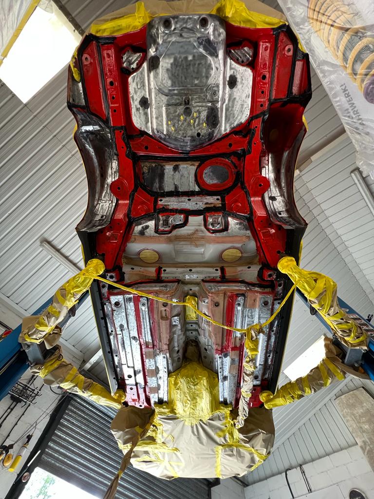

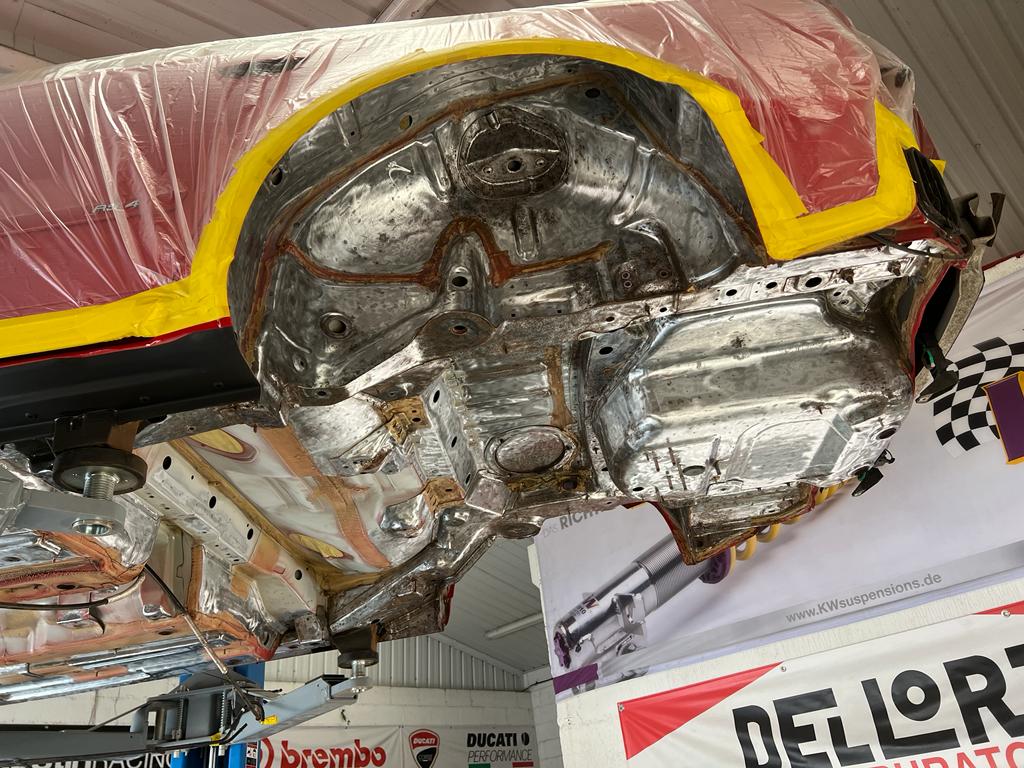

coffey555
Posts: 1147
Re: Martin's RS4 B7 Avant Build

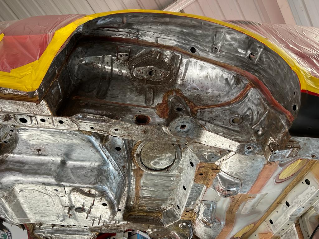

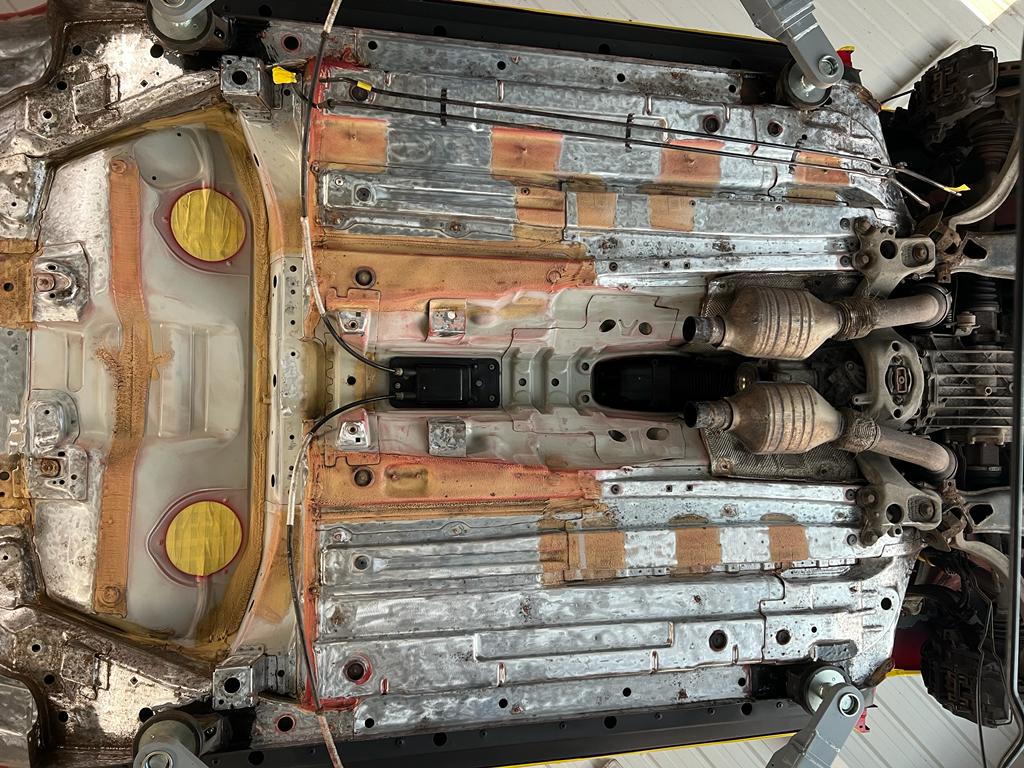

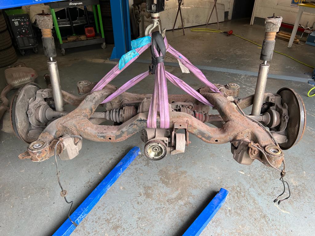

Post by coffey555 » Thu Nov 03, 2022 6:26 pm

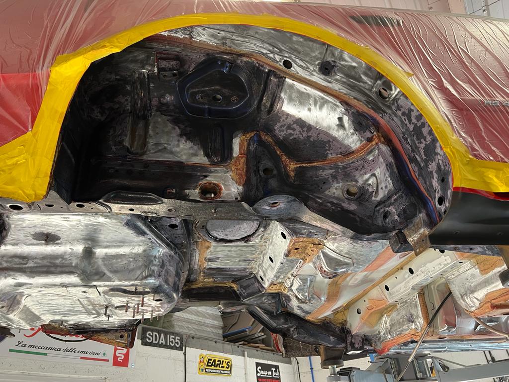

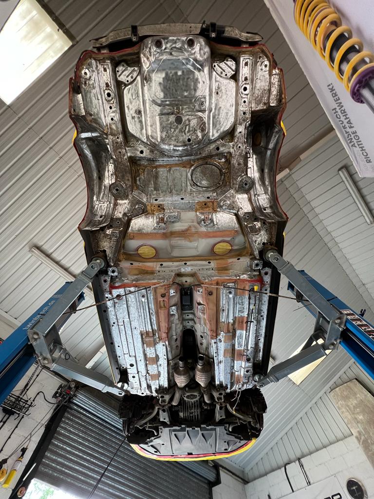

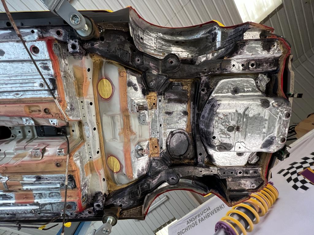

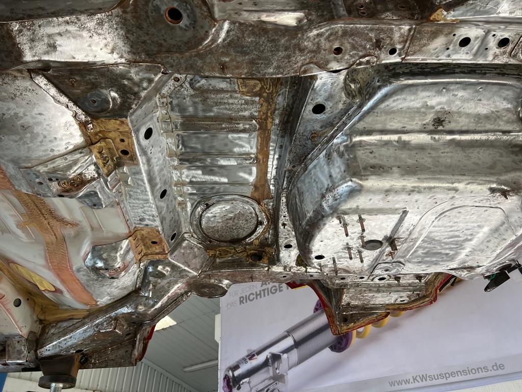

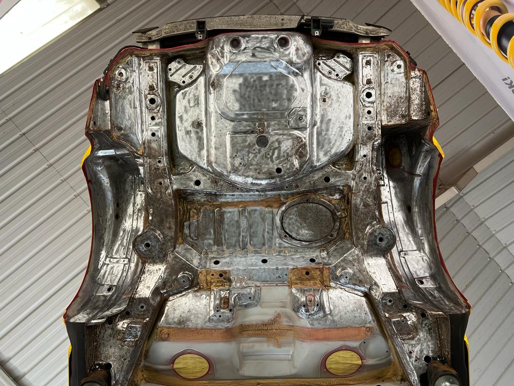

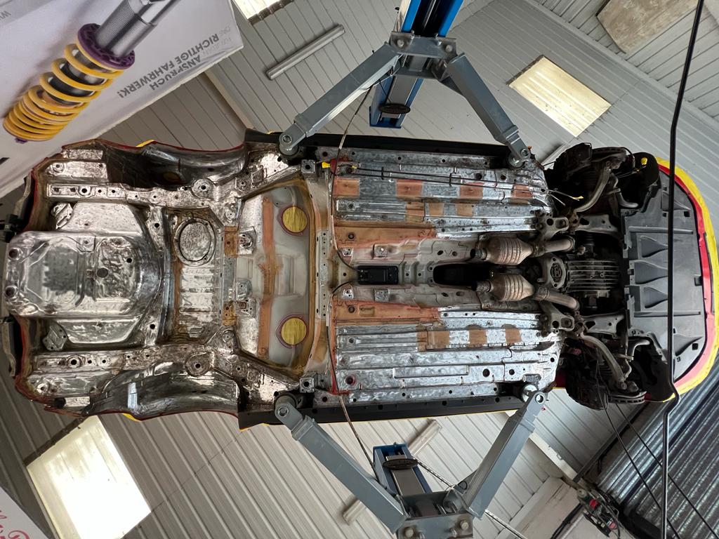

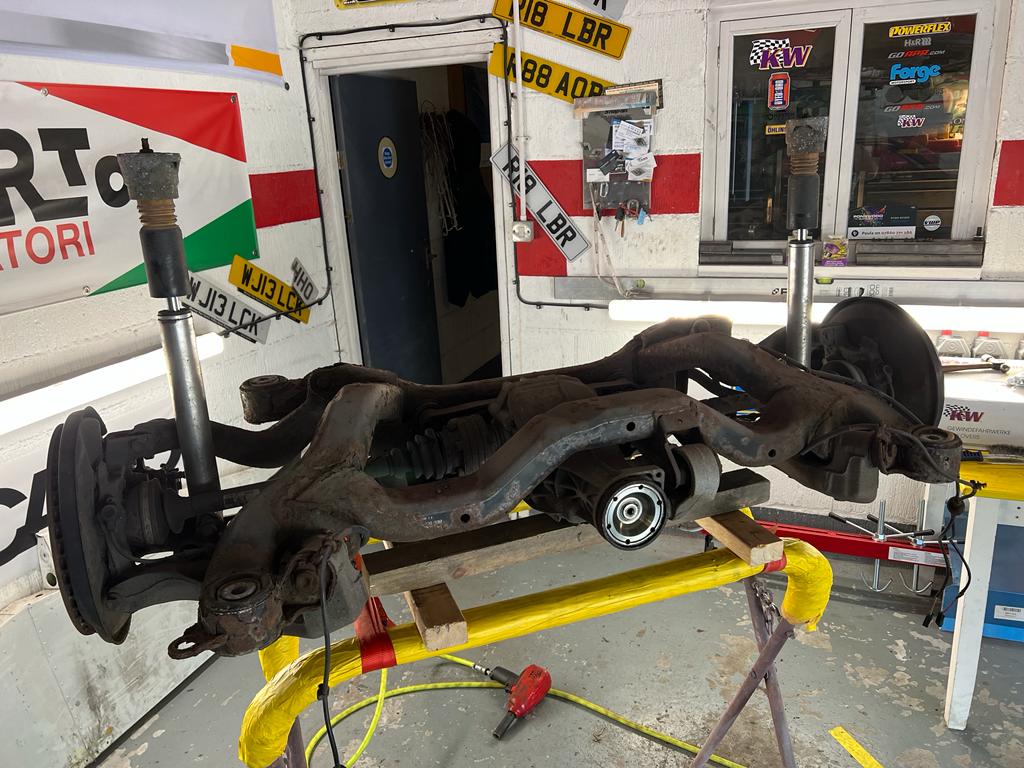

With most of the parts removed from the underside, everything was stripped back to the bare metal, de-corroded and then acid treated, before being sealed.
I hate to think how many hours this took but at least it has been done properly! They mentioned that there were a few bits of minor welding to be done on the rear but overall it was mostly just surface rust.

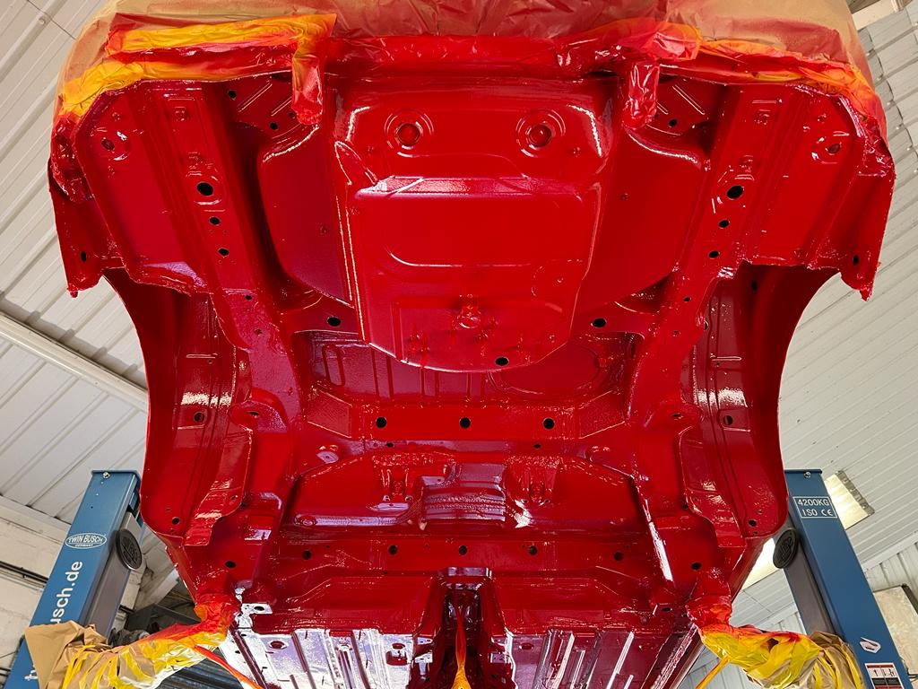

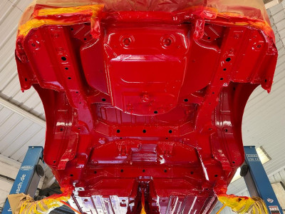

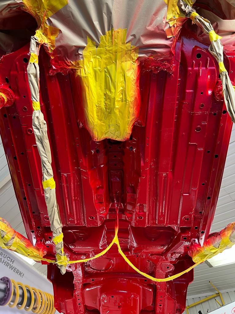

coffey555
Posts: 1147

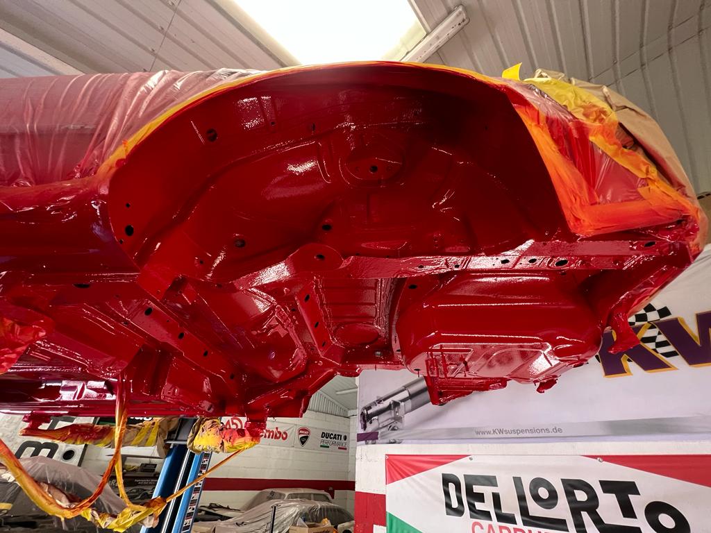

Post by coffey555 » Sat Nov 26, 2022 6:25 pm

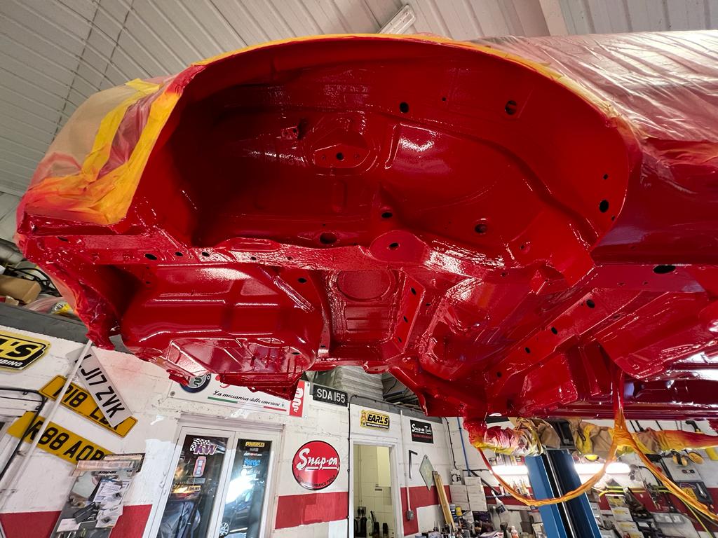

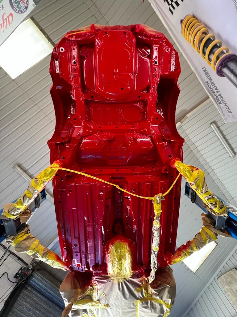

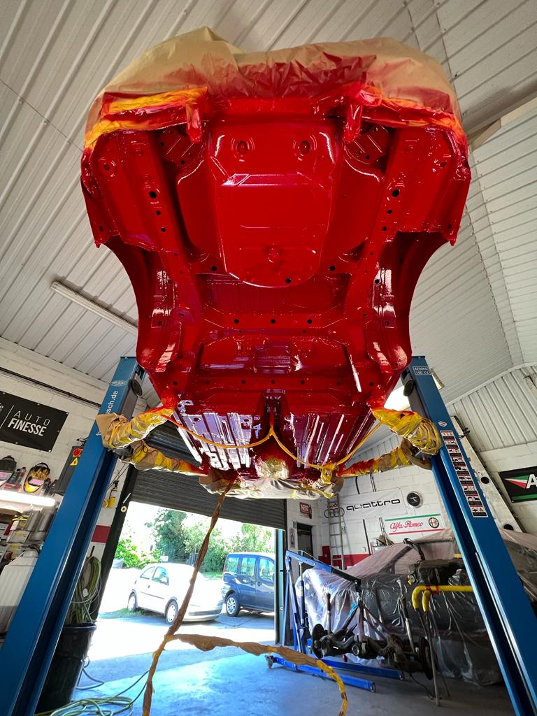

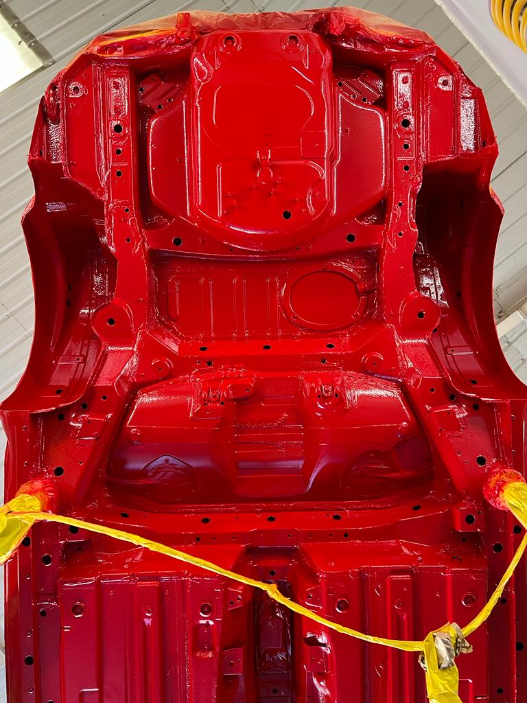

With all the corrosion removed, the bare underside was then treated with mastic epoxy followed by body colour and then finished with clear coat.
Hopefully this should keep any rust at bay for a few years.
Misano Red RS4 B7 Avant
