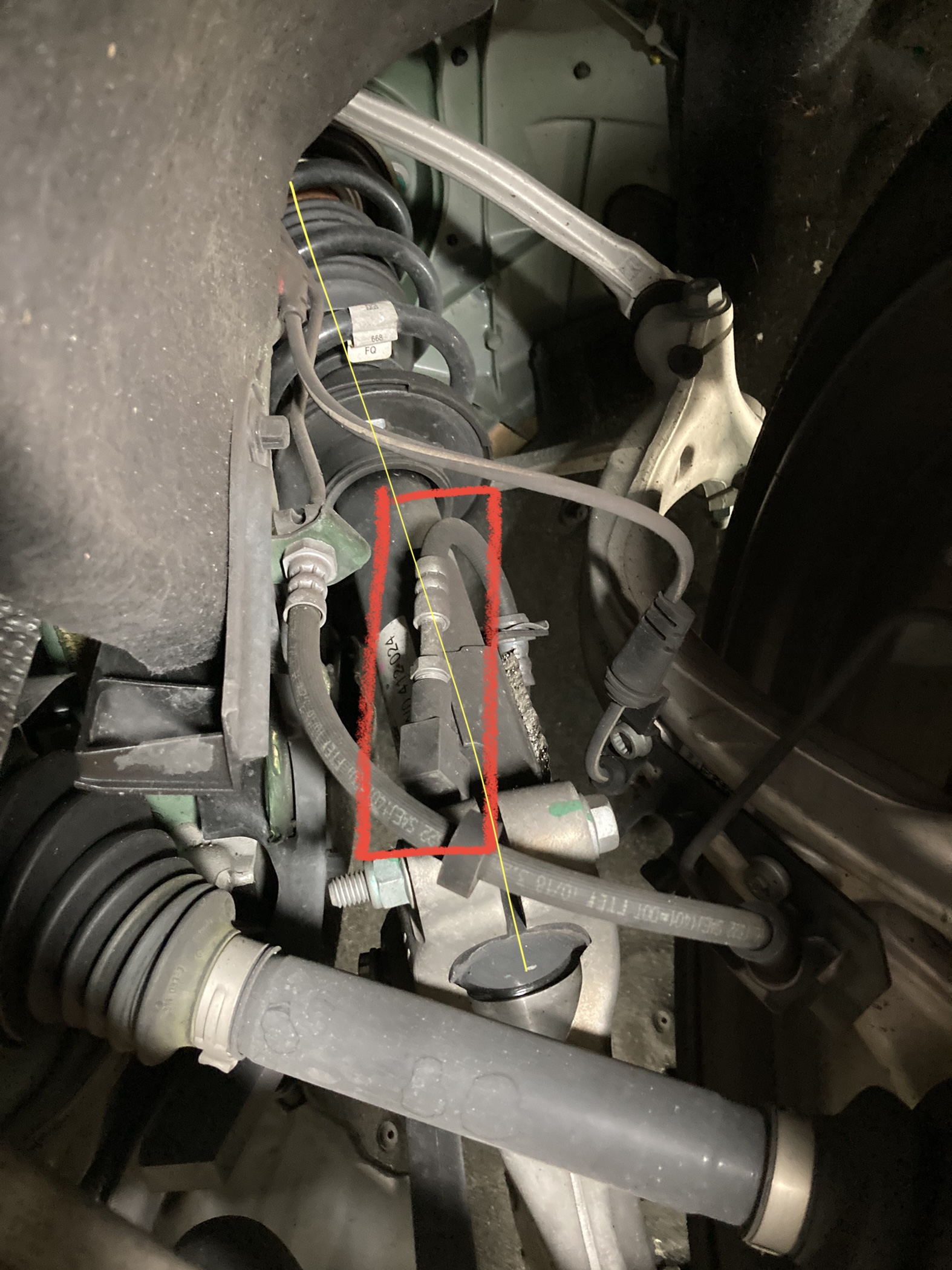

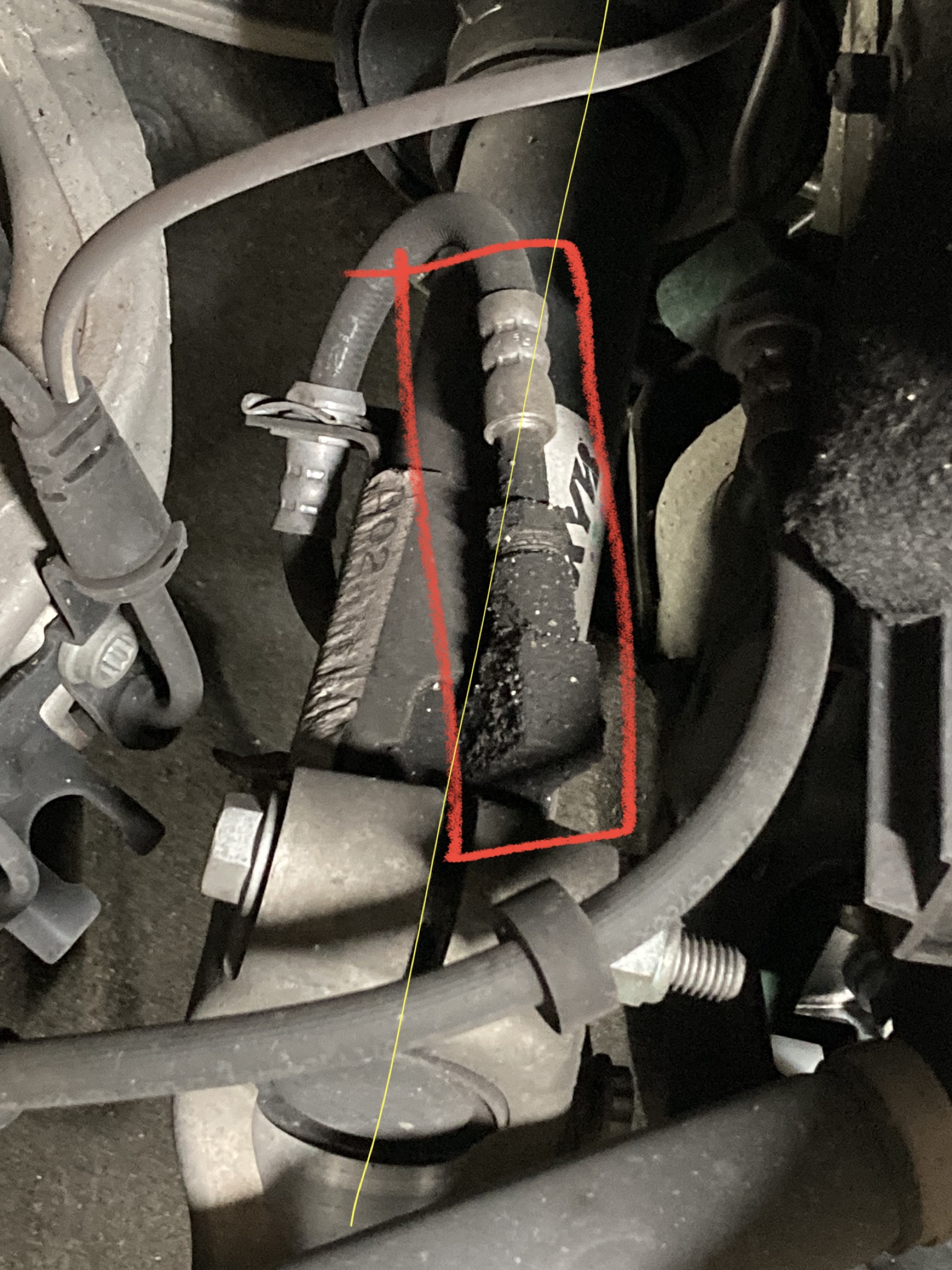

c99 wrote:
Fri Dec 04, 2020 8:53 pm
I have my car back, there was small leakage on a hose near rear left shock absorber and due to low pressure for longer time there was bad actuator too. All done under warranty
I have something 'similar'.
Several months back I walloped the front passenger wheel - running over a tire stop in car park at speed. (Don't ask).
Apart from the wallop, everything seemed ok at the time, ....until recently I notice the knocking in rear trunk, which I now have learned is one of the 2 DRC Accumulators.
I've been left to understand that affected Accumulator to FR-L/RR-R circuit should be fine, since leak is observed 'at FR-L shock'. The latter needs to be fully replaced according to Audi, not just the hose & connect portion, [and then the circuit vacuumed, filled and 'balanced' to the diametric opposite FR-R/RR-L circuit].
The cause for DRC leak in my case seems different to most, but sharing FWIW ......in case anyone else walloped their DRC shock :) .....and later developed Accumulator rattle;)
RS4 DRC FR-L showing WITH leak
RS4 DRC FR-R showing W/OUT leak _ref only
DRC schematic _ RS7 ref only

If pressure drops, for whatever reason, the valve / accumulator will eventually fail too. So if pressure low and leak / damper repaired you need accumulator too.

Markp wrote:
Fri Dec 11, 2020 10:28 pm
Thanks for that feedback. I don't want this to end up being an in&out and then again in&out 'boomerang repair' job :(
I'll push back at Dealer to see whether they also intend to replace Accumulator, or if not why that seems to be unnecessary?
I note comment by 'c99' above also, which aligns w/what you are saying.
R.
