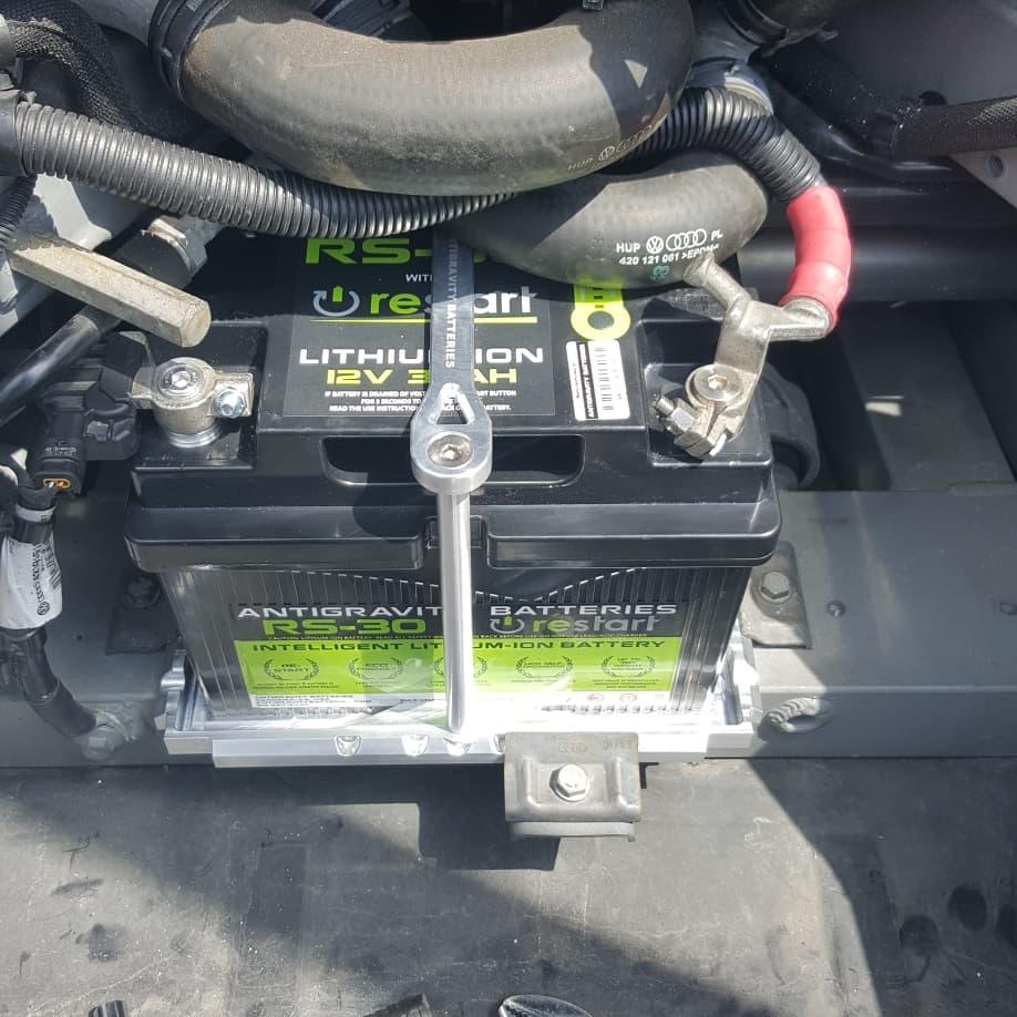

Post by Speedr8 » Sun Jul 22, 2018 4:39 pm
Hi
Something new bought.
Tom
Covkiller
Posts: 2349
Location: Coventry
Re: light and strong Audi R8 V8
Post by Covkiller » Mon Jul 23, 2018 6:57 am
Good move strapping the battery down; "Antigravity" :bigblink:
classba
Posts: 1814
Post by classba » Mon Jul 23, 2018 9:38 am
Tom... you should had also bought their dedicated mount :)
