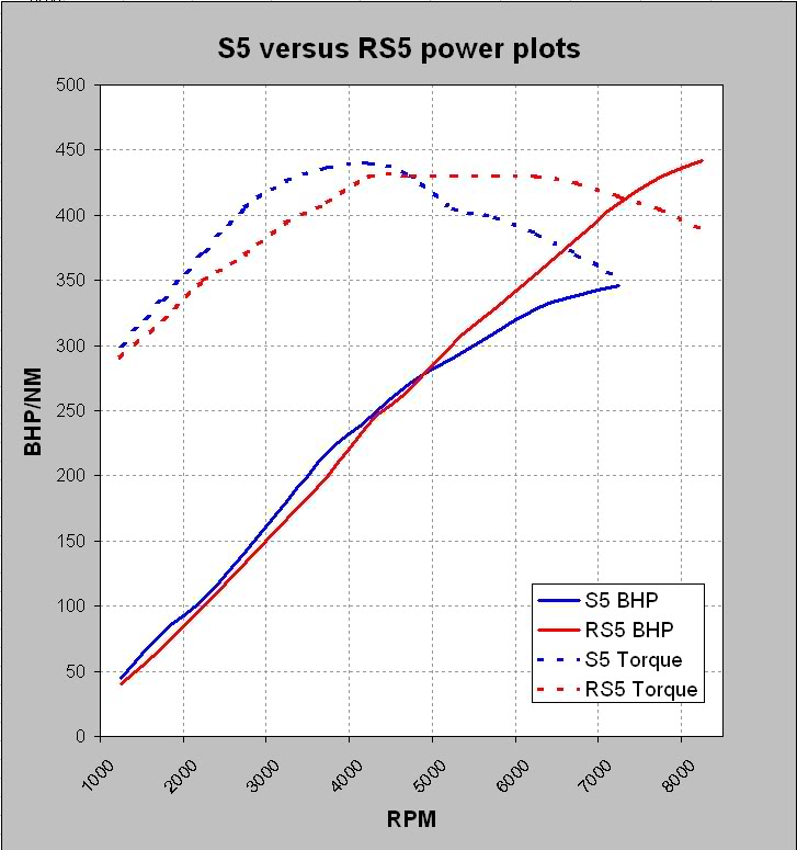

RS5 dyno curve
RS4 > 400 Nm 2500 to 7000 ~ 4500 rpm band
RS5 > 400 Nm 3500 to 8000 ~ 4500 rpm band, just shifted up
HP at 7800 RS4 = RS5 ~ 420 PS, RS5 might be a bit higher (10 HP), better breathing due to the air boxes
HP @ 7000, identical, 400 PS
6000 RS4 360, RS5 345
5000 RS4 290, RS5 280
power difference 8300/7800 x 414 ~ 440 HP, almost exactly the rating
a couple more HP due to less pumping losses, better breathing...
no magic here
