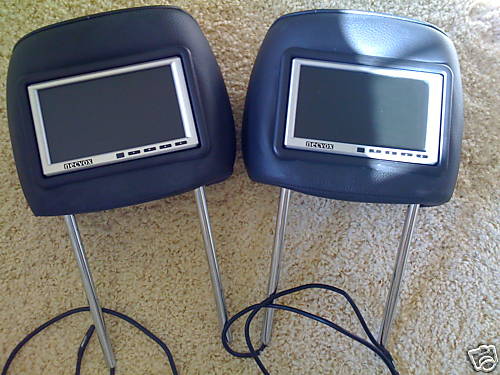

Picture shows the headrests and the Kuf bought is the one in the link from this thread.

It's still not clear what the inputs to the screens are. Do they have separate boxes? In the photo it looks like the screens have got non-standard connectors on the end of the cables. Difficult to see. Are you sure there's no box that comes with them? Have you got a manual for them?
My alpine screens have a video out as well as a video in. This is so you can slave the second screen of the first. This means that I was able to connect the 1st alpine to the DVD player, then slave the 2nd screen of the 1st and slave the head unit of the 2nd. This avoids the need for a splitter. Maybe your screens will be the same.
If not then you'll need a video splitter because your DVD player only has one AV output. Something like this:
