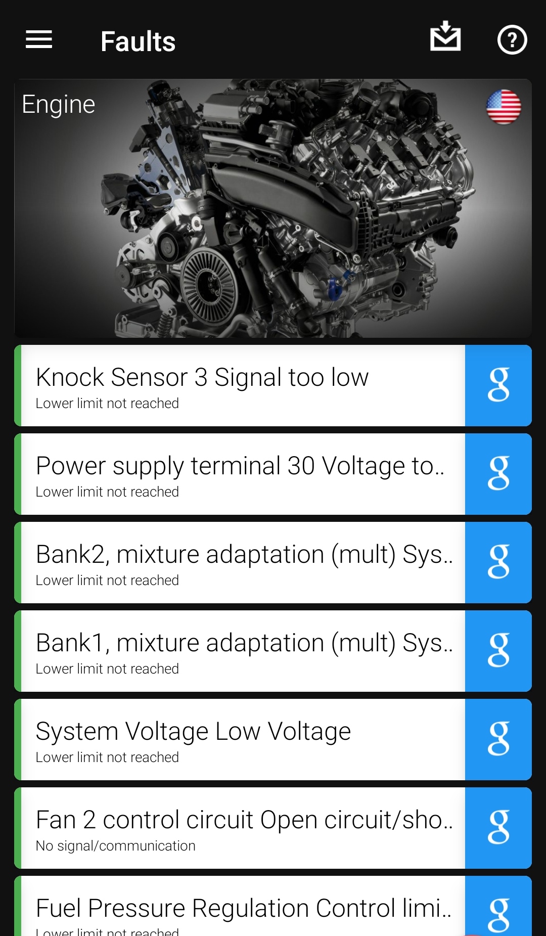

Opinions on this?

No VW fault code numbers?
Are they current or intermittent? Is this what's come back when you've cleared the fault codes?
What fuel pressure regulation?
What scanner is this?

Nothing came back but i found the reason for running reach... Massive air leak from around the left intercooler

Ah, OE intercool. I OE, therefore I leak.

Intercoolers are not great true but once we got the car on the lift it was all clear. Bank 2 turbo pipe popped off. In 10 mins it was back on secured. Car runs like a bullet now (remapped by Unit20). It's time to hit the road back.
