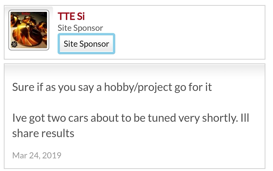

I would also have to agree that something is not right since it's been almost half a year without any tuning results. This was more than a month ago (from another forum) so I don't think you are the only one.
Quote

Post by S4Player » Mon Apr 29, 2019 2:26 pm
zex wrote:
Mon Apr 29, 2019 2:13 pm
I’m the only car mate 👍🏻 There was meant to be a set On a German car, it never materialised. Pretty sure there’s an MTR car in Germany about to install them though. There’s also a french guy who’s doing a set but he’s waiting on my results before deciding to switch from the 850’s. He’s the lad who’s car done 235mph verified on the autobahn. You only need to look at TTE’s track record and results to know they will get the turbos right 😎
