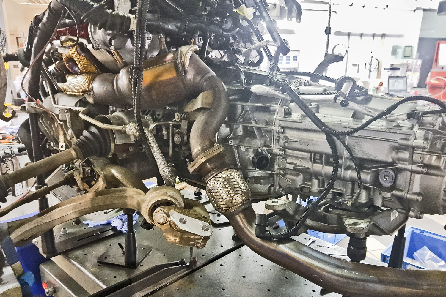

With the centre resonator section fitted, I'm sure you can still have that low down grumble with valves open. It should just be quieter around town and less raucous at the top end.
Providing there's a Catalytic Converter fitted and the car passes the MOT emissions test, the car will be legal with Sport Cats. The trouble is replacing them, they're part of the exhaust manifold and the engine has to be dropped/lifted to gain access. I had a good look around when my engine was replaced :nodder:
click image to enlarge
RS4 Cat

Look at that beast in all it's glory Image
Yeah they're pretty high up. I was wondering why MRC were charging so much for that. Can't seem to find pricing on the sports cats. Any ideas? Milltek only showing the 3 full systems. Would they mate ok with your Akra?
