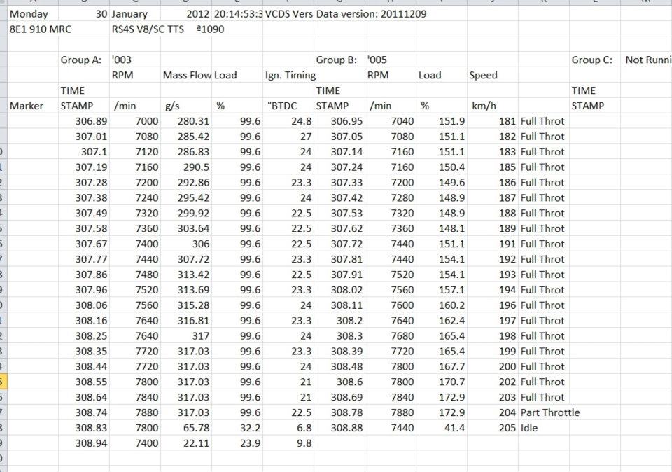

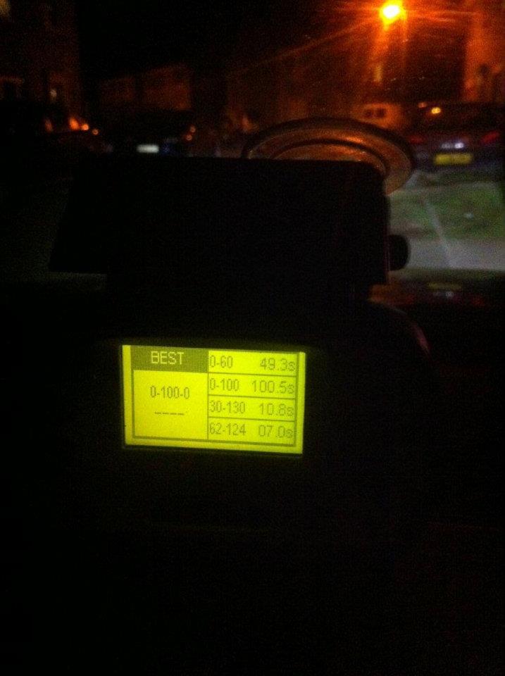

Ideal night for some times:
-2 degrees C. Coasting at 4k to get stone cold intakes and 100kph is right at peak torque in 3rd and 200 kph is right at peak power in 4th. Flat shift from 3-4th.

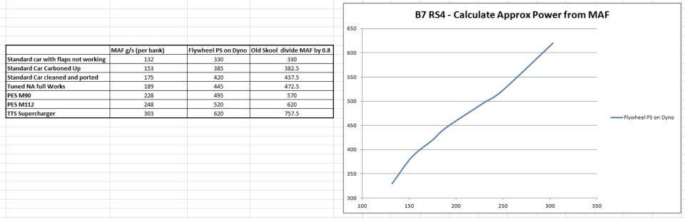

A log of how much air the TTS kit flows is attached and a very rough comparison of maf vs power we have collected.

Doug - what is the time for a std car for the 100-200km run ?

Post by MortenJuul » Sun Sep 23, 2012 8:10 pm
Doug_S2 wrote:Ideal night for some times:
Hi Doug
Looks like the flow is around 317 g/s at 7700 RPM - Is this due to the limitations in the air feed?? - Looking at the specs of the C38-91 it should be able to flow 630 g/s??
Is this close to 12000 rpm(input shaft) (pully size?)

Post by RS4POWER » Mon Sep 24, 2012 1:37 am
Hi Doug
That's 317g/s per bank.
