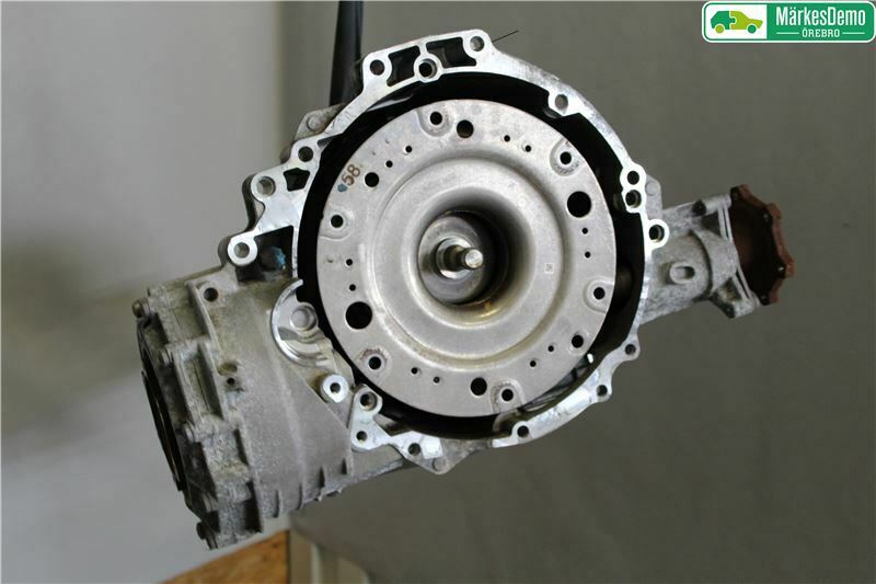

Here's a 6HP26 (the RS6 'box looks like this):

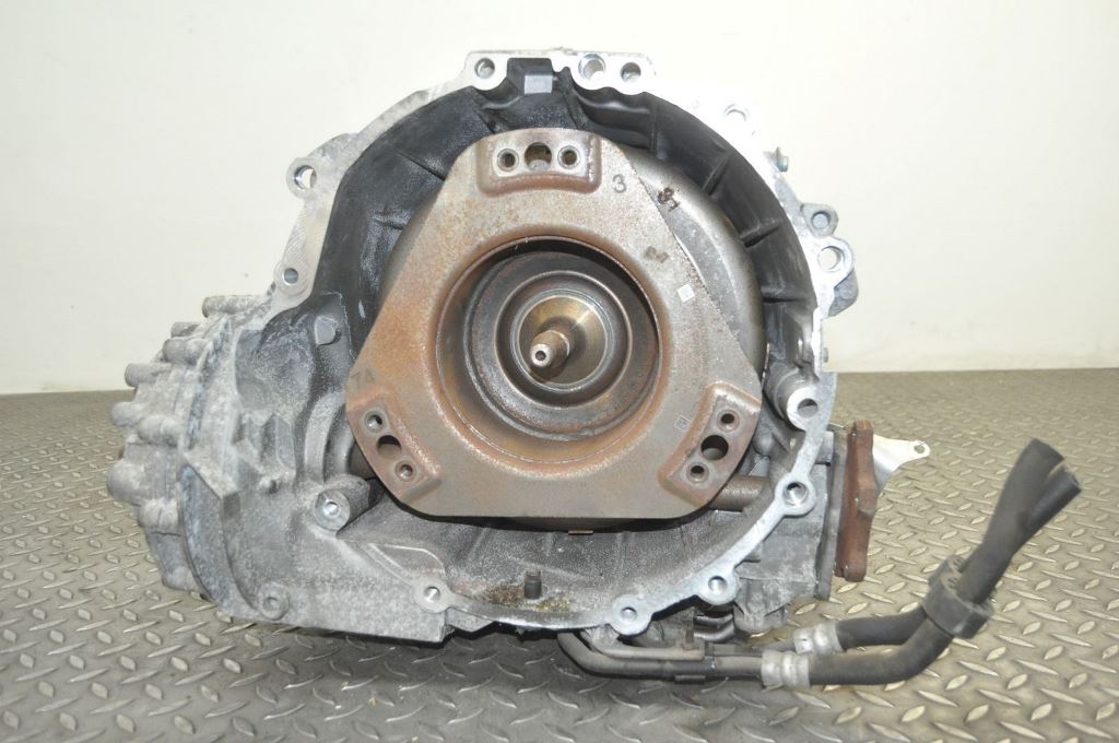

And here's a 6HP28 (this is from an A8, not an RS6):

There may well be a cut off point in 2008 some are 26 some 28
My 26 looks identical to ATinOf’s 28
The 6hp28 pictured above does not look like the 28 in the c6 rs6
Front diff and torque converter look different?

No that image of Nicks of a 28 looks nothing like it, ELSA lists 6 flavours of the 6HP28 for the C6 RS6, all of them use the 09EA base-code, so I expect they all use the same outer case casting, which is NOT the one above.
The flavours are KBD, KUE, KZH, KZQ, LLJ and MKT.
Your options Sticker in the boot should will tell you which is yours.
In big letters 2 lines above the matrix of option codes will be the codes for the engine (BUH) the rear diff (HNL) followed by your gearbox (KZQ for mine)
