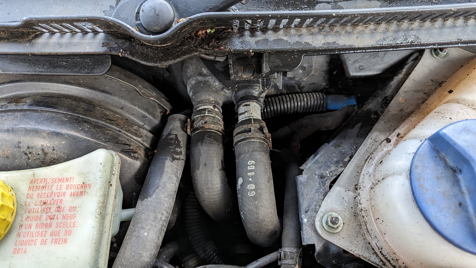

Checking her over again this week I found that the expansion tank was totally empty, so have only done a bore lubing crankover and not fired her up. When I removed the scuttle to check over, I noticed the pipework from what I assume to be the heater matrix looking like this -
Note the right pipe especially. It is still partly on as the barbs are quite long. Sadly I think it is a stretch to hope that the coolant leak is coming from there due to the height, but of course I didn't know about it when the scuttle was on and possibly the pressurised system as the engine was warming could have been pushing the water out of there.
Anyway, waffling. Regardless of that, I want to refill the system, jack the front to get her level and have a look underneath with the tray off. It is a sloped drive with drainage just in front of the car, so I had no visible idea of when/that she was even leaking.

To bleed you pull one of those heater matrix pipes partially to expose a small bleed hole. Can't remember which one. I've never needed to bleed mine, even after draining the coolant.
Like you, I also think it's unlikely this is the source of your leak, although if the system isn't pressurised properly you can lose coolant through boiling / evaporation. Depends how long you were running it for. Maybe you're like me and start it to warm it up then go off and do something else only to remember an hour later that you left the car running.
Usually it's the stoopid plastic pipe in the oil filter housing that causes this kind of fluid loss.
You could also check for fluid under the carpet in case the heater is leaking.

For the amount of coolant missing from the tank, if it was the matrix I would expect to feel that amount of water through the carpets without lifting them (already checked that, but I will do that once the weather permits.
I heard talk about a pipe that snakes around the back of the engine being a strong culprit (engine out job?), but I have no clue about the oil filter housing one, do you think that is something in my skillset to replace if I find it is that? Cheers.

Could be the pipe around the back of the engine. Better hope not. It's not very likely I think.
Could be the seal on the coolant temp sender (which is located on the pipe in question).
The carpet underlay is so thick that you'd probably not feel any wetness on the surface of the carpet unless there were litres of it.

Yes, this pipe can corrode. But based on what you've shared about jobs the car needs (turbos & box), I'd recommend any buyer just gives it a good going over which'll include engine out, and then do all the big jobs in one go. Easier that way. Bufkin pipe, gear selector switch, EGT sensors - just give them all a good check & refresh while the gearbox and turbos (I think I remember you said they need refreshing?) are being done. You'd be on a hiding to nowhere to replace that pipe but then not do the other engine our jobs at the same time. However, just for sanity sake, shine a torch vertically down the OS rear of the of the filter box. You can see the black "snake" pipe there - and it has a bolt on the top of it. If that bolt comes loose, you loose coolant, it's one of the bleed points, generally it's the one that needs doing. The heater bleed point (which is behind the scuttle panel, just inboard of the coolant header tank) rarely needs touching.Mr Footlong wrote: ↑Tue Jan 10, 2023 12:01 pmI heard talk about a pipe that snakes around the back of the engine being a strong culprit (engine out job?), but I have no clue about the oil filter housing one, do you think that is something in my skillset to replace if I find it is that? Cheers.
Also then shine torch, still on the rear of the airbox, but on the near side. That's the main temperature sensor, which again, can corrode a bit around and leak. If the leak is there, it's fiddly, but doable to do in-situ.

I tried pulling off the already lifted heater matrix pipe, but with there being some flex built into the barbs, I wasn't happy with applying too much force to what feels like semi-loose pipework through the firewall to the matrix. Opened up the expansion tank, then opened the bleed valve. Lovely pink coolant gushed out, so I quickly closed that back up, didn't leave it for long enough to see if the tank level started to drop. Obvious thing to do is to open that valve again with the tank cap closed, non?
If memory serves, when I noticed that the coolant level was dropping back on the October fire-up and driveway idle run, I think I wasn't getting any heat passing through into the cabin (normally cranked the heat up on AC to help dehumidify). I think that may have prompted me to pop the bonnet and look at the expansion tank etc., I just can't remember.
Bouyed on by the coolant pouring out of the bleed valve, I connected the battery, gave her a quick bore lube crank and then stuck fuse 29 back in. I fired her up, started on a dime as she does and let her run for 60-90 secs. Didn't notice the coolant level drop in that short time, but could that be related to the thermostat being closed? Not terribly knowledgeable there...
