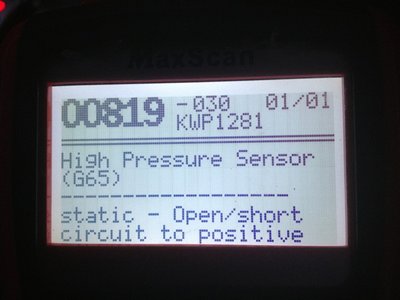

Post by Russellj80 » Fri Mar 01, 2013 9:05 pm
Yeah I have a Vagcom but it's not a high end one. .. Good enough though I reckon?
I've tried erasing the code but it's back instantly as soon as I check again. It says 00819 (G65) high pressure sensor static - open/short to positive

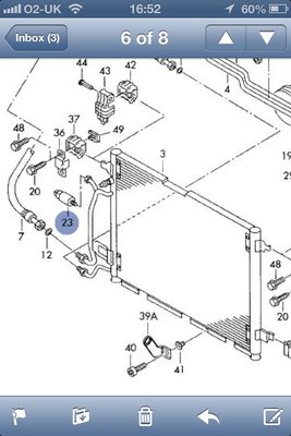

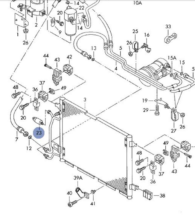

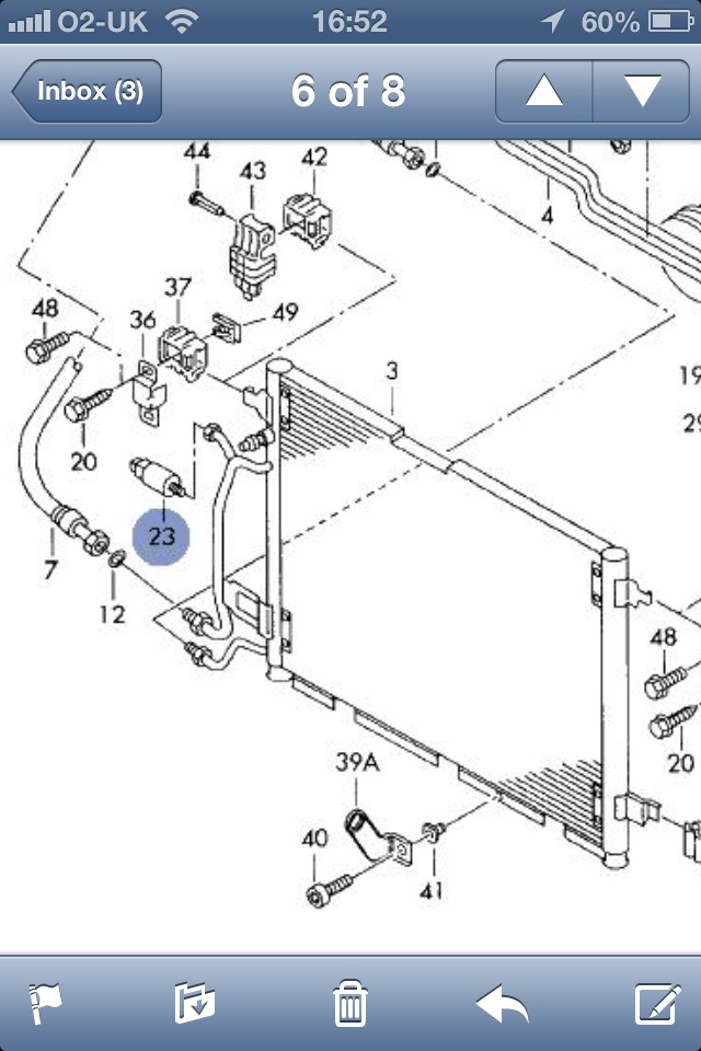

Post by Russellj80 » Tue Mar 05, 2013 6:04 pm

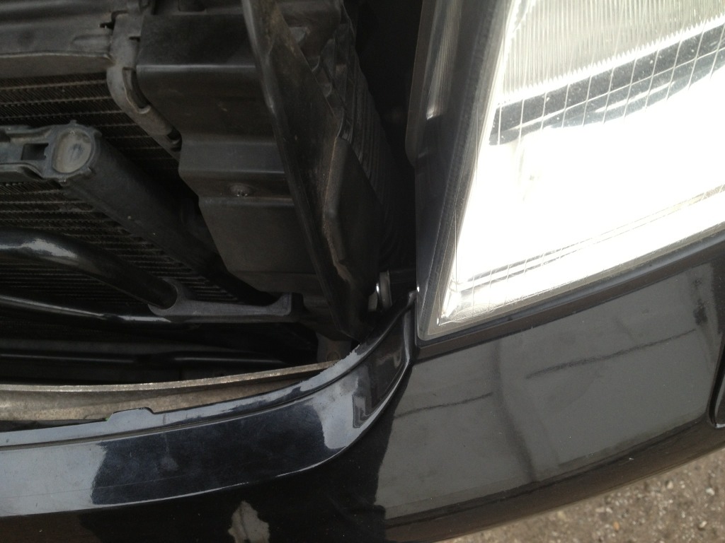

For everyone else's benefit ill put up a few pics. I should have taken some pics while doing it but at least you will see the location. Bearing in mind this is an "03" plate RS6.
Also the very helpful man at Audi sent me an exploded diagram of the A/C system which I'll put up as well. Looking at the diagram it looks like the switch is sitting left of the condenser (driver side) ... but on my car it was on the right side of the condenser (passenger side) go figure? Anyway everything is working fine and I'm happy :)

No. 23 is the high pressure switch!

You can just see the gray/silver part of the switch sitting left of the headlight. Accessible once you remove the cover down the side of the radiator.
