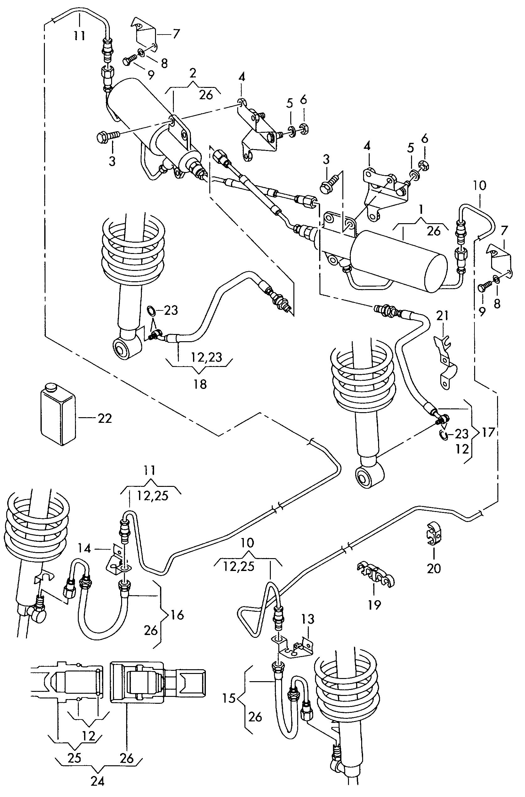

some extra info
Never left a test point in but not a bad idea Dave.
Quick Coupling from Ebay
http://www.ebay.co.uk/itm/400272166530? ... 1497.l2649
This has both male and female ends so can be connected at any point in the DRC. There are connections at all 4 shocks and at the 2 accumulators. I charged the system from the rear accum connetions at accum only which worked really well.
If there was air in the system it would be easy enough to purge I would think, as there are plenty of connections. See drawing
Used an Enerpak pump from work and a small test gauge to read the low scale
I anyone needs to borrow the fittings let me know (pump lives at work though......)
Will upload more snaps from work as this computer is
