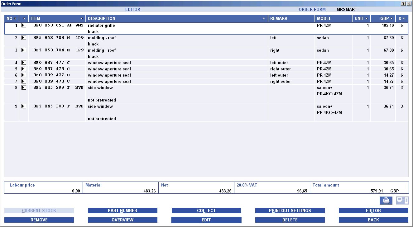

i know danny said he would post it but heres the part numbers and prices for black optic trim.
if you haggle you should get the vat back.

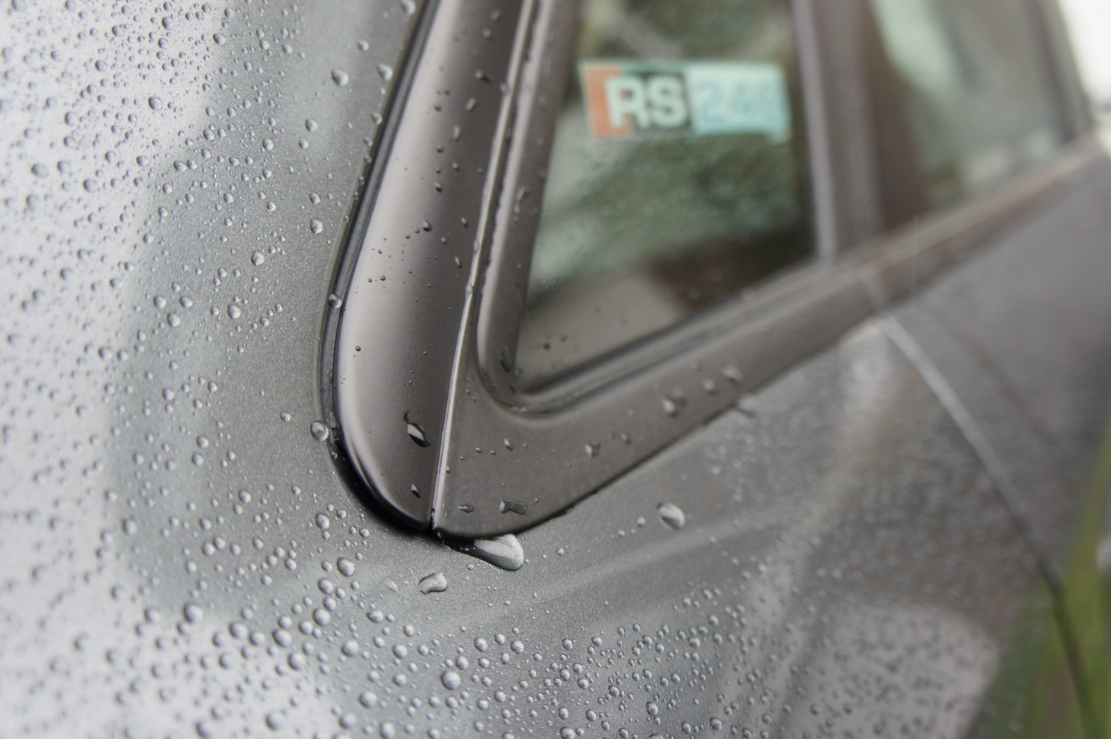

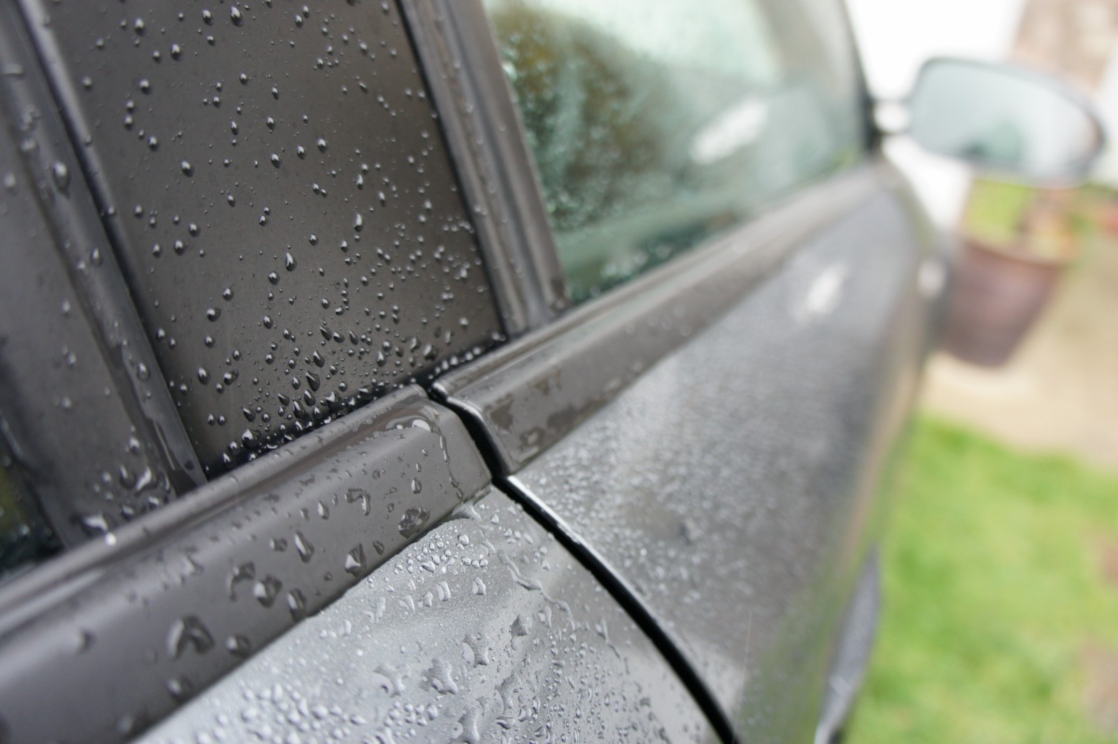

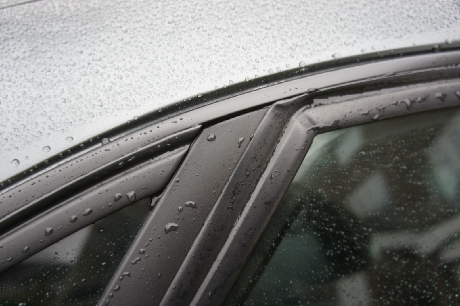

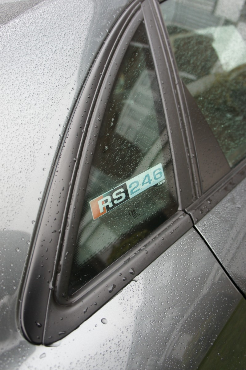

Here is a close up of the trim as discussed in PM
