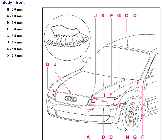

These are the panel gaps off the cabrio but I don't see it being any different to the saloon/avant
This is very annoying as they are clearly fobbing you off ! show them the picture then get them to go out to your car with a feeler guage or "special tool 3371" and show you how it all lines up.rs4george wrote:iv just had mine to the dealers and had the front bumper off to replace the rads, i noticed the front looked a bit off, and took it back, i knew they were bullshiting me when they said it couldnt be sorted out.

that's not a B7 pic but why would a B6 have an adjustable gap at the top of the grille?
I take it ELSA is using a B6 pic to depict a B7 issue, not ideal for fighting your case with Audi!

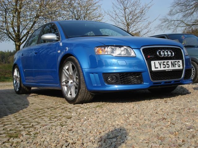

I really need to do mine its been bugging me for a year. Now the weather is getting better know excuse.
