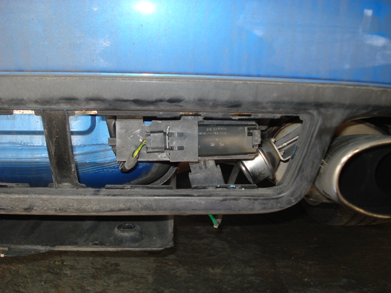

Update:
A willing guinea pig let me have a look for their TPMS antenna and I found it.
It's located just inboard of the offside exhaust tailpipe
It's hard to see as bracket and antenna will be covered in cack (which explains the failure!)
As suspected, you can pop out the honeycombe panel in the bumper and when you do it's just in front of you and very easy to swap.
His antenna fault cleared straight away but TPMS still not seeing the sensors which I can only conclude is because they are in storage mode from not having communicated with the antenna for a while, I am hoping driving it will awaken them but we shall see.

neckarsulm
Posts: 4468
Location: The Point
RE: Re: RE: Re: RE: Re: RE: Re: RE: Re: RE: Re: RE: TPMS ant
Post by neckarsulm » Sat Feb 12, 2011 8:41 pm
My car has been at the stealers for 2 weeks now, they've replaced 4 sensors, 4 valves and the antenae and they still can't get the TPMS to function corrctly.
That just leaves the control unit which according to ETKA is in the nearside boot panel and costs a lot more than antenna!
Anyway here is a pic of antenna
