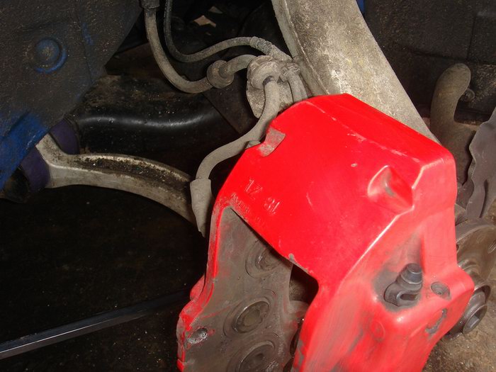

stump, have you read through this thread yet
http://www.rs246.com/index.php?name=PNp ... mbo+brakes
. it goes into more detail on what i said above, i ended up having to swap the bleed nipples and link pipe around. if you have any more pics of the calipers i may be able to tell if they are right or not. cant quite see the letters on the pics youve posted

just go out with a torch a look and see if zl 17 or zl 18 can be seen like in this pic

the largest piston should be at the top. sorry to say mate but from what i can make out these are the wrong way round

Can't see anything with the wheel on, so will have to wait to check.
Ok looking at this picture:
There's no stamped product number on the top of the caliper, so must be the other end (they definitely had the numbers quoted as saw them yesterday).
Just reading your other thread...
