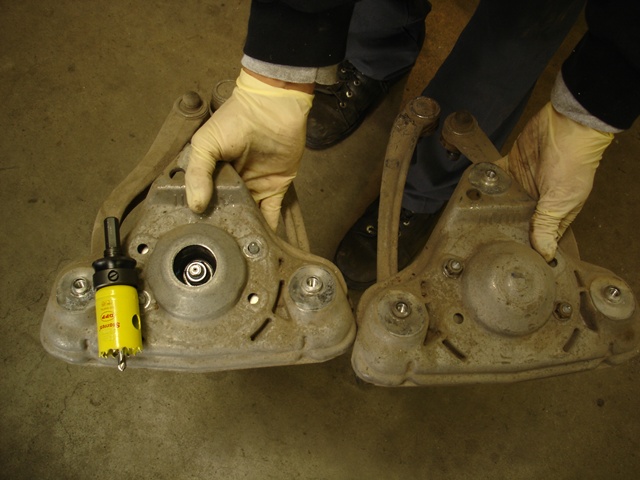

So installed the new suspension today - with a buddy of mine . He had some excellent ideas on how to do the install so i could adjust all the shocks without ever taking a tire off my car.

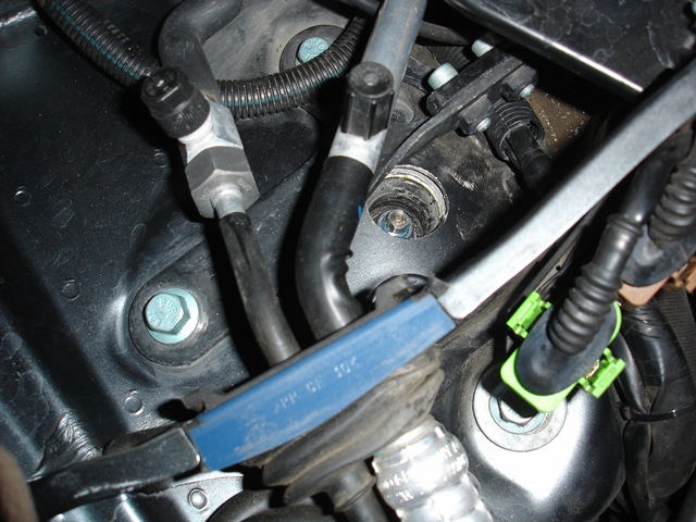

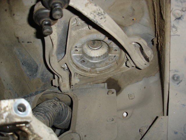

We cut the tops of the front shock mounts with a 1 3/8 hole saw then removed the guide bit.. test fitted the mounts and use them as a guide for the saw to cut through carefully into the engine compartment.

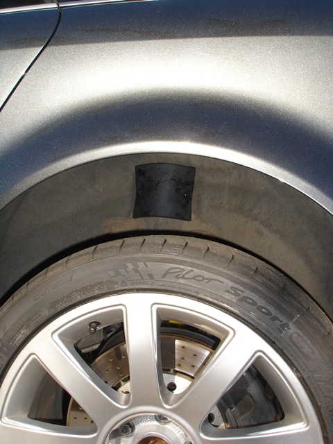

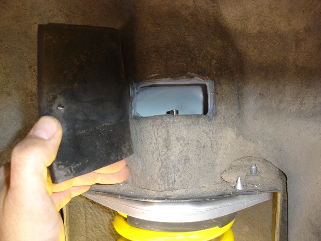

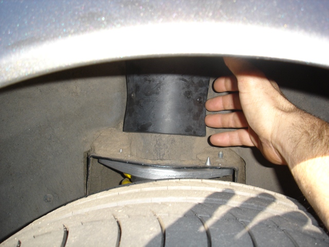

In the rear i measure where the allen would need to be to adjust the shock when fitted then cut a slot in the housing (vechile) Covered with rubber and self tapping screws. Jacked the car back up and with the wheels hanging could get to the allen no problem - removing the wheel would help but is not nesessary.
Fitted the front sway bar from HotCkixs but the rear is the wrong one - straight across with just a single bend at each end - totally unlike the factory one. There was just no way we could get bolts in - will contact HotCkixs ASAP on this. New tires on to / Michi PS2s.. THANKYOU SANTA.
Hope the pics explain the mods better - why have a fully adjustable set up you just can't set up?? Hope this gives the brave hope and some ideas on a good KW saver.
