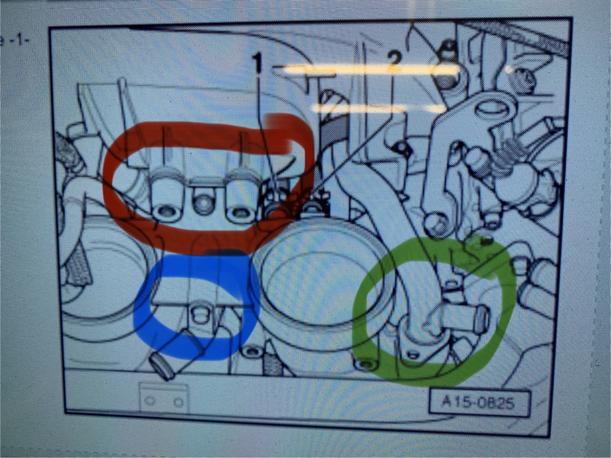

As above brute force. You need to lever the inlet tracts (Red)back about 5mm to get it off the dowels also the pipe mount (Blue) will bend back aswell.I think that pipe is the water pipe that links both heads and ends up at top hose. You need to undo and lever up both air pipes (Green) these are a PITA getting back in. Took me 4.5 hours to remove with lots of swearing and messaging TOPMAN (thanks for your help Craig)

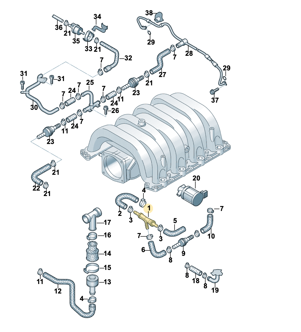

Probably is the SJP as a common fault. It is still available from TPS / Audi for about £45. I changed mine while the mainfold was off even though the original 2003 one was fine.
Re: SJP continued
Anyone got a part number handy for the SJP? I'm going to put it in the FAQ. And probably get one as a spare while they are still available.
Re: SJP continued
Hi BenShoppinit wrote:Anyone got a part number handy for the SJP? I'm going to put it in the FAQ. And probably get one as a spare while they are still available.
Here you go
Re: SJP continued
Re: SJP continued

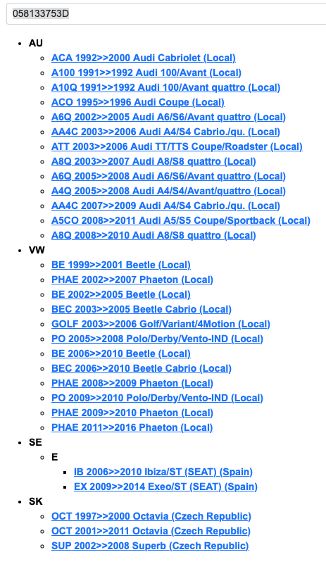

Part number 058133753D is the latest version from Audi according to ETKA and used on all these vehicles.
Re: SJP continued
Yeah, but don't eat them because they contain lead.
Re: SJP continued
Location diagram for anyone interested
Re: SJP continued
WHAT!!! Like HB2 Pencils
Re: SJP continued
REACH-relevant component.
Contains: Lead(CAS 7439-92-1).
Re: SJP continued
And I've been sucking and blowing on that thing to see how it works
