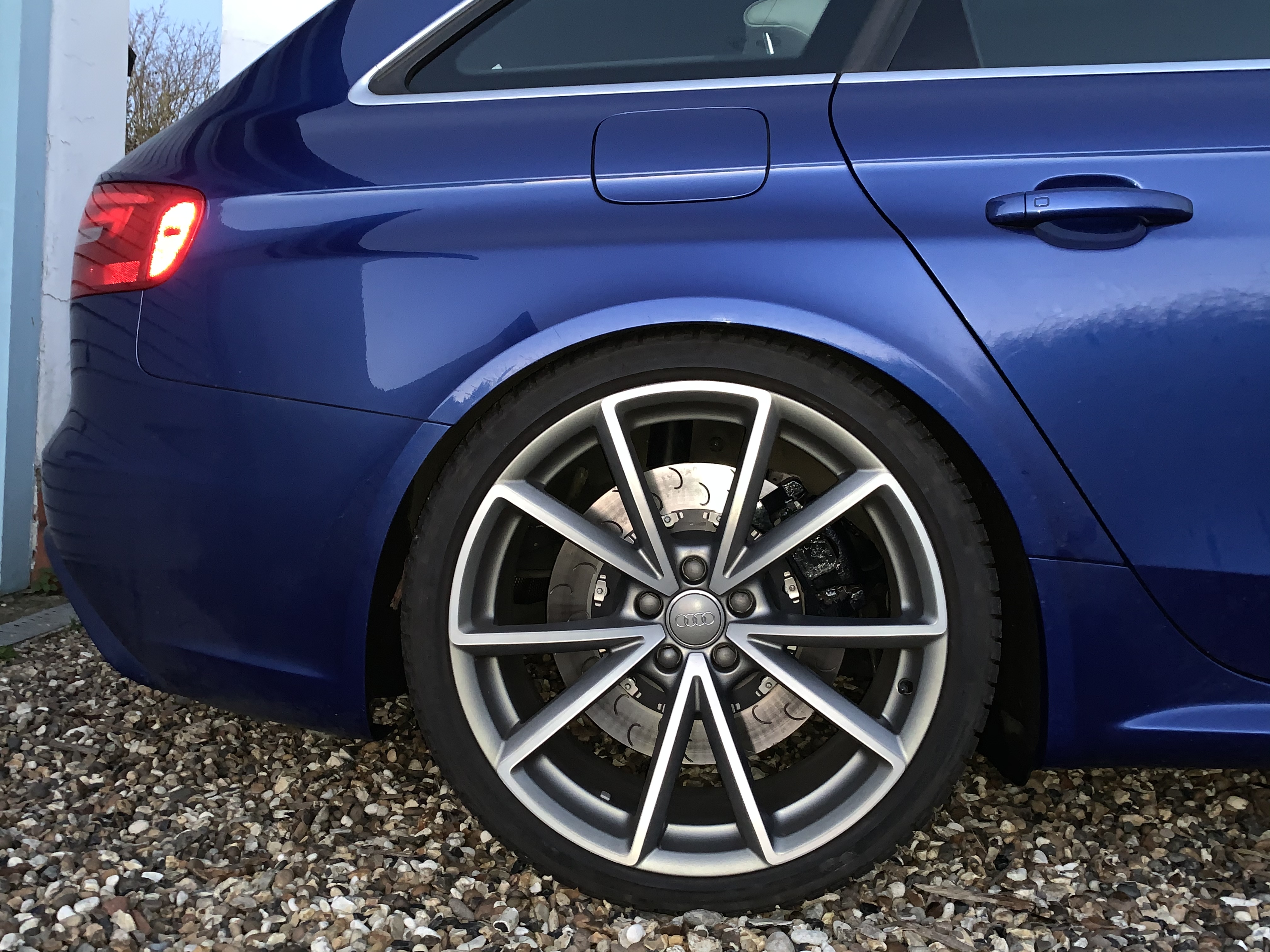

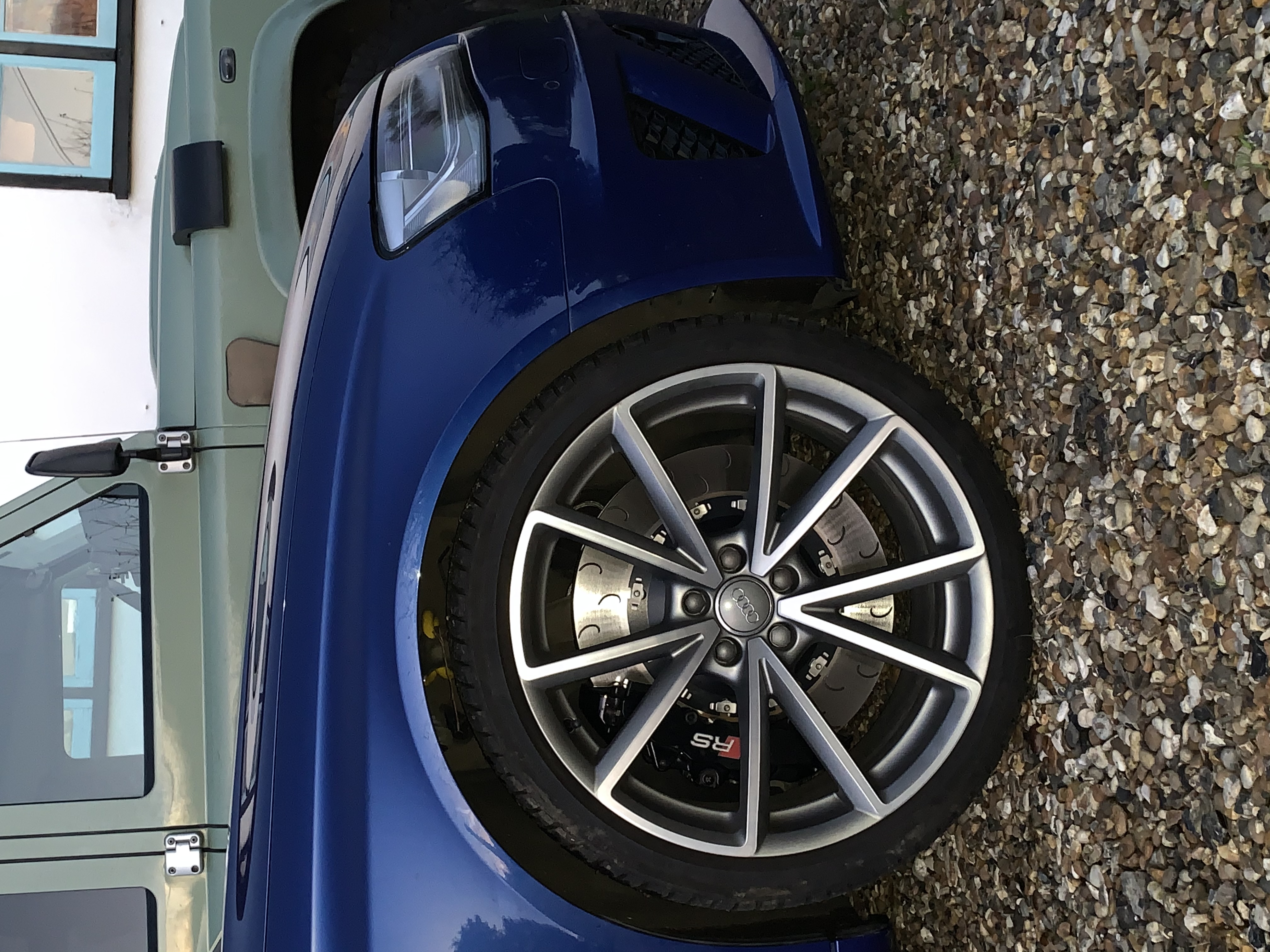

It’s taken a while to get the KW V3’s fitted, along with the 034 Motorsport top mounts, FEBI rear top mounts, 385mm front and 360mm Reyland fully floating discs, Ferodo DS2500 pads, HEL braided lines and RBF600 fluid.
The suspension rides superbly and doesn't in any sense give a bone shaker ride. The photos show the resting level of the suspension, the rear set at the highest possible setting. Even though the front sits higher this is to ensure the sills are level. I haven’t used the brakes in anger yet, but they do feel very firm and stronger than before from the top of the pedal (without being grabby). They’ll be glowing red later tonight as I bed in the pads.

Wow that is low even at the highest setting, have they settled yet?
Can't wait to hear more on the brakes, my pads are 4 and 3mm so have to be done soon but Discs may give me a few more weeks, thankfully as the sunroof is leaking and Warranty Wise are fighting the claim could be a £2k bill!

How much clearance is there between the calliper and wheel? If you could do a close up picture of the calliper that would be great.

I'd say that they would catch on the 19's (remember that Reyland would be able to provide standard size discs if you wanted). I drive to Austria most years for our family ski trip, i stayed on my 20" wheel and bought winter tyres in this size. It's now time for new summer tyres and its been a pain to get the Michelin Pilot Sport 4S, my tyre Shop ended up importing them from Europe.
