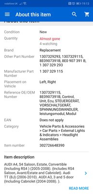

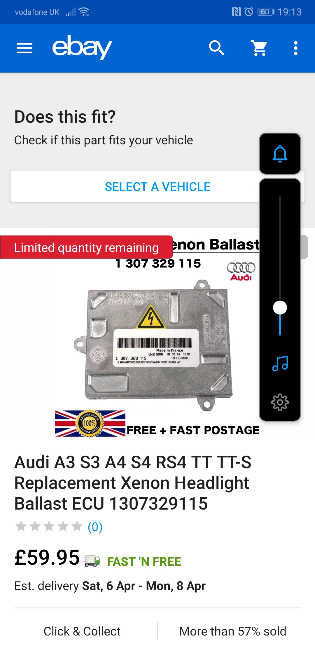

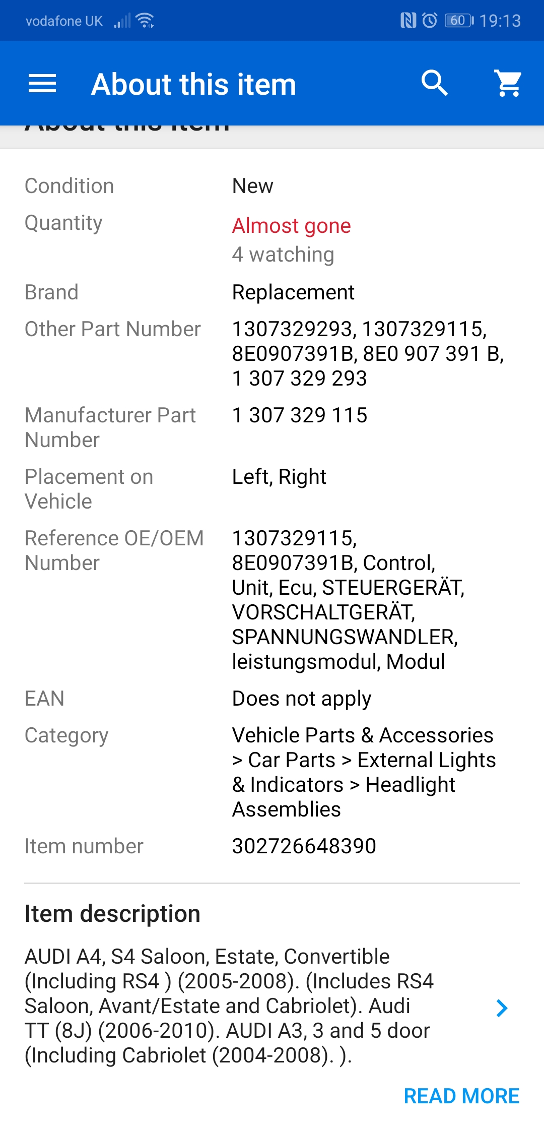

Does these look like the right ballasts?

If you go the brand new route, they should already be coded for the B7, if they’re second hand or refurbed units that came from an A3, for example, you’ll have to code them to the car. You then adapt the units. It’s not difficult and you can do it all through Vagcom/VCDS. There’s a thread on Audizine that explained it all. I’ll have a look and post the link for you.
Have a look at the part number on the Sticker, on the top of your headlights. You only need one side and then you can be sure to get the right ballast. Or you can run a Vagcom scan and it’ll list the individual ballast part numbers in the results.
Let me know what the headlight part number is and I’ll get you a ballast part number. PM me if you want.
