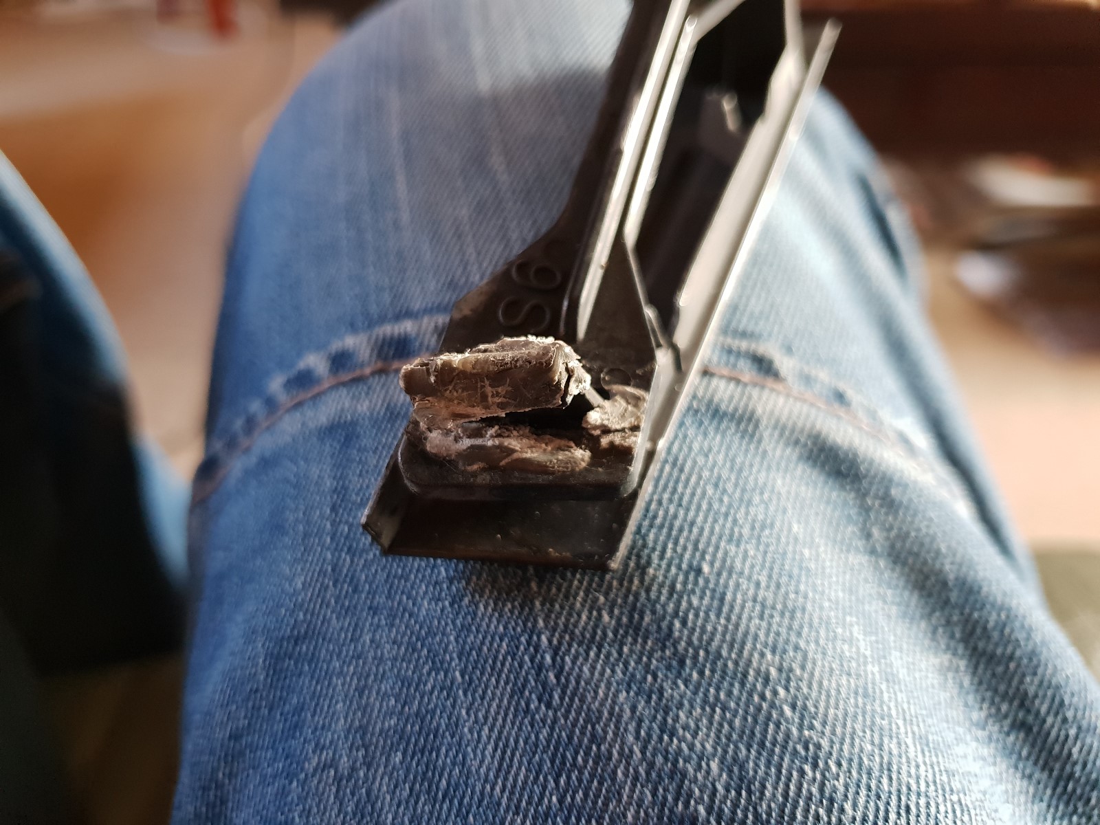

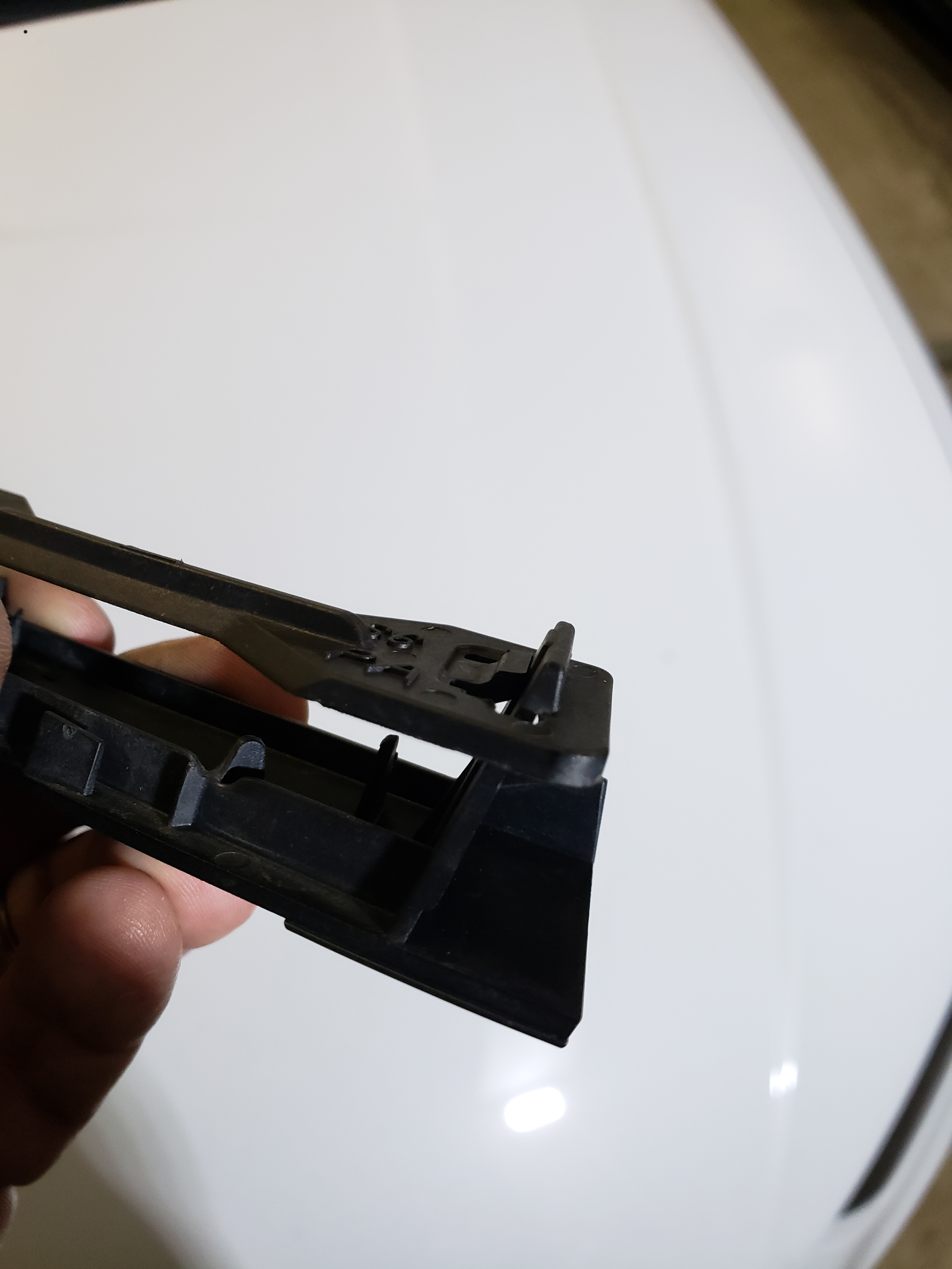

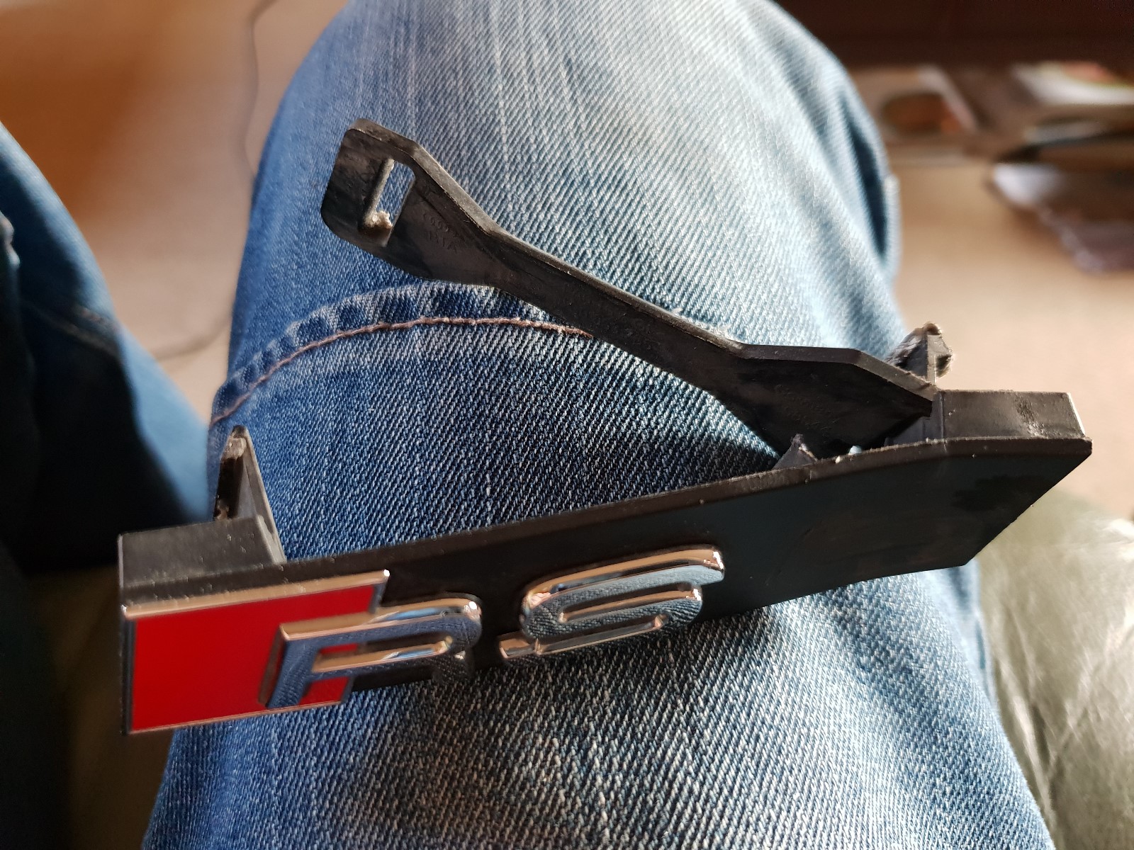

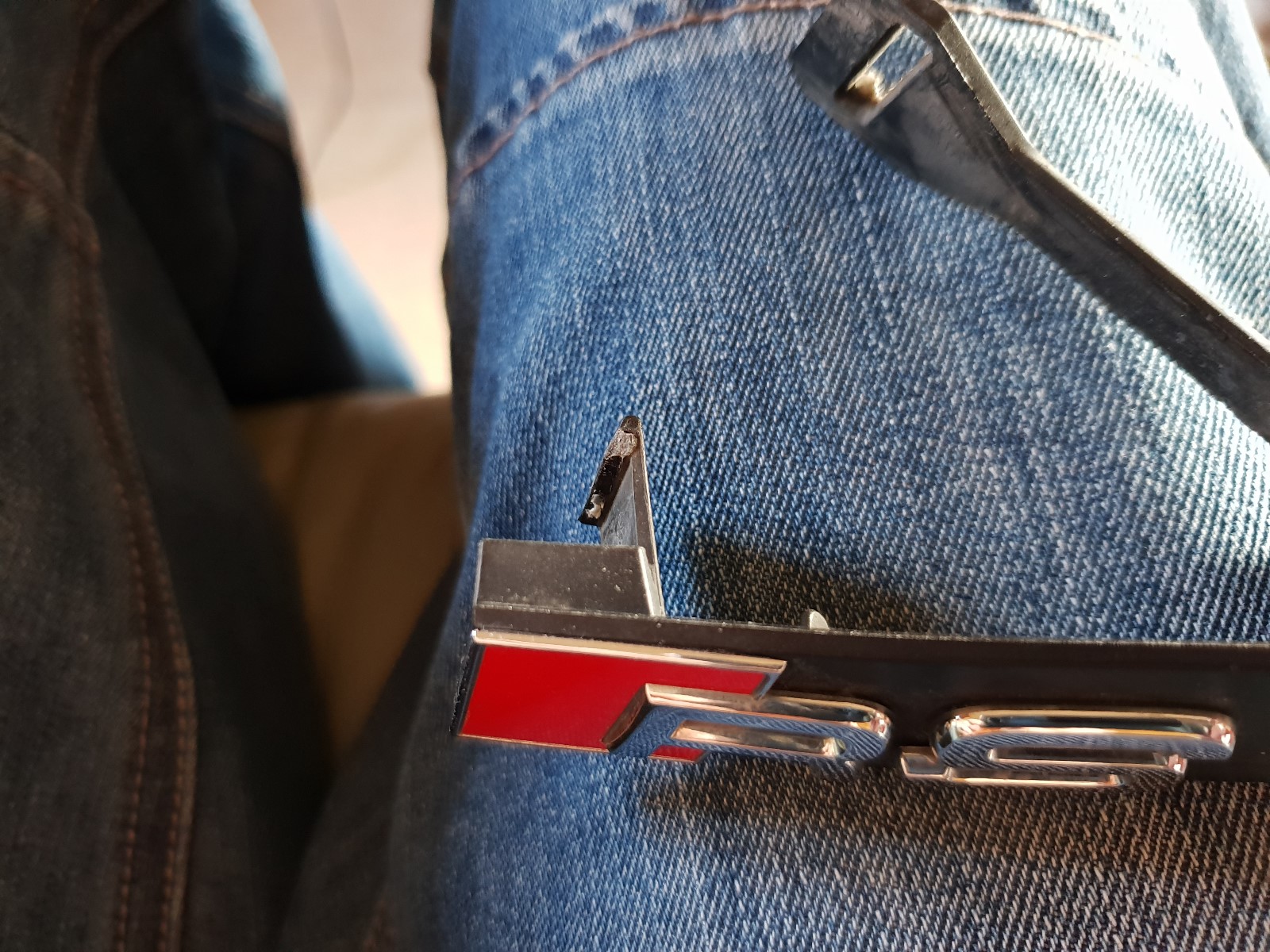

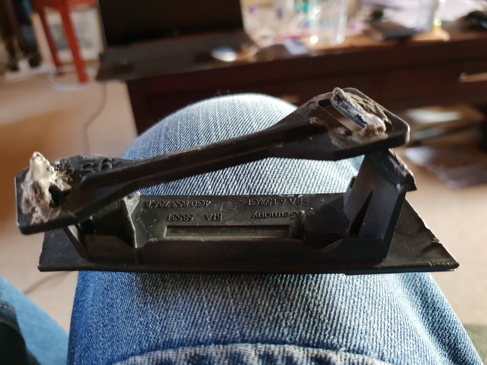

Finally took some time in the zero degrees this morning to figure out why this badge wouldn't budge. Finally did and finally got it off. The following pics should explain all...
Basically the badge is clipped into the holding bracket behind the grille. The tabs need to be squeezed together (towards the badge centre) to release. All very well providing some bright spark hasn't also coated them in rock hard glue.
In my case I was able to chip away enough glue on one tab to get it to release but try as might I could get the second one to release hence the damage as I ended up just twisting it out. I wanted it out anyway, so will buy a new one for when (if) I sell the car.
Anyway, hope that helps.

Nice one Dave. That looks like mine except I don't have a any glue on mine. I managed to poke my phone down between the grille and radiator to take some photos. It looks like yours but without the glue. But it didn't help me remove it still.

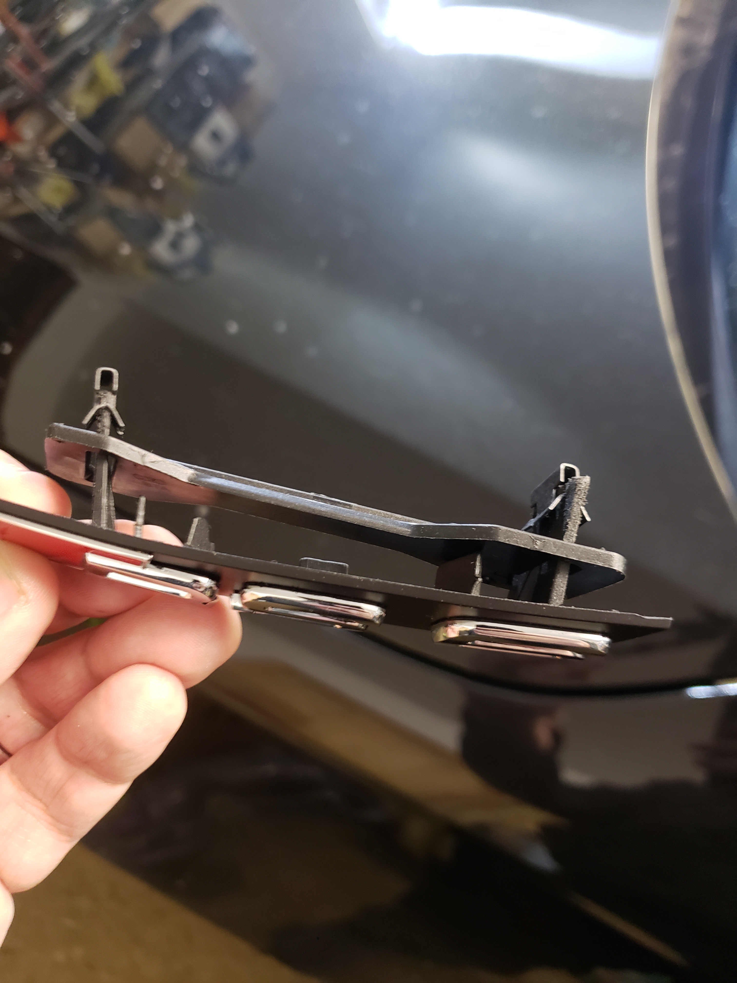

Yes Chris that's right. I have a spare badge from a pre facelift grille and the back is held on with those little metal clips.
Re: Removing front RS6 badge (grille)
Post by MikeFish » Sun Jan 20, 2019 2:22 pm
Pre facelift:

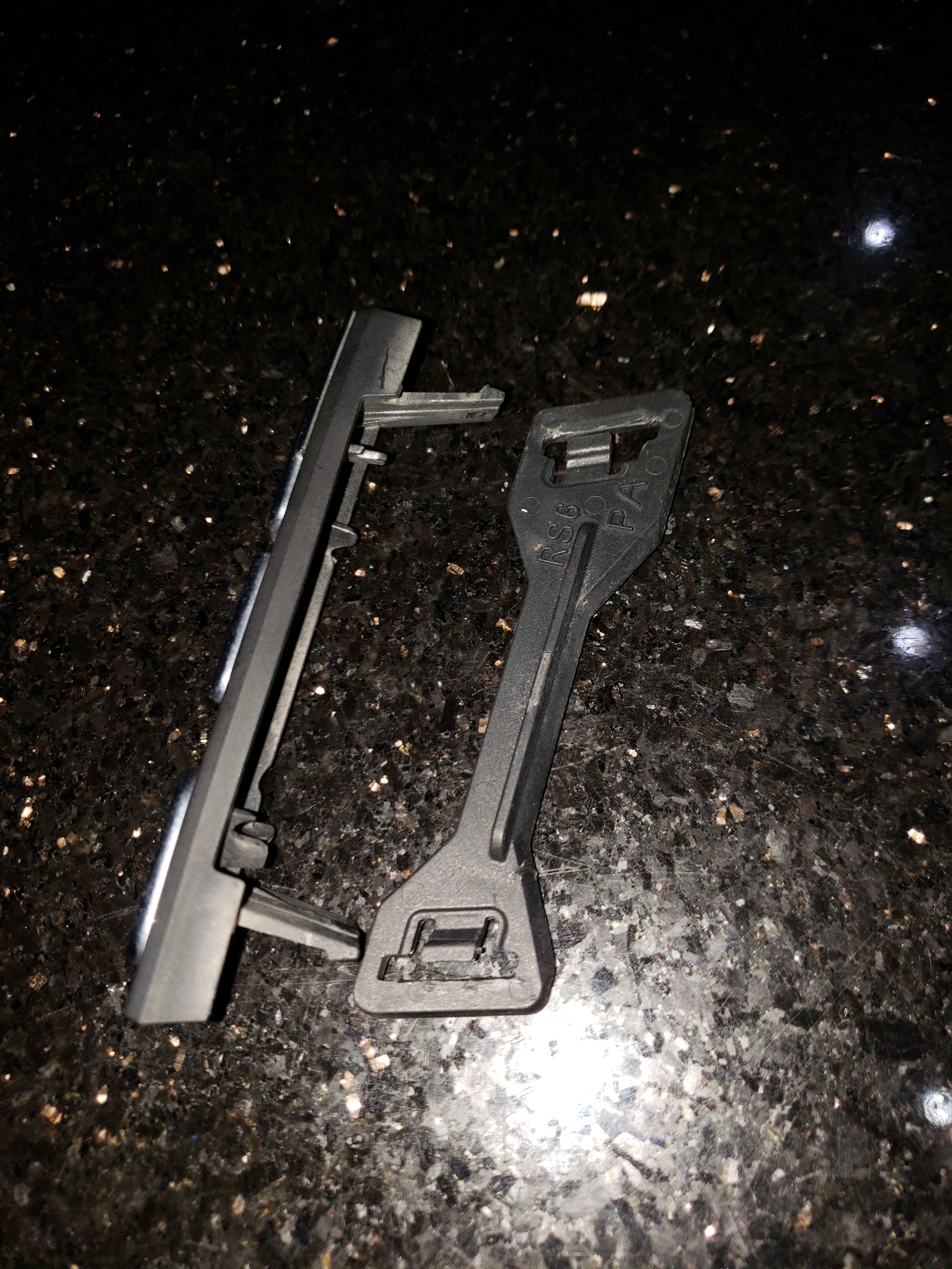

Inspired by this fresh talk of badge removal I attacked my badge last night with a big screwdriver. I used it to push the tab back on the left hand side through the honeycomb whilst pulling the badge forward and it popped it. Did similar on the other side and out it came. Even managed to retrieve the back bracket from inside the grille.
