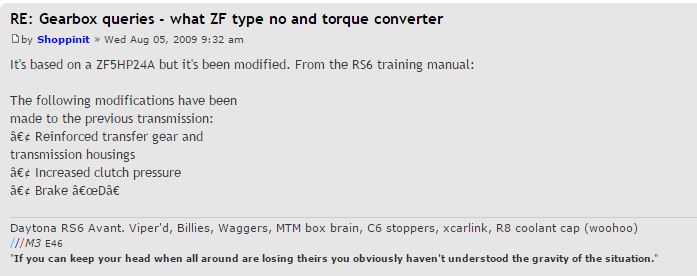

I also noticed on JT's website (link above) they refer to the ZF5HP19FLA rather than the ZF5HP24A. Bit of digging on this splendid forum turned up this thread HERE which appears to state the '19 has been strengthened.
Whether JT do any additional work is something I'll find out shortly.

Posts: 20308
Re: Gearbox etc...
Post by Shoppinit » Sat Jun 13, 2015 2:25 pm
Where does it state that?

Post by blm70 » Sat Jun 13, 2015 2:52 pm
Um, here...

Post by lswing » Sun Jun 14, 2015 9:56 pm
blm70 wrote:Um, here...
Yes, that's what was done to the ZF5HP24A...and it didn't help worth shiite :audibash:
Never once heard of the RS6 trans referenced as anything else...and it still needs upgraded VB pressure, updated clutch discs, and multiple pins and seals replaced to be better.
