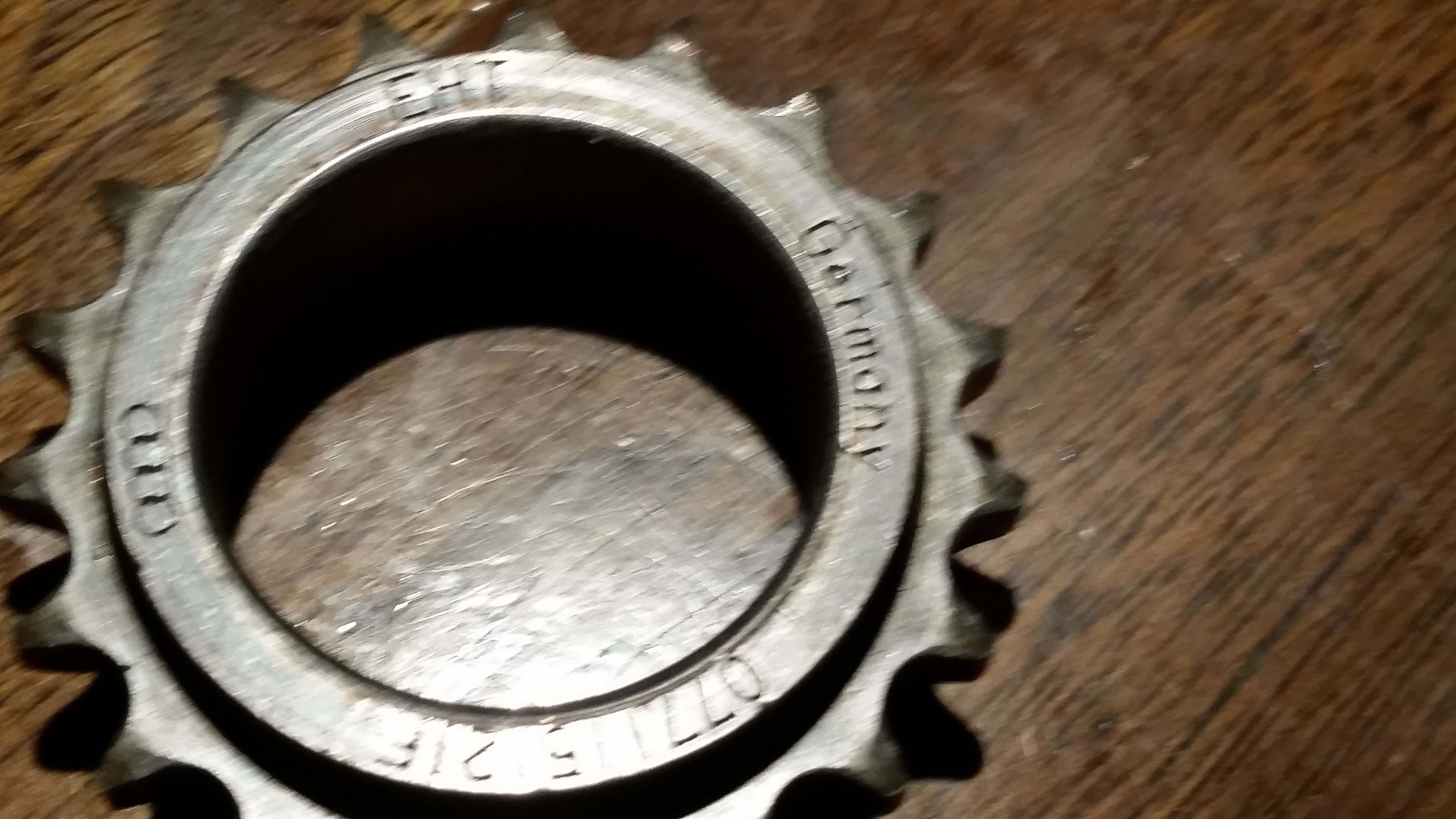

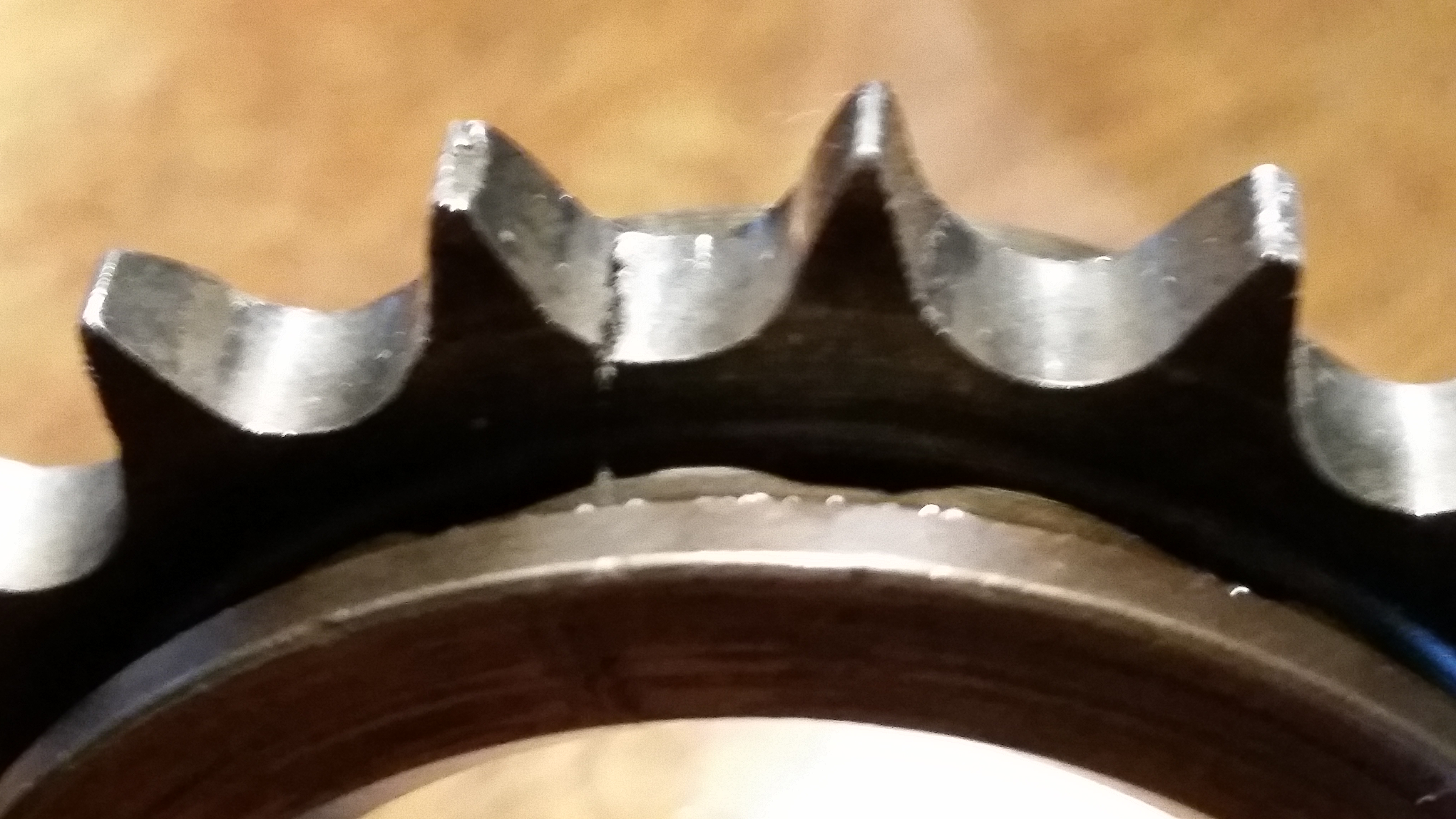

Well at long last I collected the car on Saturday morning and its pretty much rained every day since but I have covered a few miles and the car is spot on again. Its cost alot but I am so glad that I went ahead with the work and touch wood I won't have any further problems for awhile
but hey ho. They also left the sprocket in for me to keep as either a lethal weapon or a very uncomfortable Keyring attachment! Thats another C5 thats hasnt gone to the big scrapyard in the sky.

Suspect you were really unlucky with a bad part there. It's not even as if there's a lot of load on that gear.
Glad to hear it's resolved, though.
