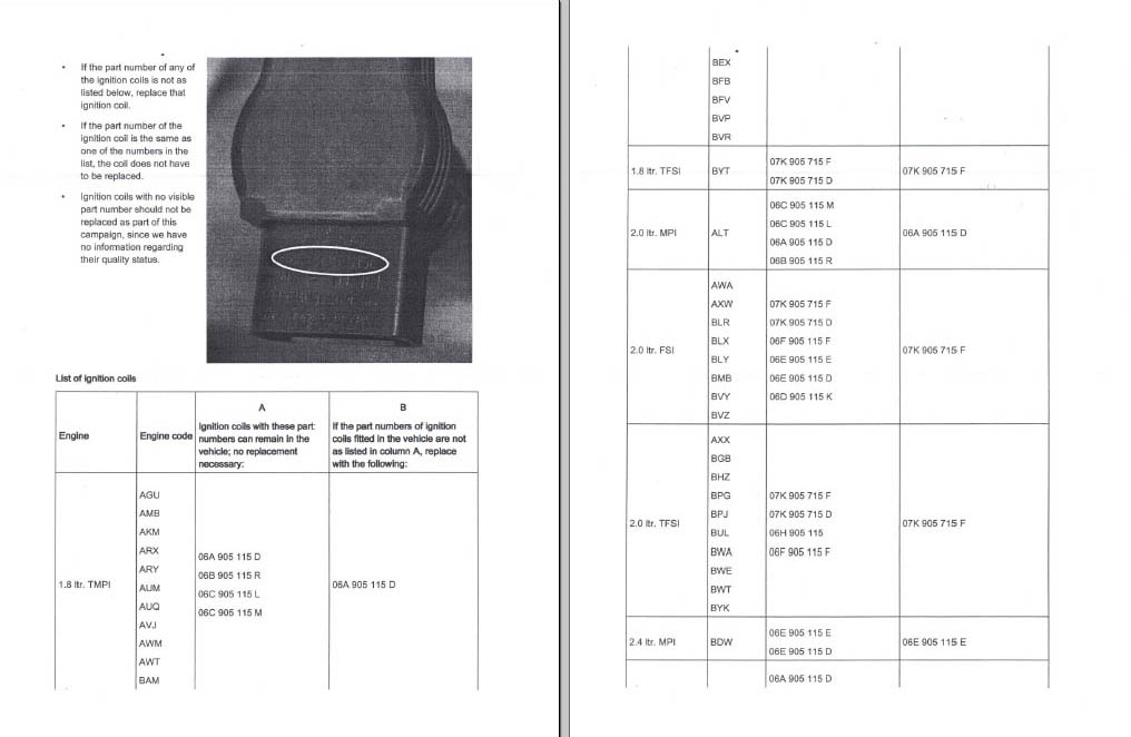

Been struggling to send PM's but the above is out of the tech doc from Audipad125 wrote:I'll try and up load the document
File too big, 3.4mb
Basically, it says everything thats been said above with more detail on all the other cars affected. Gives part numbers to check for
Engine code BNS
If the following part numbers are fitted then all OK
07K 905 715F
07K 905 715D
06F 905 115F
If not then they should be replaced with 07K 905 715F

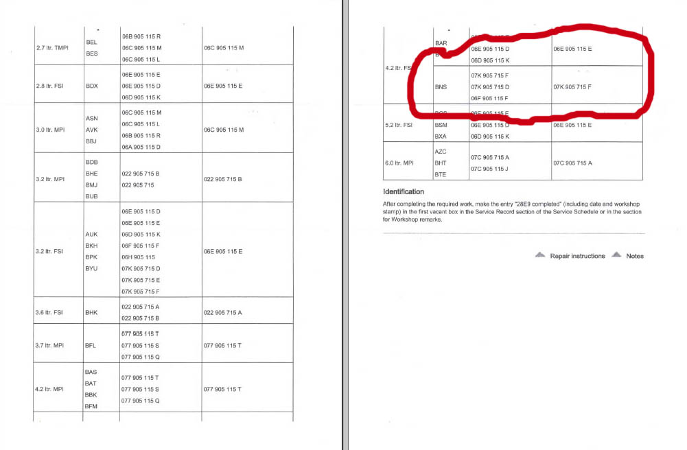

Courtesy of pad125
here are the 2 relevant pages from the coil pack workshop action document providing the facts.
The first one is in there just to show the column heading for page 2 where the RS4 info is (circled).
