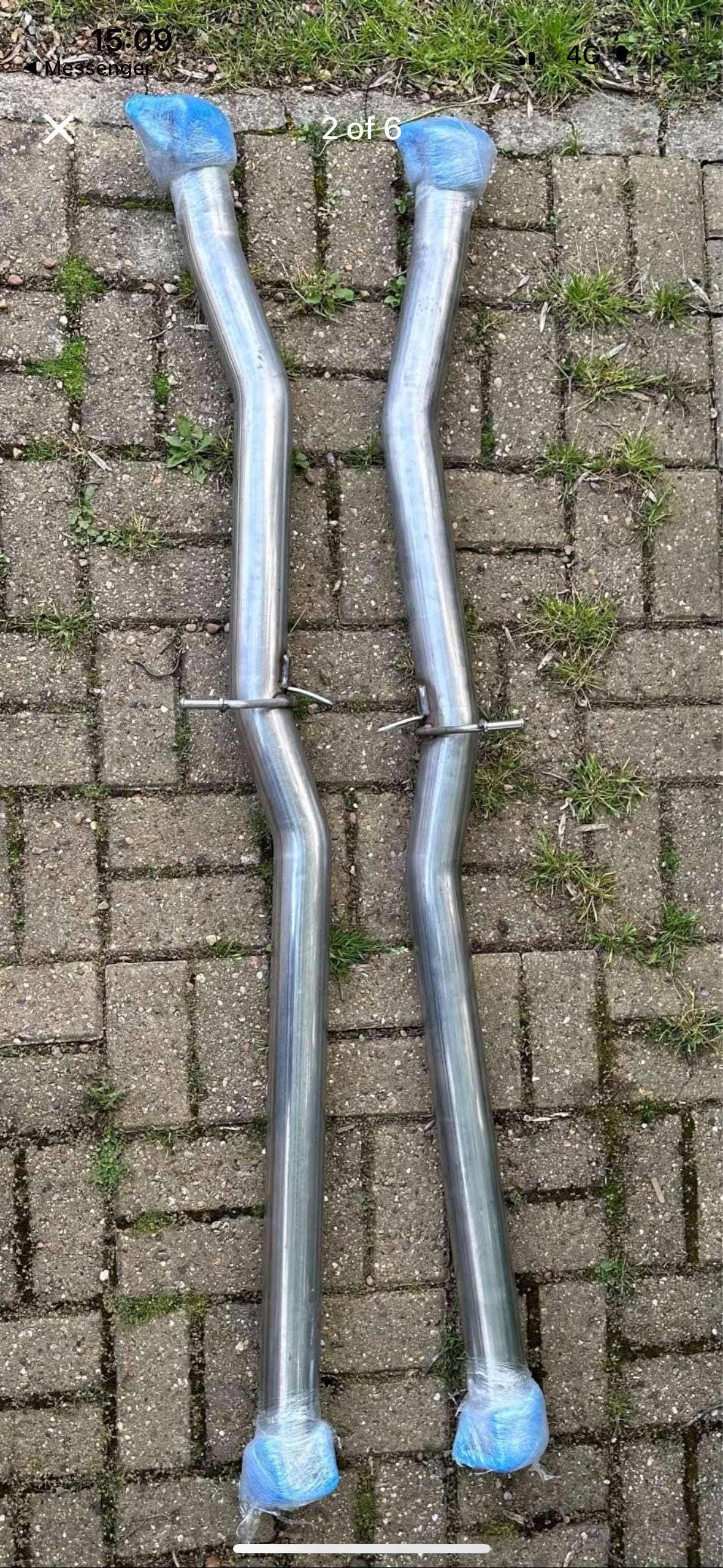

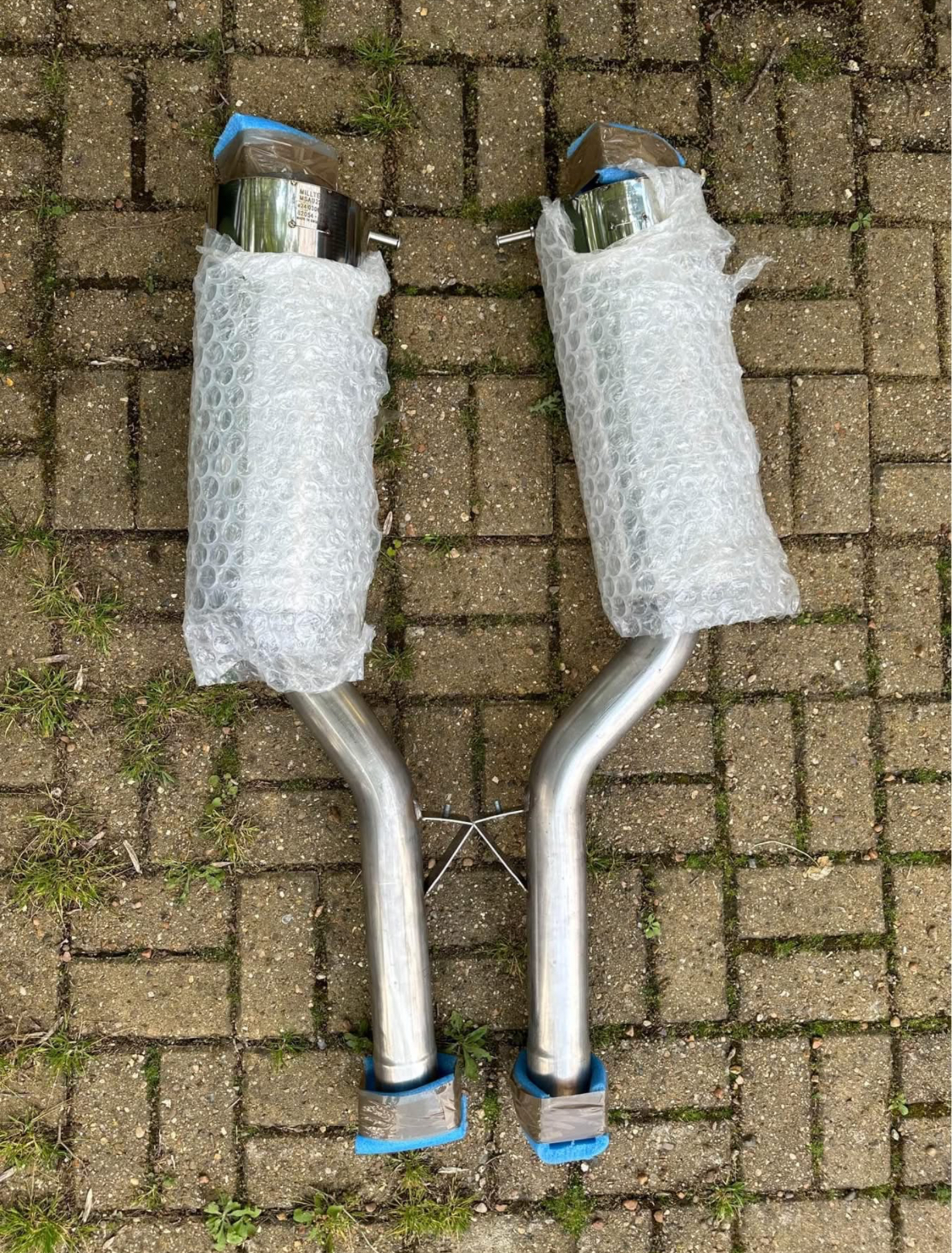

I’ve had a slight vibration under acceleration since I put the car back on the road. It comes in at about 40mph and there’s a slight buffering noise, that disappears as you get faster.
I’m convinced it’s the drive shaft support bracket. So I’ve gone and brought one of these and, by applying a bit of man maths, I’ve gone a treated her to a black tip Miltek.
Getting fitted on the 23rd, fingers crossed this fixes it. 😬🤞
