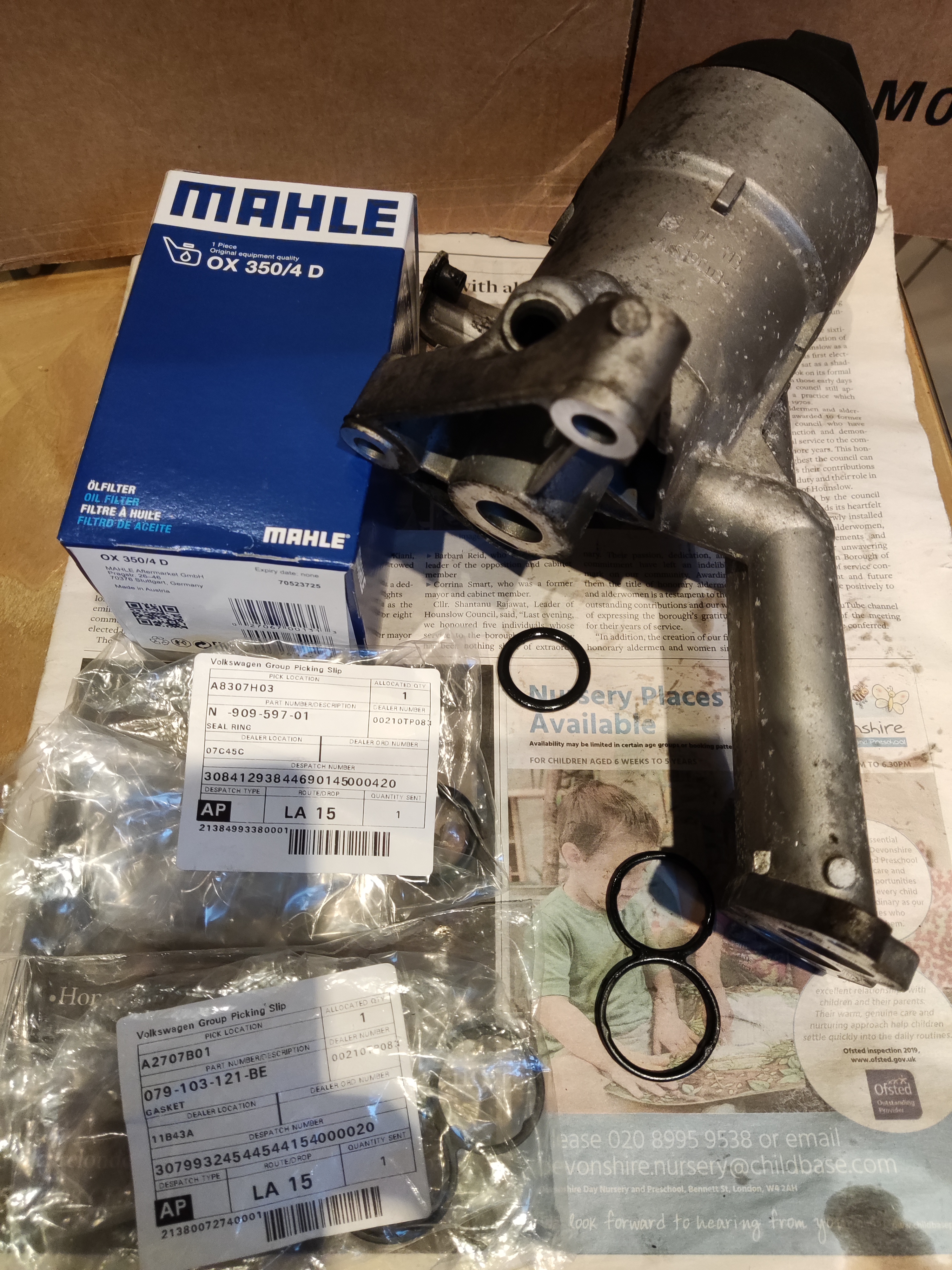

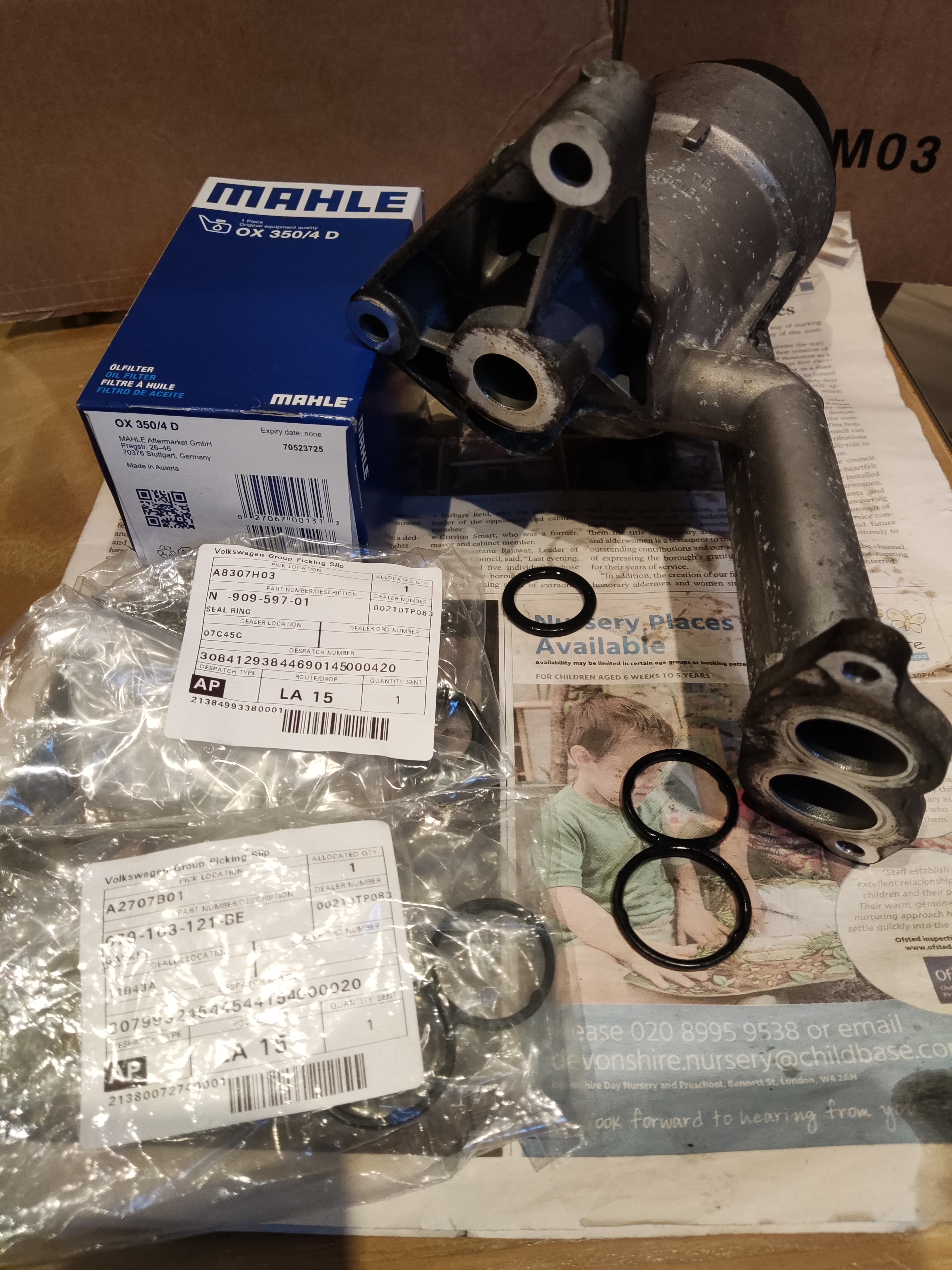

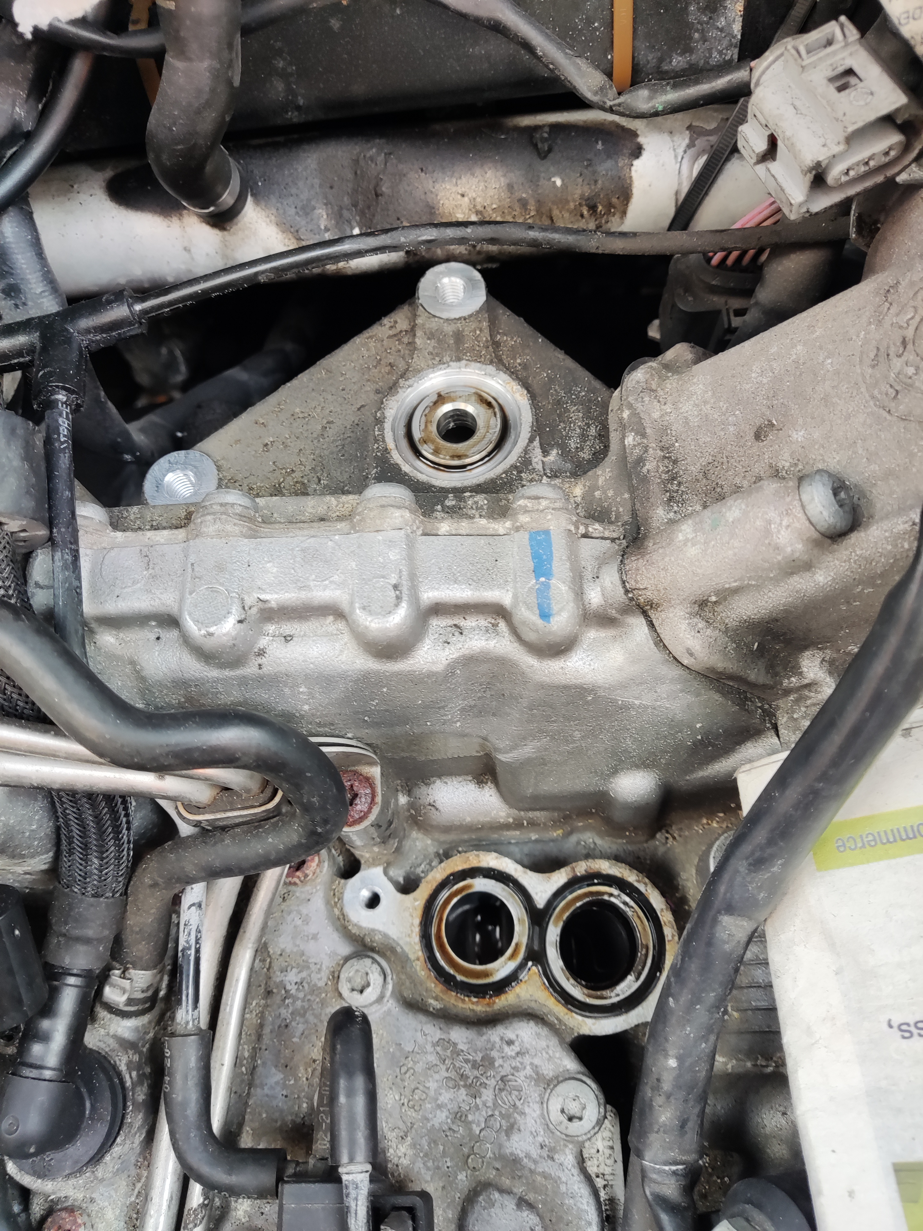

On another note, I can't recall.. but did you change the change the Oil Filter housing seals?
In the process.. and wondering if you (or anyone) also have the torque specs for the 4x bolts pls?
I attach pics and filter housing seals part numbers for reference..

Of the two Oil Filter housing seals, the double 'O' ring / 8 figure seal definitely feels quite hard to the touch.. and is likely the seal that eventually fails.. leading to the engine oil seeping into the valley.

Interesting, so i hadnt heard these could be a problem, didnt touch it.
Tie rod end torques: Oil filter housing torques:

Although the double 'O' ring / 8 figure seal definitely feels quite hardish to the touch.. I wouldn't think it'd be an issue for a few years.. (generally seen as an potential issue on higher mileage examples)
So, on low mileage examples (i think like yours) even mine's at 77k - typically I wouldn't worry..

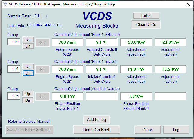

Anyway, interested to hear about the Injectors values from a fellow VCDS owner! Could you post bit more info?

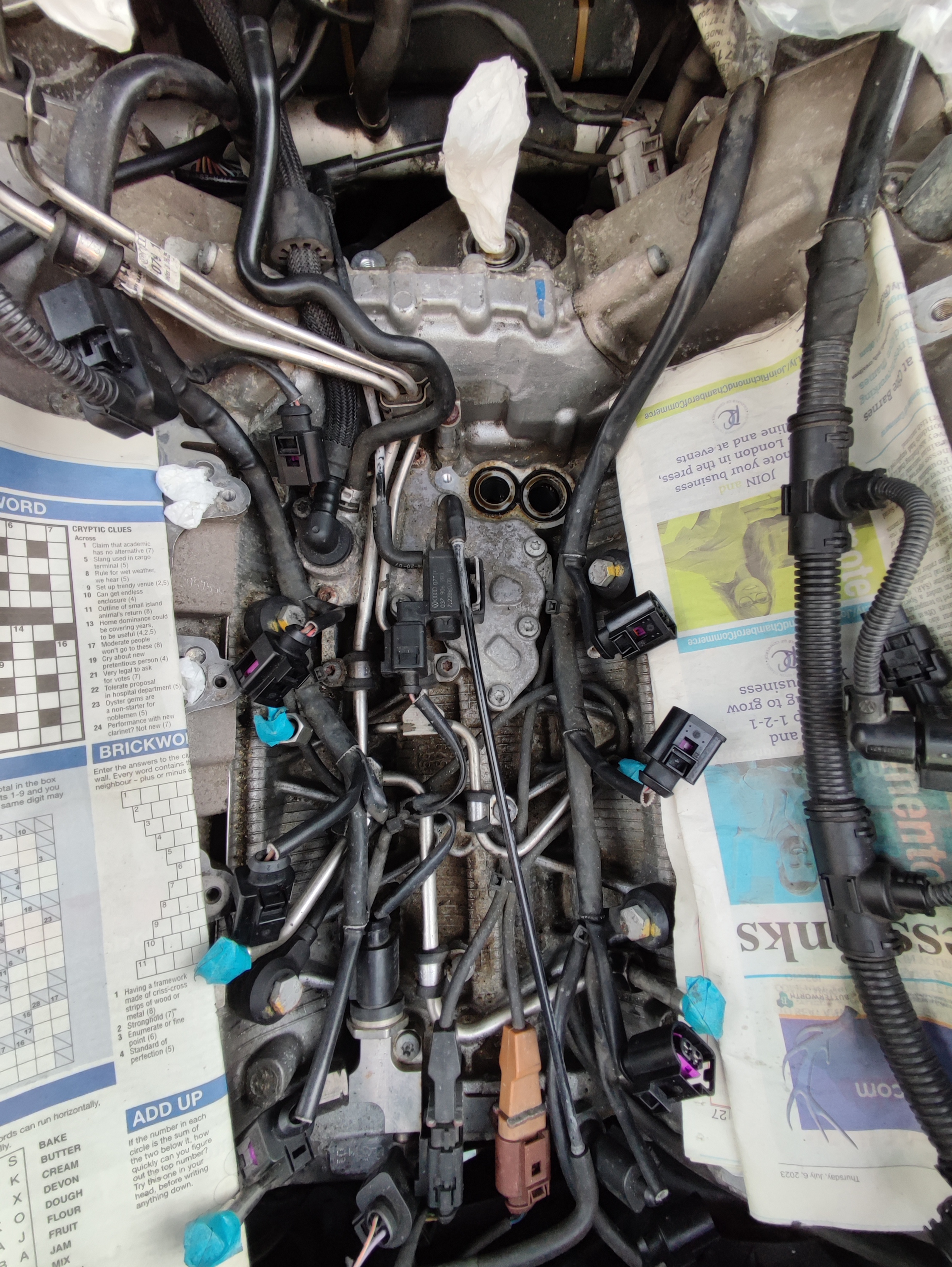

I managed to have a quick play on my mates RS4 B7, few weeks back to check whether it was pulling timing - ie. timing is off:
Still haven't got around to ordering the Discs & Pads all-around yet (as no time to fit currently) ..
Re: All comes at once - DIY: SAI, DRC, Oil cooler, Carbon clean, Fan, Tyres, Paint Corrosion, Injector Service
I was pleasantly surprised (as I'm sure he was) the RS was running pretty much bang-on..
with particular reference to Group 093 MBV's (Measuring Block Values) and the Phase Position (which I understand advise what the offsets and tensioners are doing)
and .. in my haste - forgot to check the other Bank / ECU

Interesting, not looked at 093 before, will do some reseach and take the measurement.

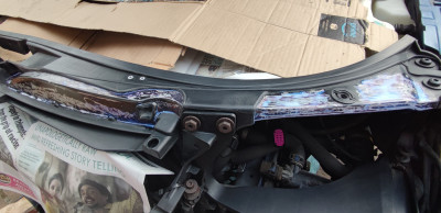

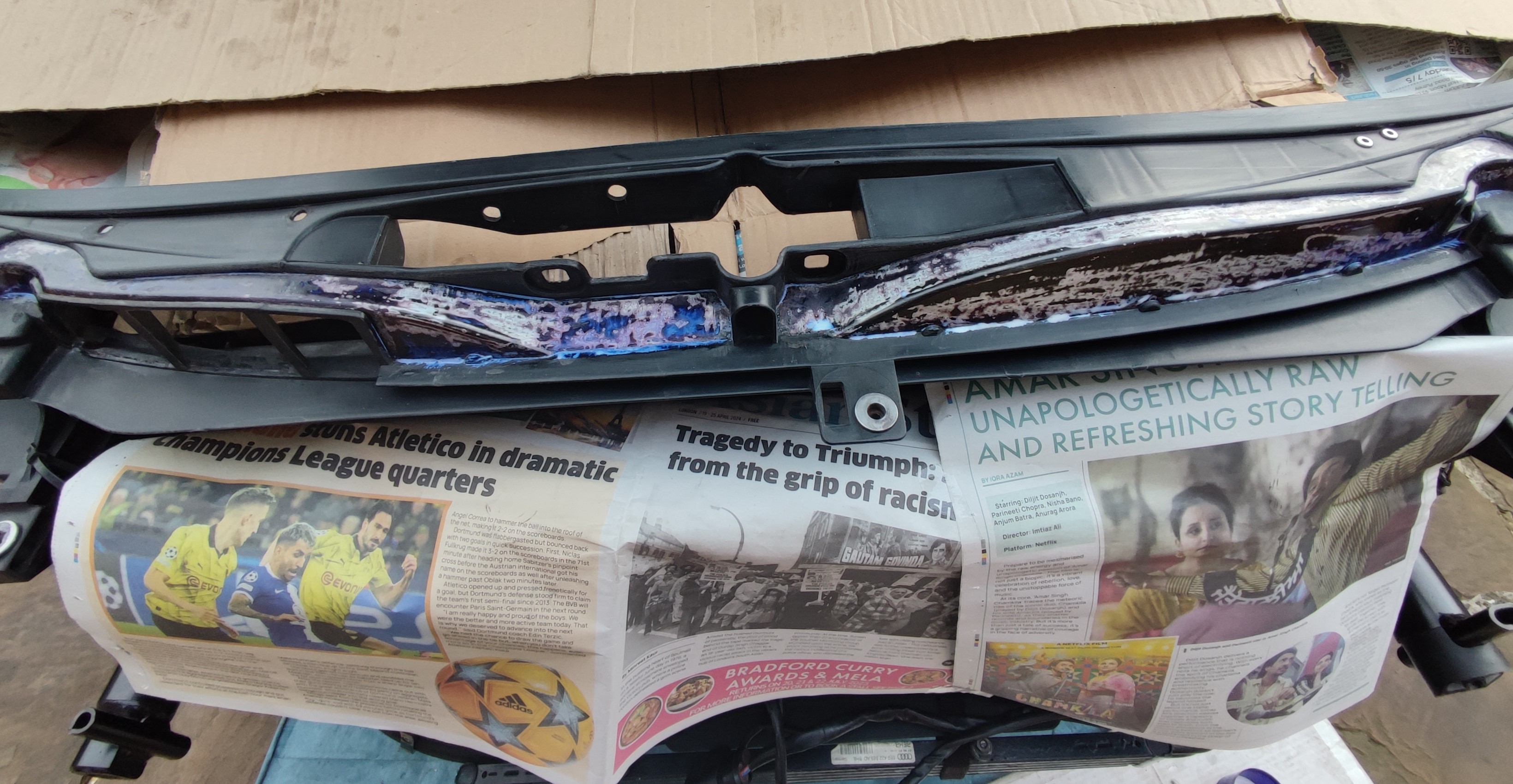

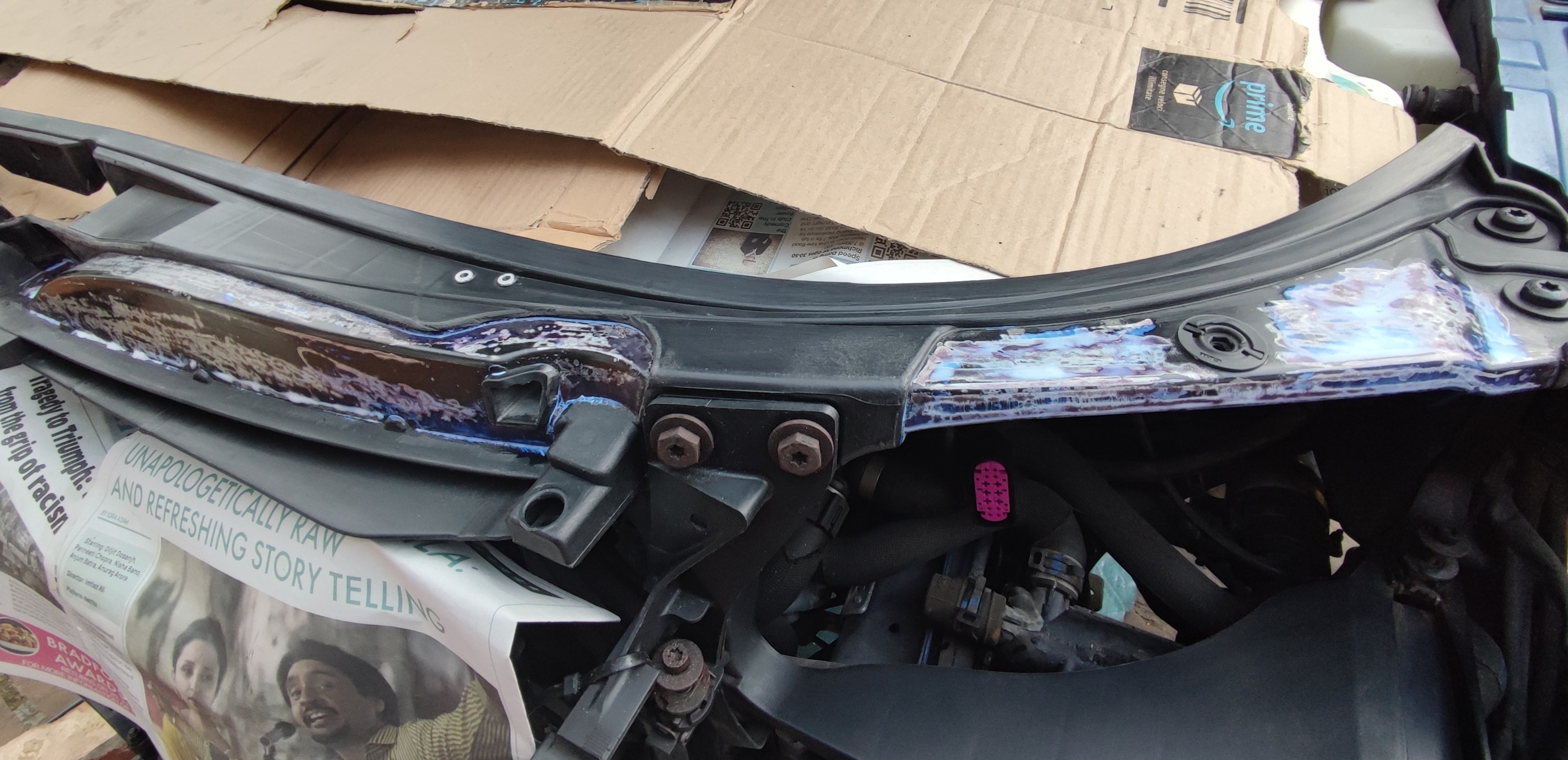

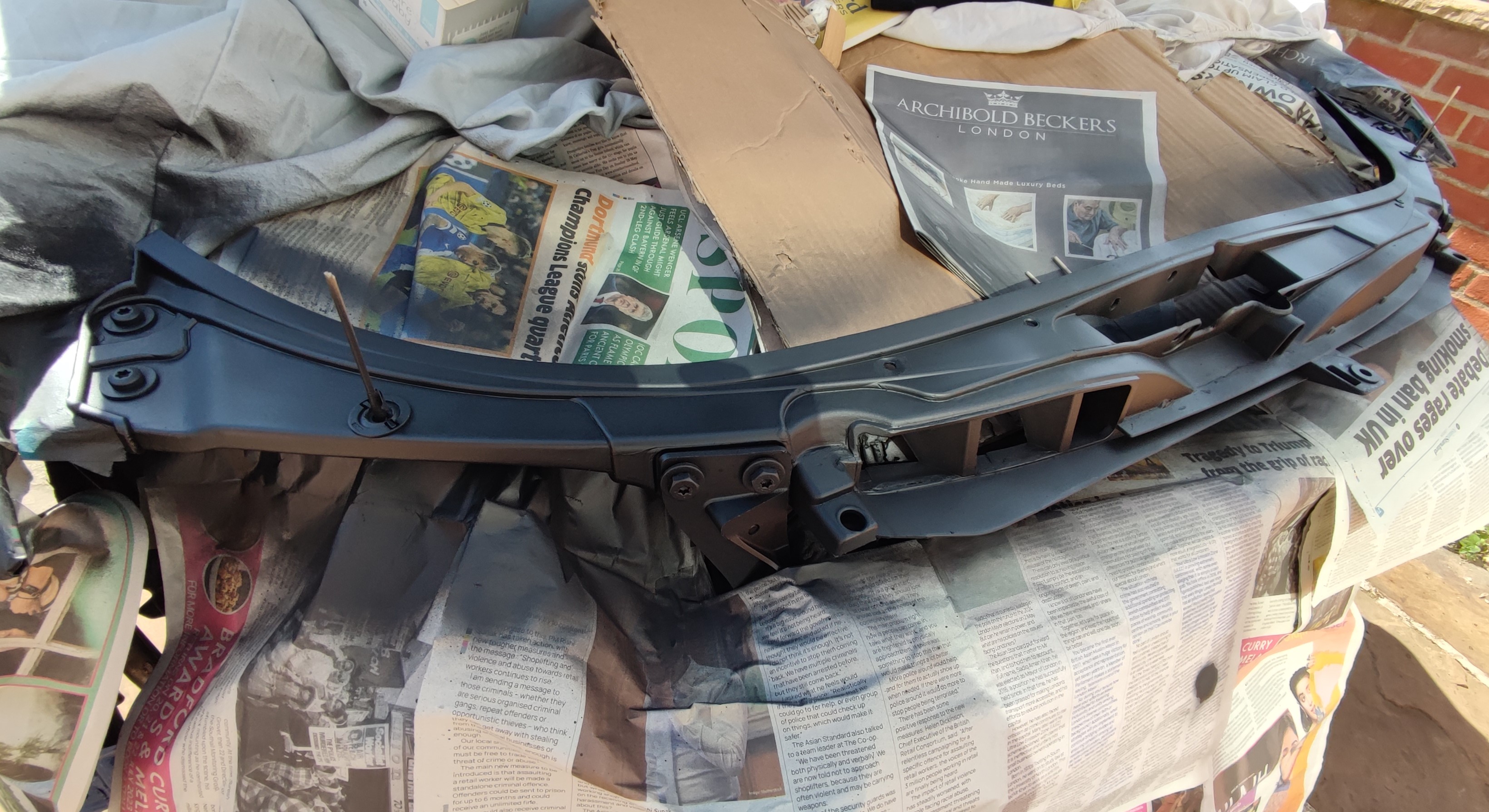

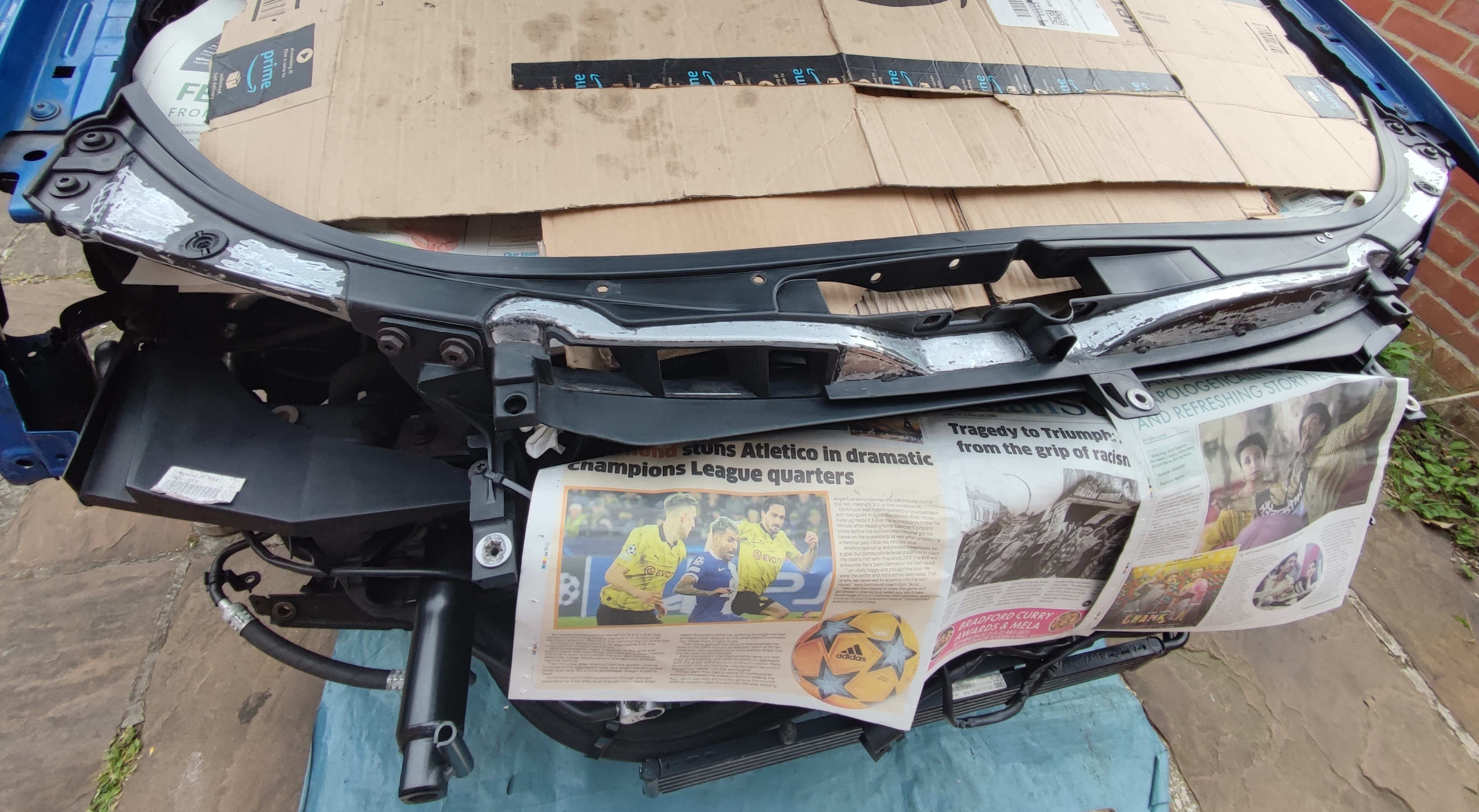

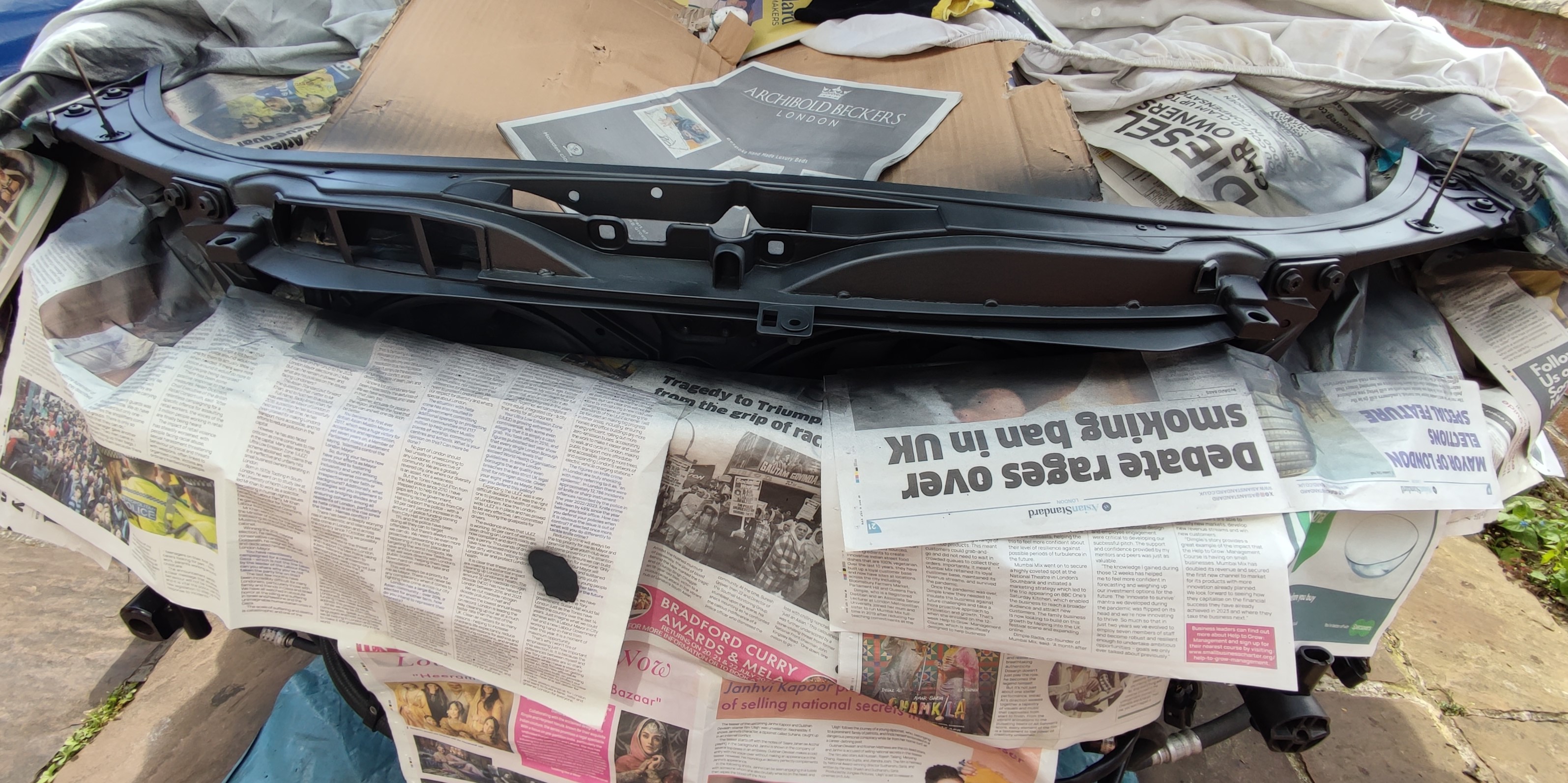

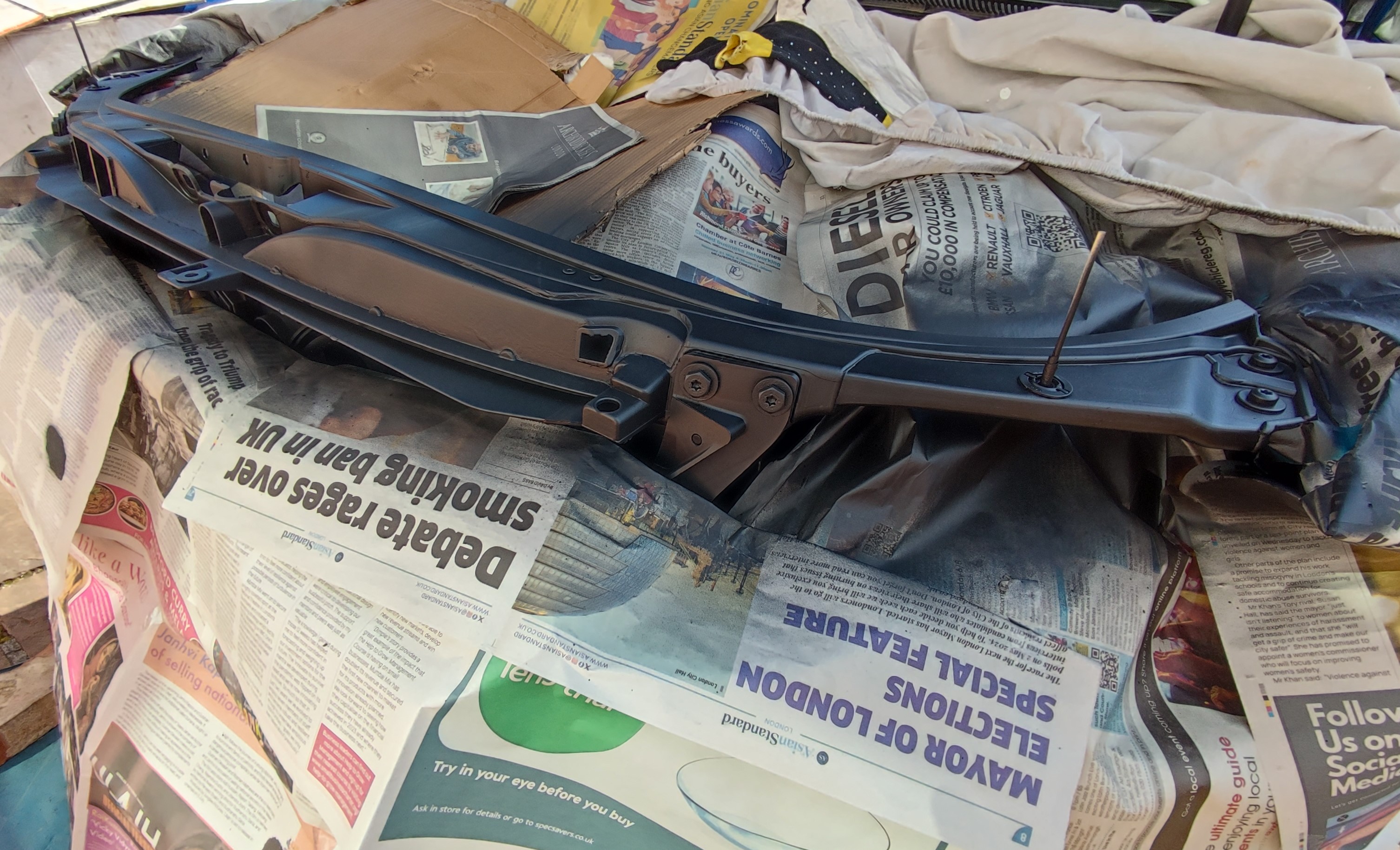

so, just finished tackling the quite common front-end corrosion on the lock carrier / mounting for radiators:
After applying some Hammerite Kurust, it was onto to spraying in Matt Black.. (whilst be careful to prevent any over-spray)

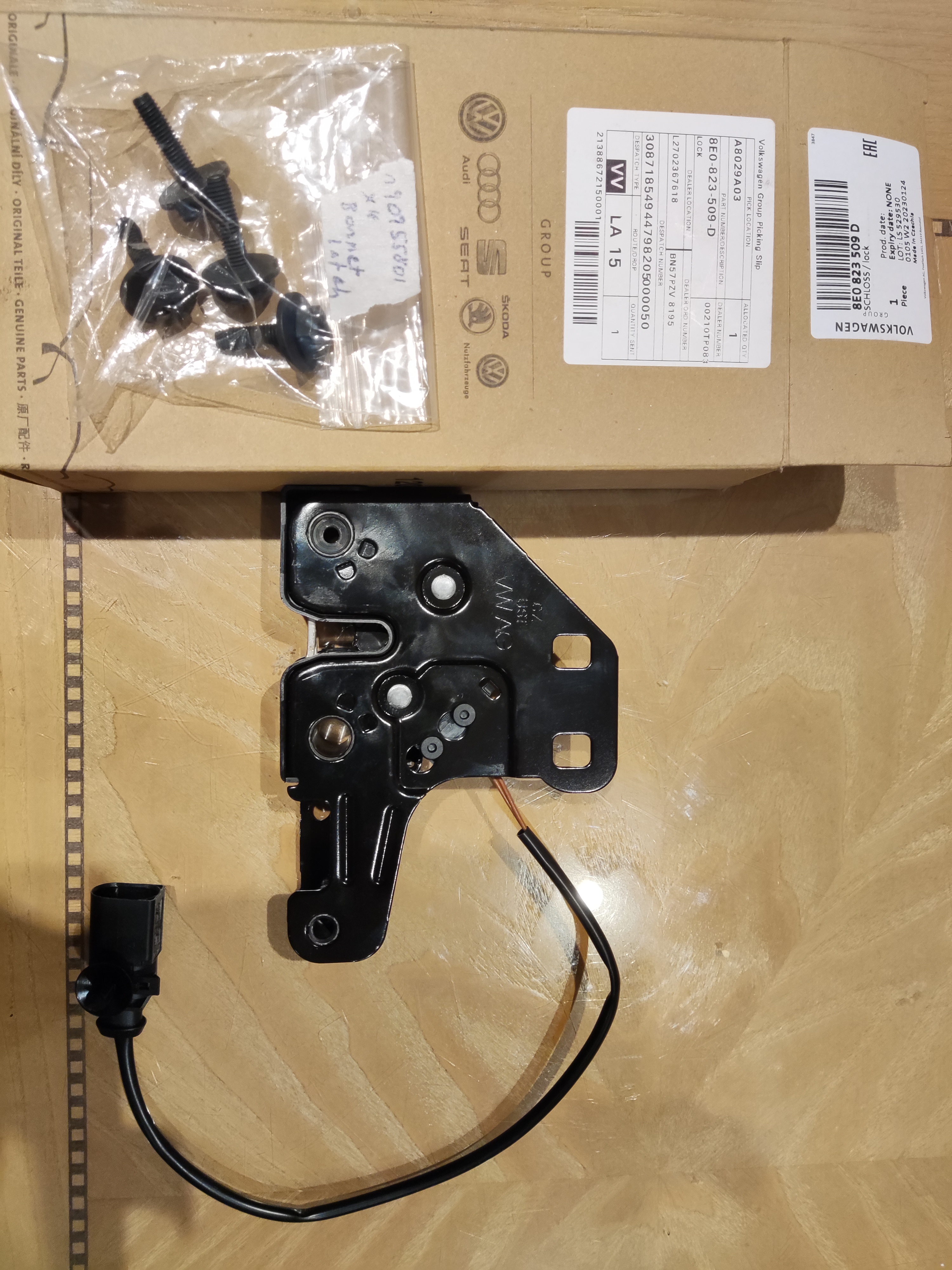

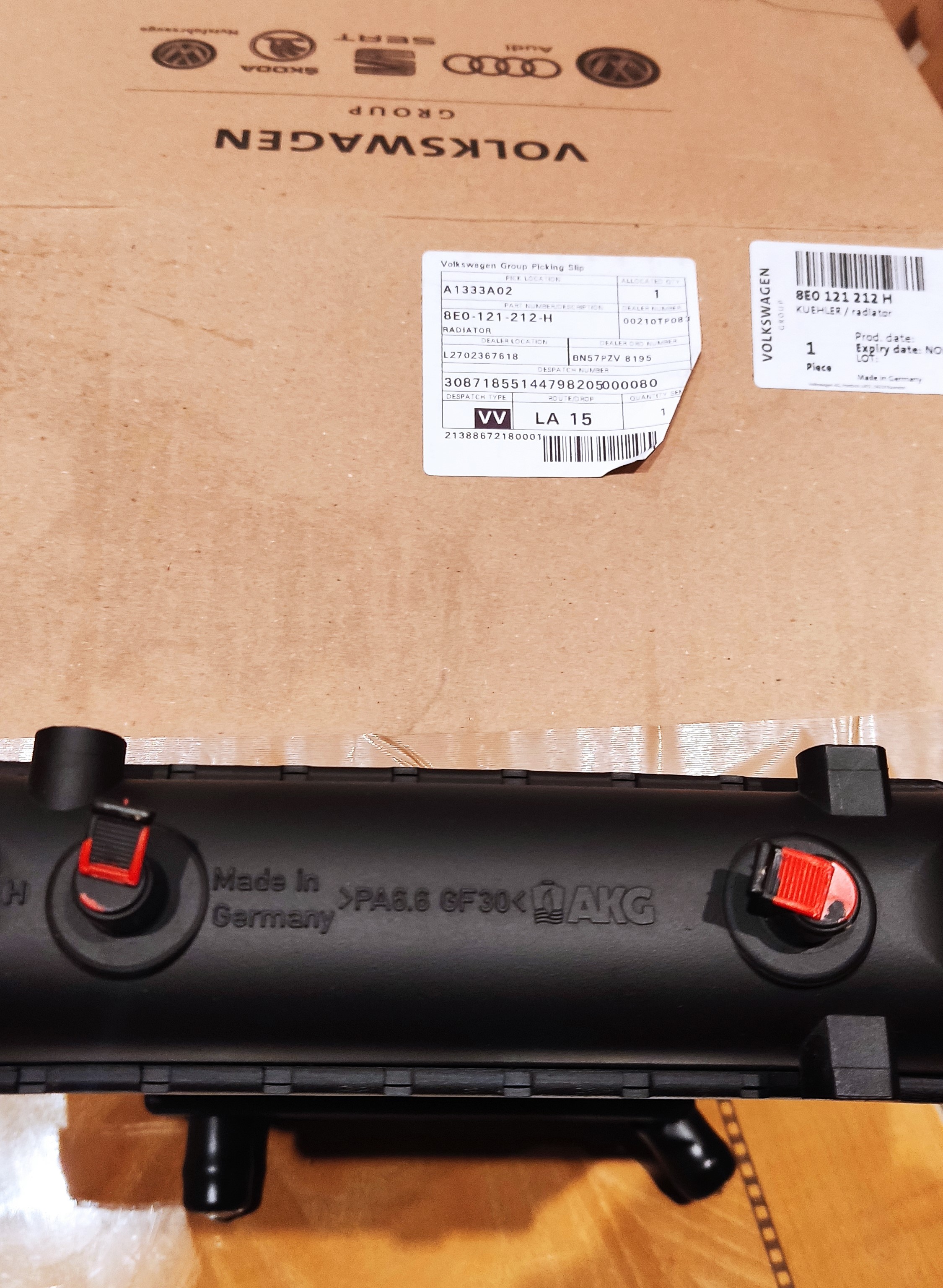

Anyway.. as you may have noticed am fitting a new Bonnet Latch and New Aux Rad:
lugars - glad to hear yours passed the MOT and is back on the road!
Do you (or anyone) have the torque specs for the Bonnet latch bolts and Aux Rad please?

Great work on the lock carrier. Good attention to detail here.
Cheers mate .. gotta say the Makita Filing / Belt Sander came into it's own
