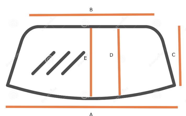

Post by Lander91 » Fri Jun 25, 2021 1:02 am
steve2003rs6 wrote:
Thu Jun 24, 2021 12:04 pm
Lander. Did you manage to obtain the correct screen sizes.
Good timing, indeed I have. The top and bottom integrated seals made things a bit tricky.
Dimensions as follows (approx/best reckoning) in mm:
A 1453
B 1145
C 804
D 893
E 904

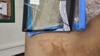

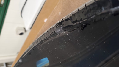

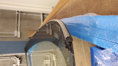

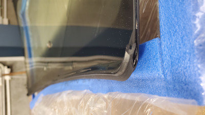

Lander91
Posts: 375
Joined: Sat Oct 03, 2020 8:12 am
Re: Leak
Post by Lander91 » Fri Jun 25, 2021 1:07 am
Reference images.
Steve2003rs6
Posts: 2968
Re: Leak
Post by Steve2003rs6 » Fri Jun 25, 2021 8:06 am
Thanks for that mate.
I had a new screen and plastic water deflector installed a few months ago and I am not happy with it.
I now have 3 stone chips in the screen so another screen is going to be installed.
I want to get it right this time for obvious reasons.
Dimension E and C are the measurements I am particularly interested in.
I wonder is the Rs6 screen is different to the A6 screen.
