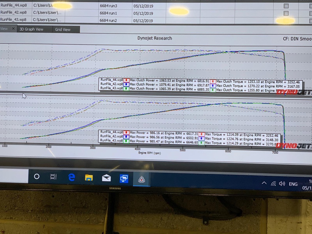

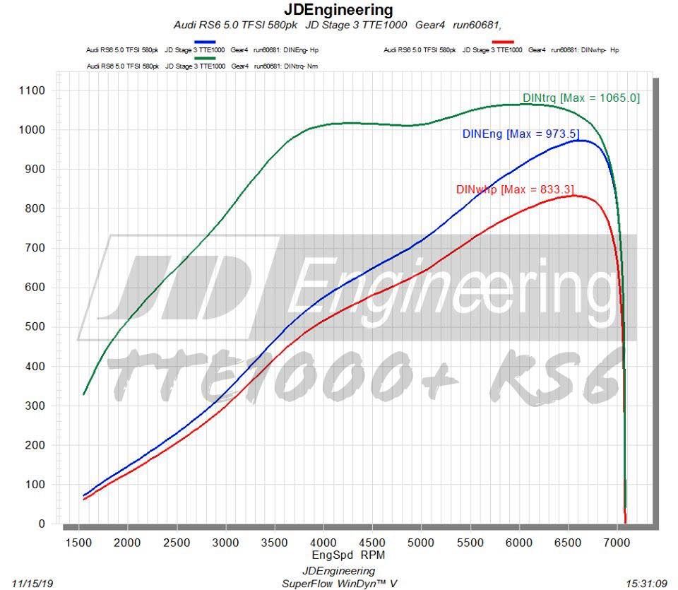

Is that feasible? Well, these tunes got very close to doing exactly that:
So you're saying if a gearbox will take 1050Nm at 4000rpm, will it also manage 1050Nm at 7000rpm? Going by the first example above, yes it will. That car used a stock gearbox.

I've seen that JD Engineering graph before. This is the tune level that i'm looking towards, as long as i can convince myself it will be reliable enough...which i'm still not 100% sure of, hence the reason for this discussion.
Does anyone know more about the car? Ie, is it still running fine with this tune on a stick gb?
