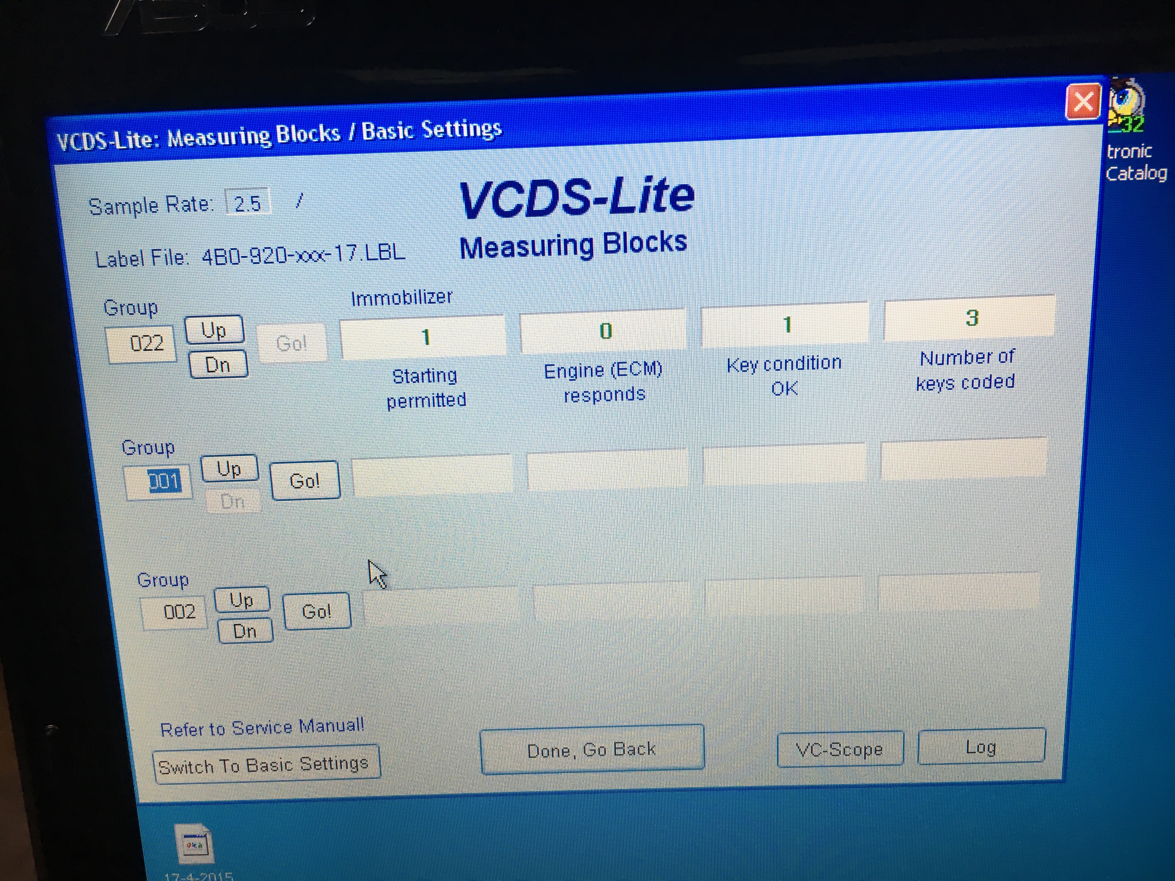

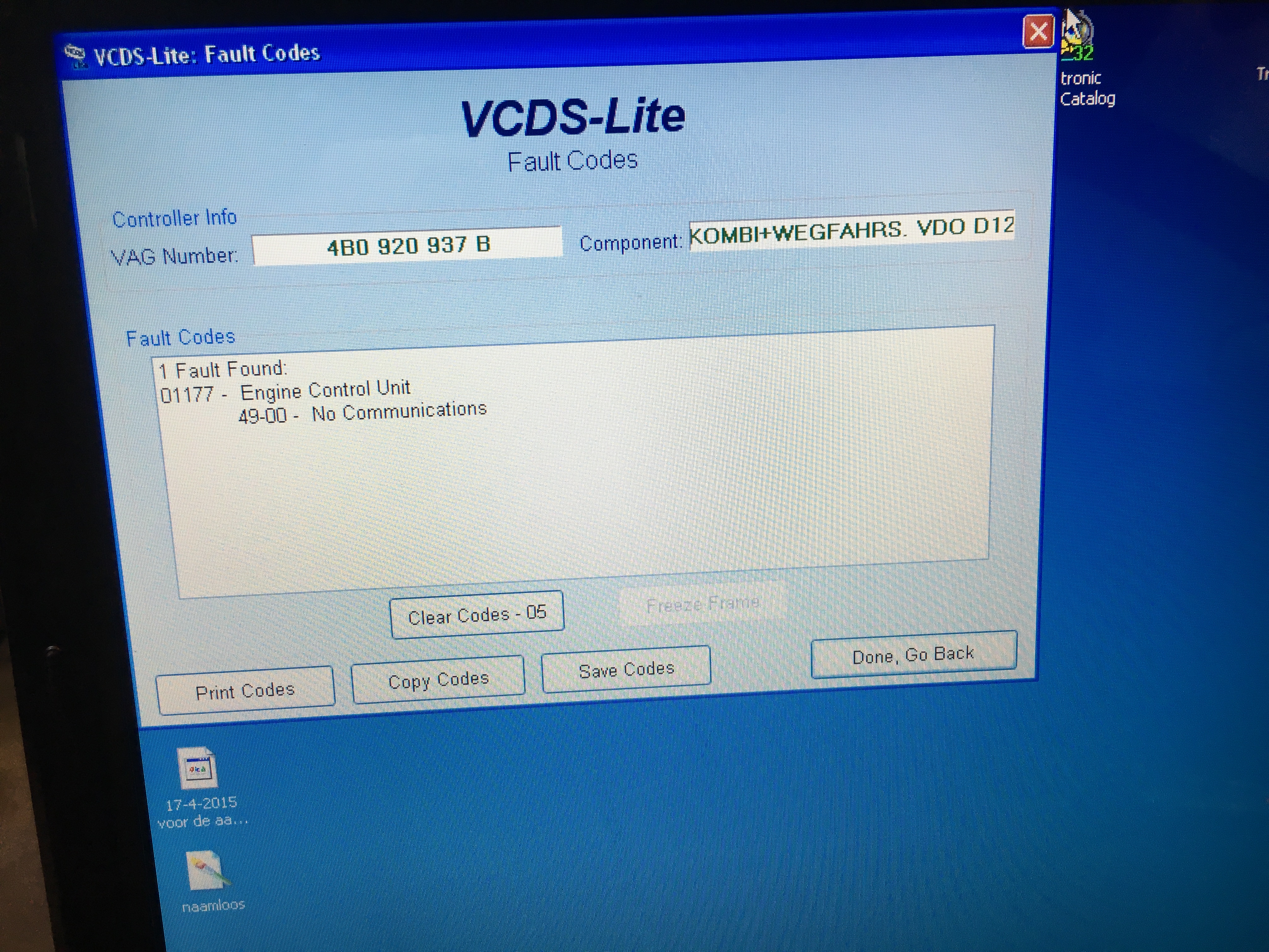

I'm sorry for my late reply I'm a little busy at the moment. But I have checked again with the fuses pulled out and they all get power. No fault codes in the ecu and I have a start rpm.
But the instrument has a fault as you can see in the photo. Also when I look at measure block 22 the engine (ecm) respond has a 0. Could this be the no start issu?
I also asked the guy ho deleted my second lambdas and hy says the 0 is fine and if it was the immobilized the engine would start and shutoff after 2 seconds.
Bud is hy right and is the 0 not a problem?
So I also checked the immo on my 99' Audi A8 and it has a 1 except of a 0! And starts fine.
Someone knows? I also checked the w wire from instruments to ecu and that is fine.

Hmm. It does sound like there's something odd going on.
That fault code is for ECU not adapted. Could it have lost its programming?! Or maybe you get that when it's got no power.
You can't connect to it with the Vagcom, right? It just times out?

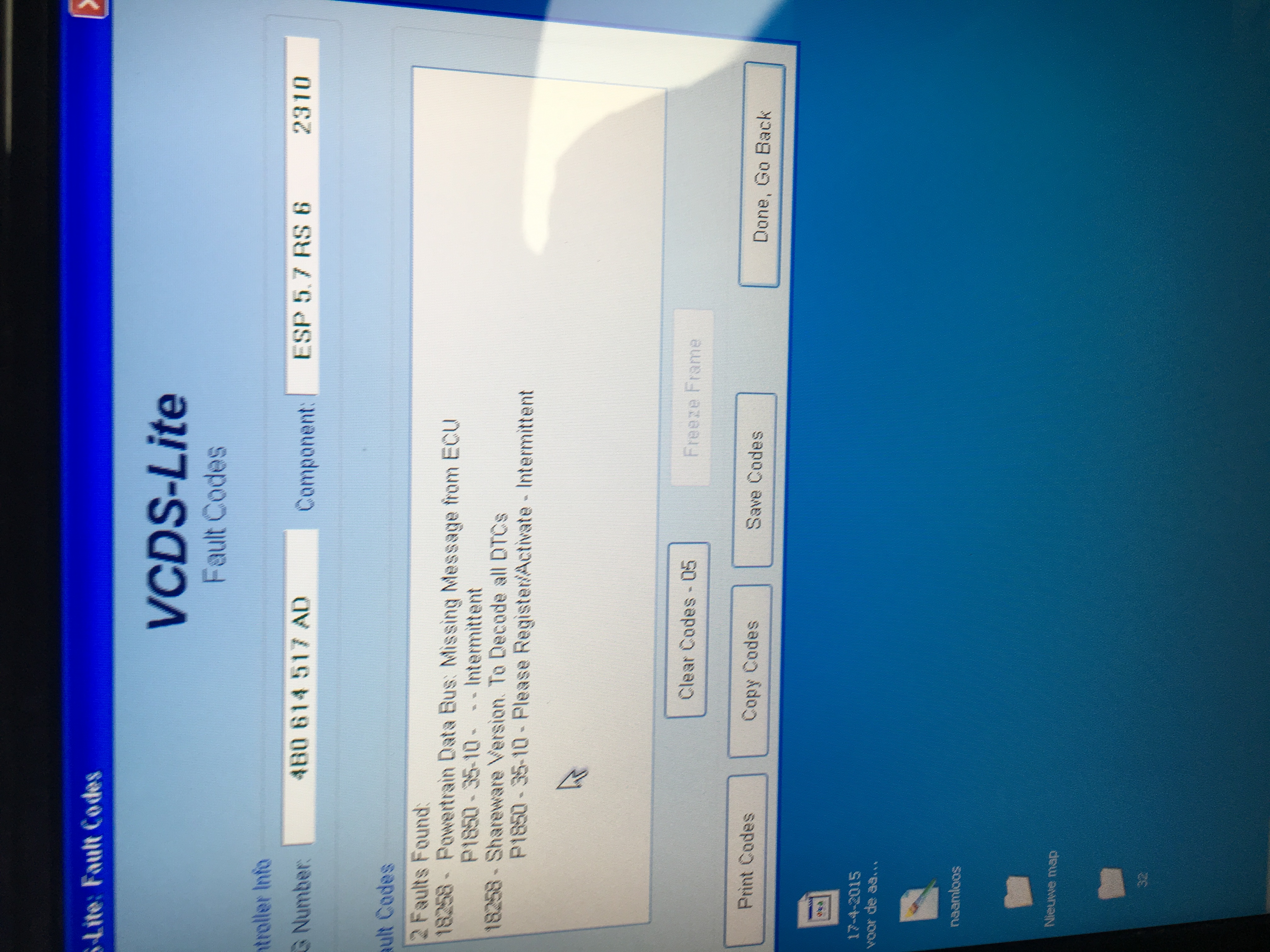

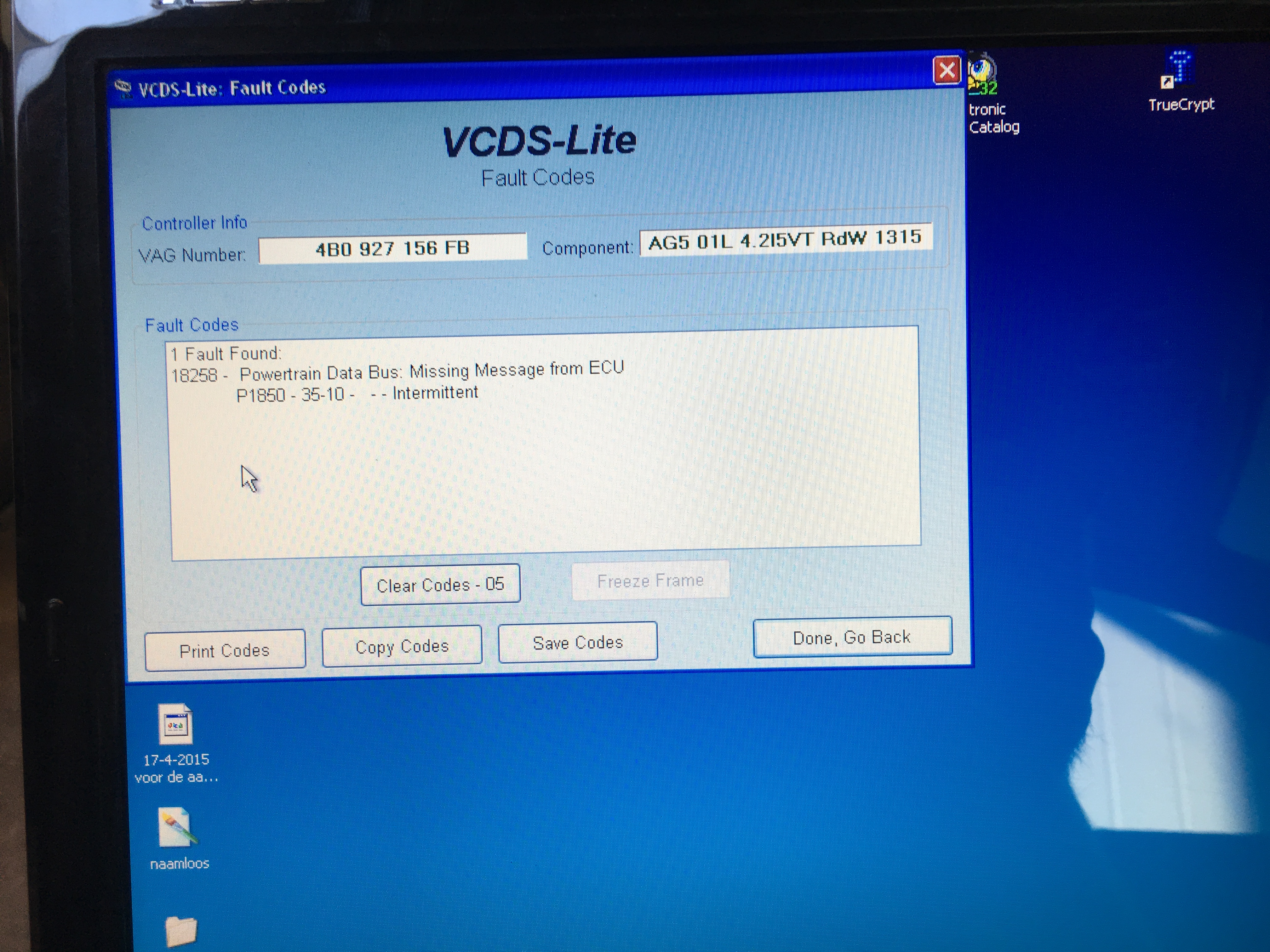

Can you connect to all the other modules?
Maybe there's a can hi problem. What codes are stored in the trans and abs controllers?
:beerchug: thanks mate can't believe I forgot to read the other modules my self :bash:
They also have communication errors. Very interesting I have to look further in to this now! Thanks! I will keep you updated!
