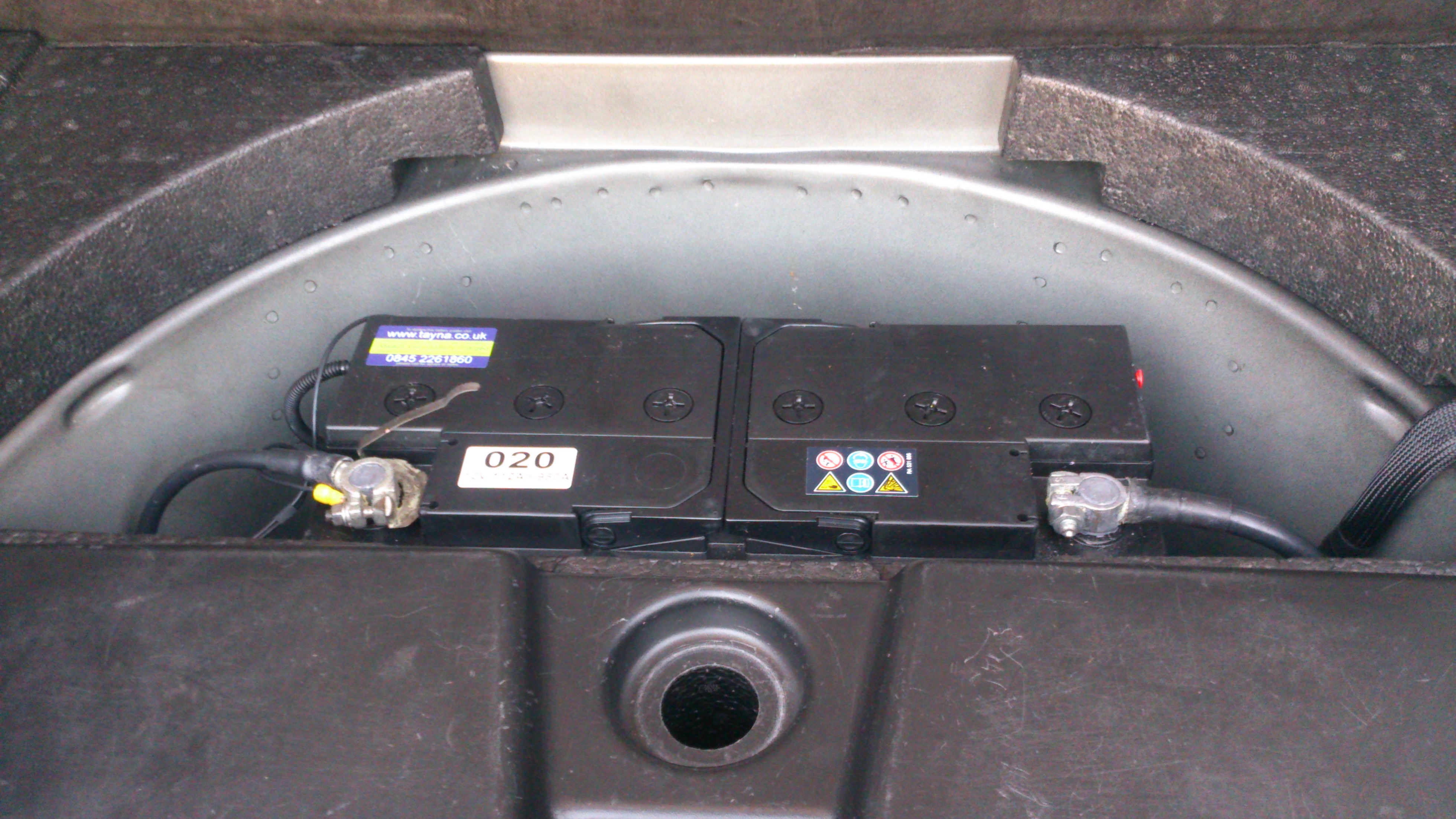

I got one from Tayna batteries. It's an Enduroline battery, they're reasonably priced and work well in my experience. The regulator on my alternator is failing as you know.. it's drained the new battery dead flat at least 20 times and it's been run nearly flat 80+ times now and still has good capacity and starting power. I thought it'd be fubar by now to be honest! Dunno about the length, I just bought the size the website recommended and it was perfect. I'll measure it later if you want.
Edit, Bilko was right, the 020 is the correct size, not 019.

Thanks. :thanks: Although that one looks like it's too small.
I remember now that my battery is too small and it used to thump around in the boot when I was cornering. This was when I had just bought the car and I remember thinking it was the dreaded DRC.
I've noticed all the car parts sites recommend the wrong size battery. Nothing is easy.

L393 W175 H190 this is a 020 type battery but a lot of battery catalogues list an 019 for the RS6 which is smaller and wrong. This is the catalogue I use at work http://batterylookupgb.yuasa.co.uk but it can be wrong as you will see when you look at yours. They list 019 but if you look at trim versions you will see the correct 020 listed.

Bilko's right, it's an 020.
I measured roughly with a ruler, it's 19cm high, 17cm deep and ~400cm wide.
