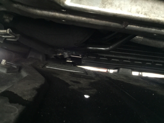

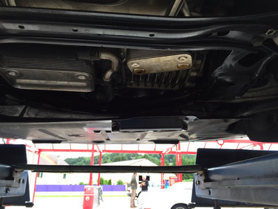

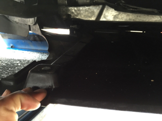

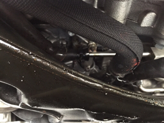

Post by tiago719 » Mon Jun 22, 2015 6:25 pm
Ok so update
I went to a jet wash because I'm not allowed to use their lift to mechanical purpose I was in a bit of a hurry
That being said I couldn't remove all the bottom cover but l loosen it up and I took some pictures
All the oil was in the passenger side and some on the center
I also have some in the drivers side but I think that s from the fact that i spilled 150 ml to engine compartment and it scattered all over with the air flow
Remarks all the oil is on the rear side of the engine gearbox side ,in the front side I don't have a drop
What do you think guys

Post by tiago719 » Wed Jun 24, 2015 7:30 pm
Update
I went to the Audi dealership and they cleaned the engine bay after checking the oil pump and for instance it doesn't leak
