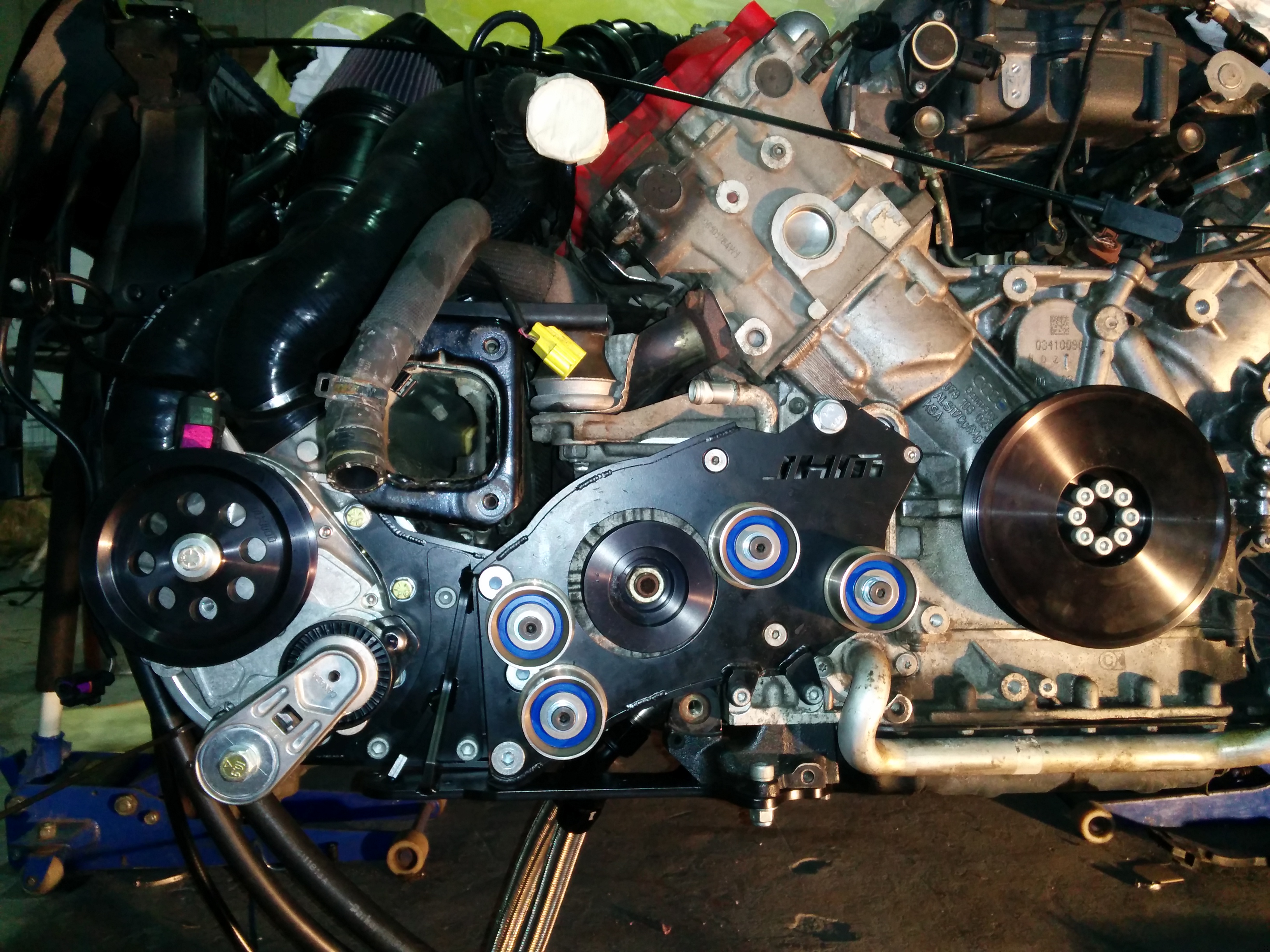

pulley time!.
in the kit you get four idler pulleys a new alternator pulley and jhm's light weight crank pulley.
idler pulleys ready to go on
old crank pulley off, this weighs a ton!. you need to keep the dowel for the jhm pulley
all fitted, idler pulley bolts and crank pulley bolts red locktited.
belt on.

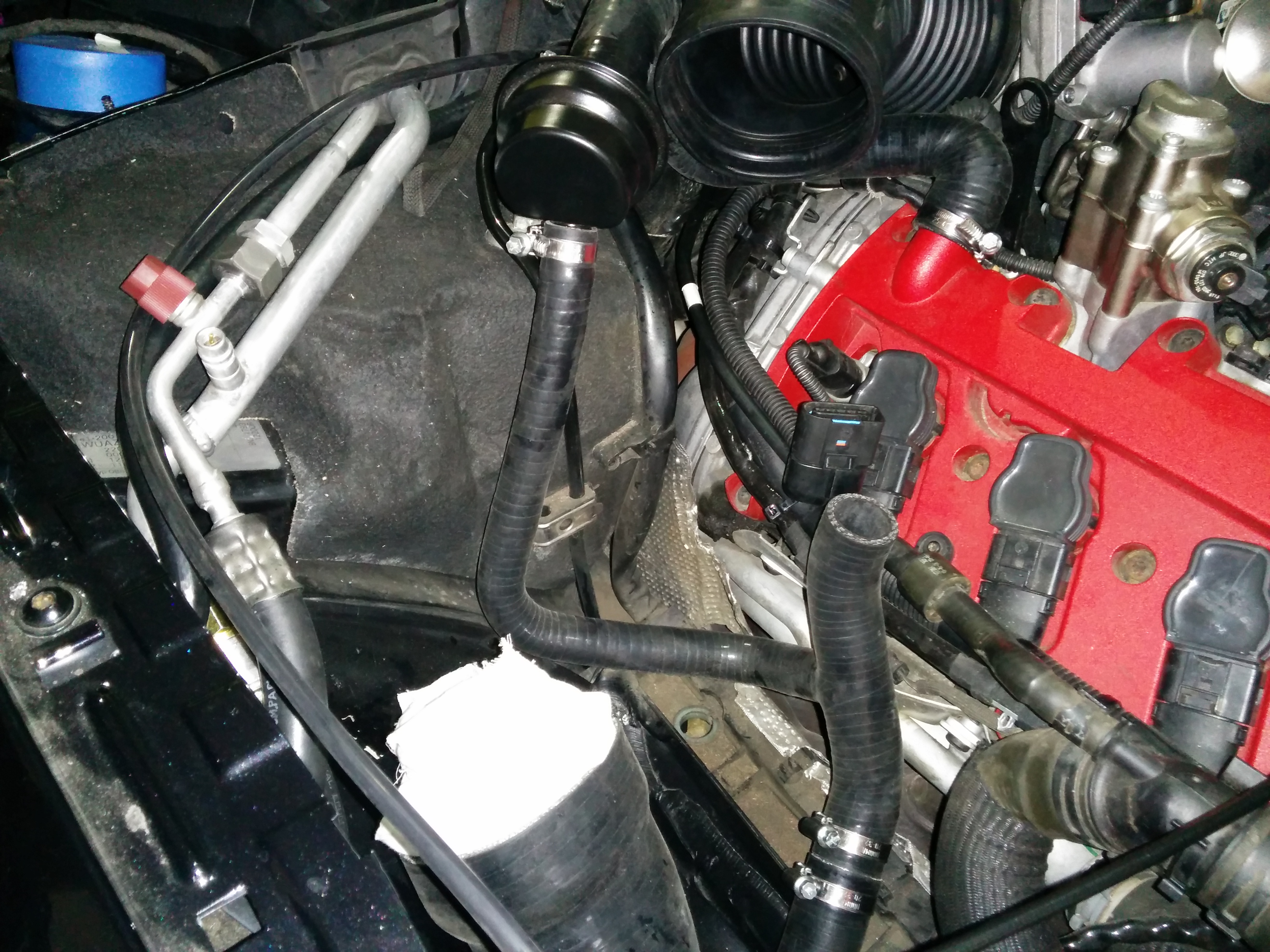

another job done, time to get the intake pipe work on.
here at the bottom of the pic you can see the intake pipe with the bypass pipe work connected to the crank case ventilation pipe work.
the crank case ventilation pipe attaches to the crank case on bank 1 and runs over the engine to the "Y" piece on the oil separator. from there the oem pipe connects to the breather on bank 2.
rest of the intake pipe work fitted, air filter on, maf extension wire in and diverter/bypass valve plumbed into the vacuum feed from under the manifold

i always ran my dv the other way round as then you come on boost it can push the piston up, when its the other way the pressure pushes the side of the piston

surely the intake is just going to be drawing in a lot of hot air in that location?

yip i agree vey hot , but by the look of it theres nowhere else the air can be drawn from , shame the intake cant be repsitioned so the filter sits right in the duct which fed the aux rad that used to be there , that would be the best place exer , right in direct airflow :-)

RS4some wrote:surely the intake is just going to be drawing in a lot of hot air in that location?
Yes, I think the stage 2 is charge cooled or intercooled.
I'm sure jhm have tried it but would the intake not go lower like behind the fog light or is it too tight?

rwilsonrs4 wrote:yip i agree vey hot , but by the look of it theres nowhere else the air can be drawn from , shame the intake cant be repsitioned so the filter sits right in the duct which fed the aux rad that used to be there , that would be the best place exer , right in direct airflow :-)
trust me there is no room anywhere...bonnet scoop? lol.

having looked back through the build could you not reposition the filter by shortening the intake hose and put it under the wheelarch at the corner , even get a 90 or 120 deg elbow
ive had all the crap out of that corner when i installed my PES kit and right enough theres not a lot of room even with the aux rad and SAI off , but yours now has the blower in that area also , so ....
Any lowering of intake temps would certainly benefit a FI system , , something i would look into , certainly as with the depth and complexity of the build your doing with the whole car front apart , and it not having the additional charge cooler that the stg 2 has , it will definately help to try and get that air intake away from there ,
Other places can be good - under the windscreen where the ECU's are would be great as is drawing from the wheel arch. Both are positive pressure areas that can work better than in direct flow.
